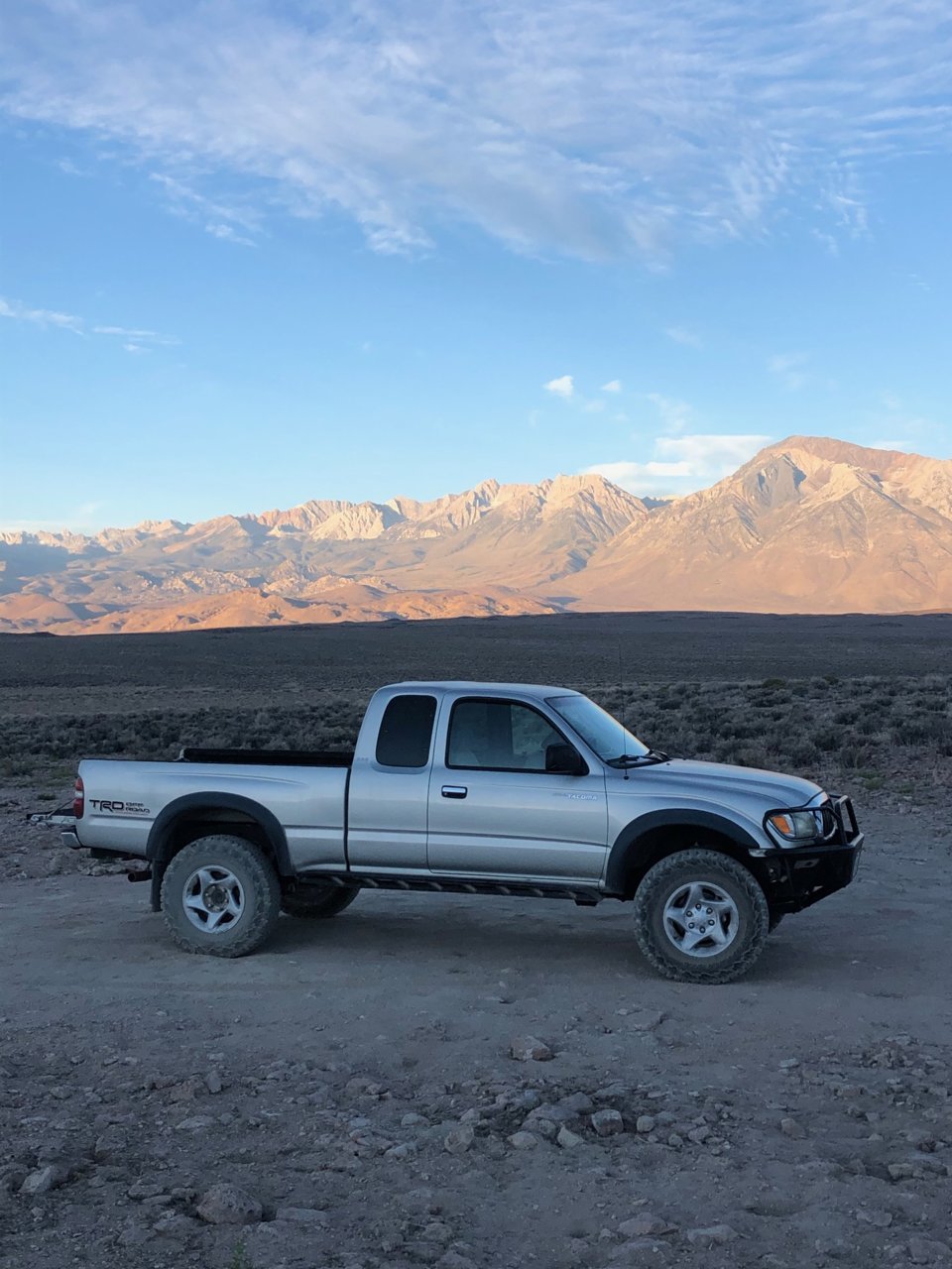

    I bought standard General Springs about 1.5 years ago. They work great without a camper shell on the back. The leaf springs maintain some positive arc, and pop the bed up a little bit. This was from last week:
    I am also running Bilstein 5100s on front and rear, front is on the lowest setting.

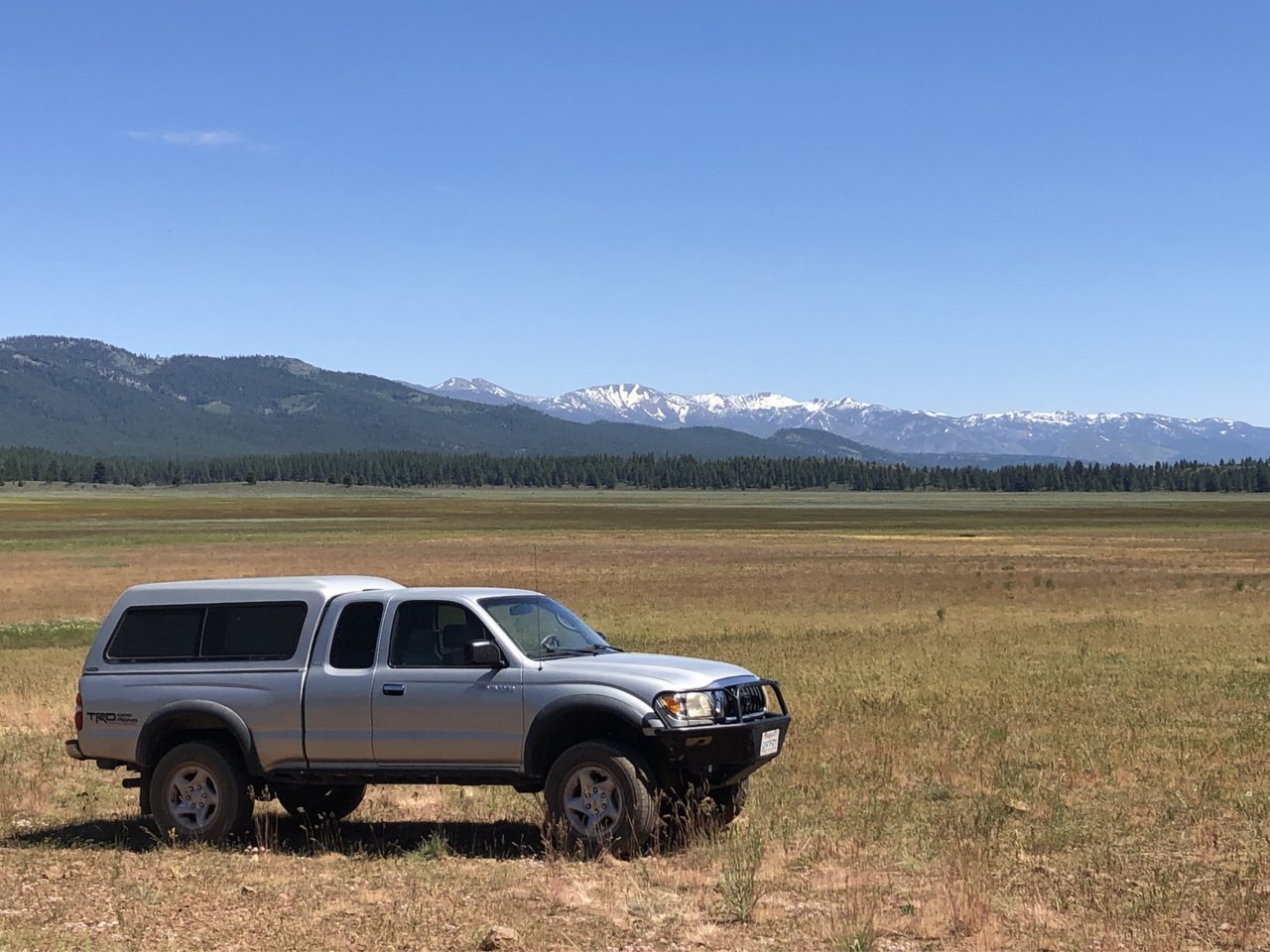

    You can see with my camper shell (~200 lbs) on, that the leaf springs are now flat. I have never bottomed out, and it feels so much safer on mountain roads. The pic below also has the front Bilsteins on the middle setting, which increased the rake quite a bit, so I lowered them down to the lowest setting eventually.
    If I had to do it again, I would've considered the General Leaf HD, but I'm not totally sold. If, over time, the rear starts sagging with weight, I'll just add a leaf. The difference between the original leaf springs and the new General Leaf standard springs is night and day, along with new struts.

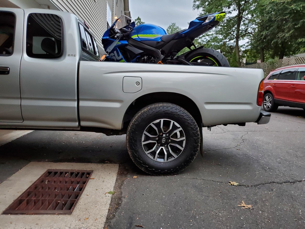

    thank you for posting, kind of what im looking for, have about 450 pounds in my bed with everything plus full tank of gas on both so its loaded down on stock springs, thing stock still does fine i just hate the current level and drive though with new bilstein yellow, dont wanna lift, rides like crap and is depressing to drive due to wrap..

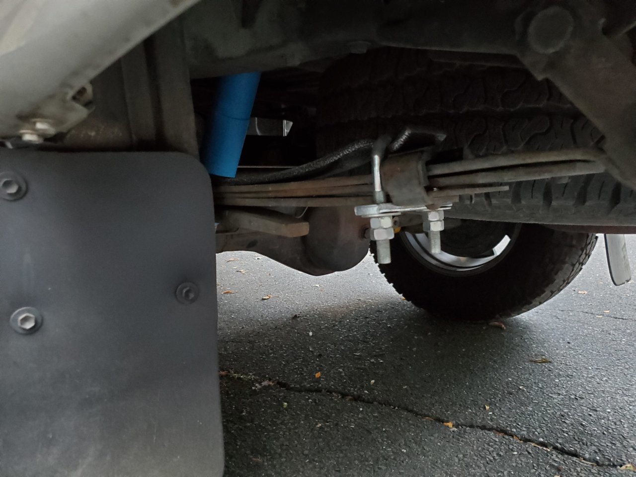

    I have a question, I recently got an 02 Tacoma Prerunner, 4 door, 2wd. I replaced the entire front suspension, and put Bilstein shocks all the way around, and it's lifted 3 inches in the front, and 2 in the back. Now, I'm getting axle wrap, and my leaf springs are perfectly straight, no curve left. The truck sits perfectly level.
    Here's my question, actually two.
    1. Since I just replaced my U bolts when I installed the blocks and shocks, about 3 months ago, do I need to replace them when I replace the leaf springs?
    2. Will new leaf springs, oem replacements, left my truck back up? I'm wondering if it was sagging, and I corrected that by using a lift block that was an inch too tall.
    It is lifted in the front, but with completely worn leaf springs, and the 2 inch blocks, it sitting level.
