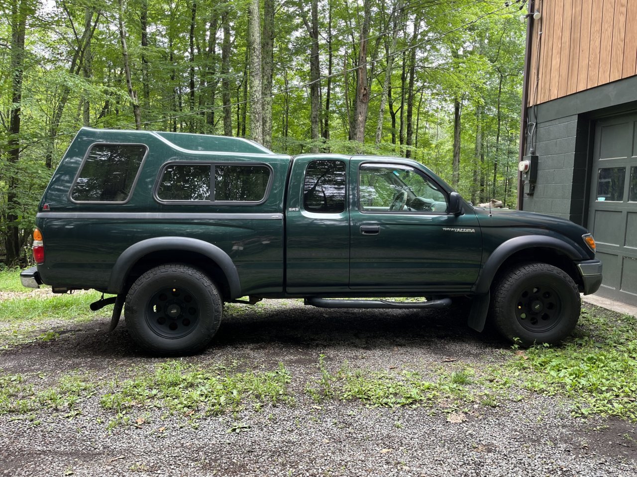

    Very helpful thread here, hoping to revive for a clarifying question. Here's my '03 Prerunner Xtra cab 123k miles, carrying a constant load of about 400+ lbs (leer canopy and a plywood drawer system full of camping equipment). Stock original suspension.
    If I go with General Springs HD leaves, what shocks do I want? I am reading conflicting info between Bilstein 4600 and 5100... I thought 5100 would give it a lift? I don't plan to do anything to the front suspension, as my mechanic said it looked fine up front. I want it to sit level with the load, and obviously handle well.
    Also, would this still be considered oem suspension? All the shops around me say they only do oem. One wants to use Dayton leaves and Monroe OE spectrum shocks, but he'll probably install whatever I want if I supply the parts (and im nervous about being responsbale for makin, but I'm having a hard time understanding exactly what I need. Waiting to hear back from the other about what they want to do.
