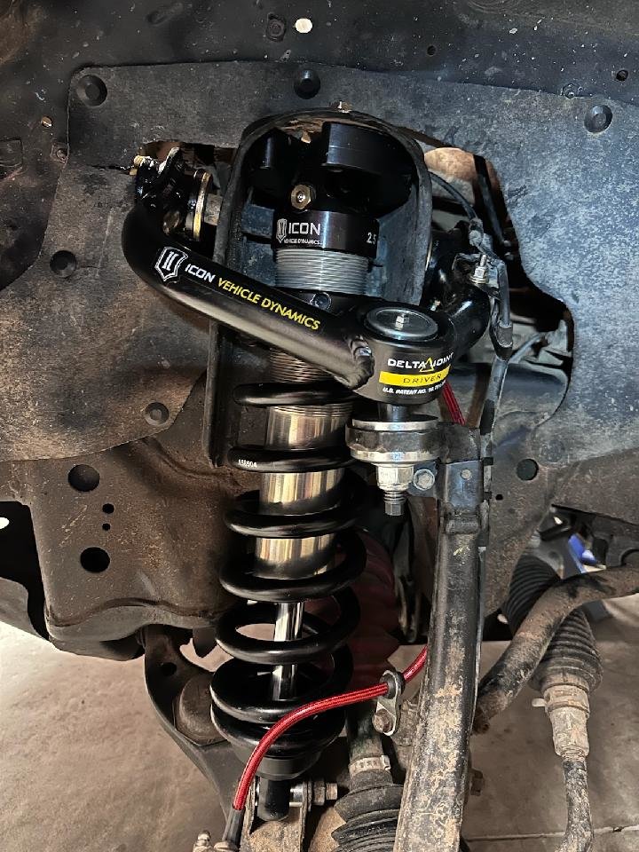

    I've got custom Alcans (probably about equivalent to custom Deavers), and they're 100% worth every penny, despite the tall price.
    I've since replaced the 5100s in the rear with Toytec 2.0s and the 5100s up front with Icon 2.5s

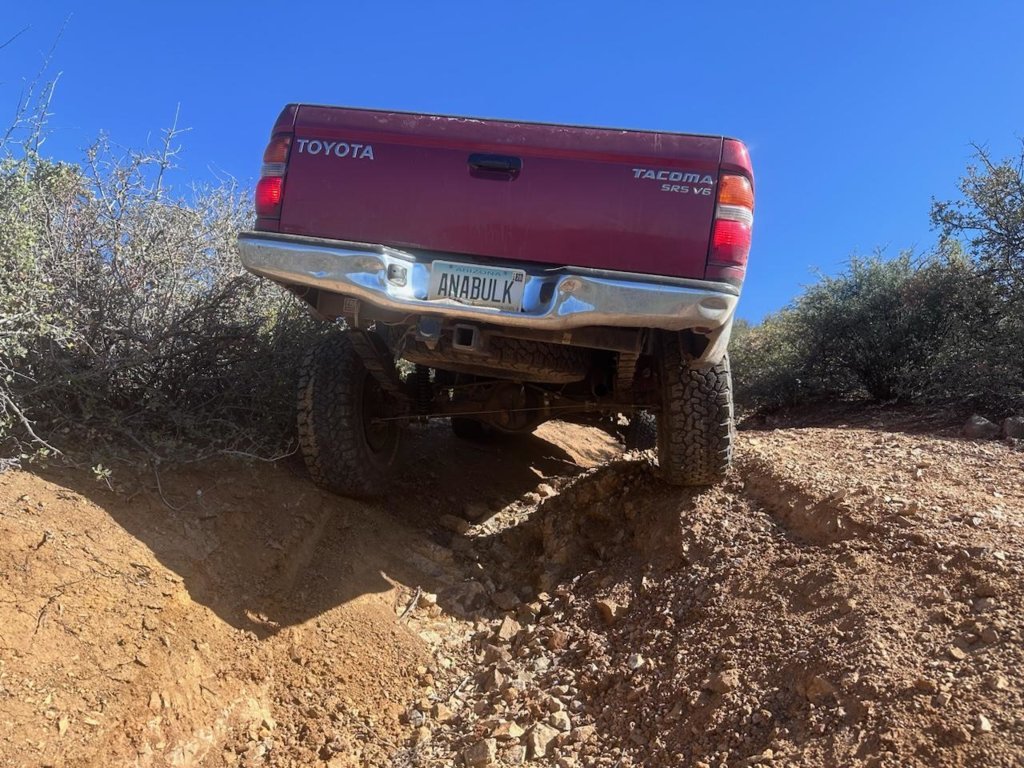

    So I had some weird aftermarket leaf pack that I couldn't identify prior (came on the truck when I bought it used), and i can't remember exactly how much lift it gave me over that.
    My hub to fender measurements are:
    Driver Rear: 24"
    Passenger Rear: 24-1/8"
    When I contacted Alcan I said I wanted the leafs to provide 3" over stock ride height and to have a weight capacity 700lbs over stock. They built the leafs to offer 2" lift and paired it with a 1" bigger shackle for a total of 3". Total cost was right around $1400 with shipping.
    Here you can see i have the Icons dialed down to only about 1.5-2.0" of lift up front, so the truck has some rake and won't be squatting when loaded up heavy with lots of camping gear.

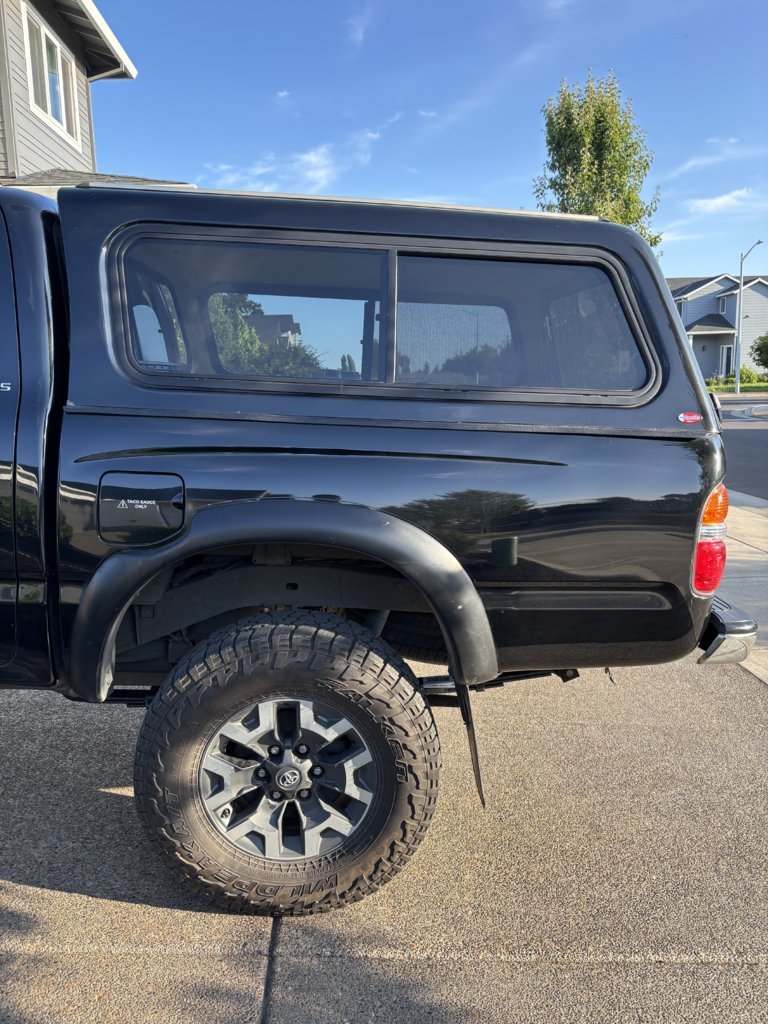

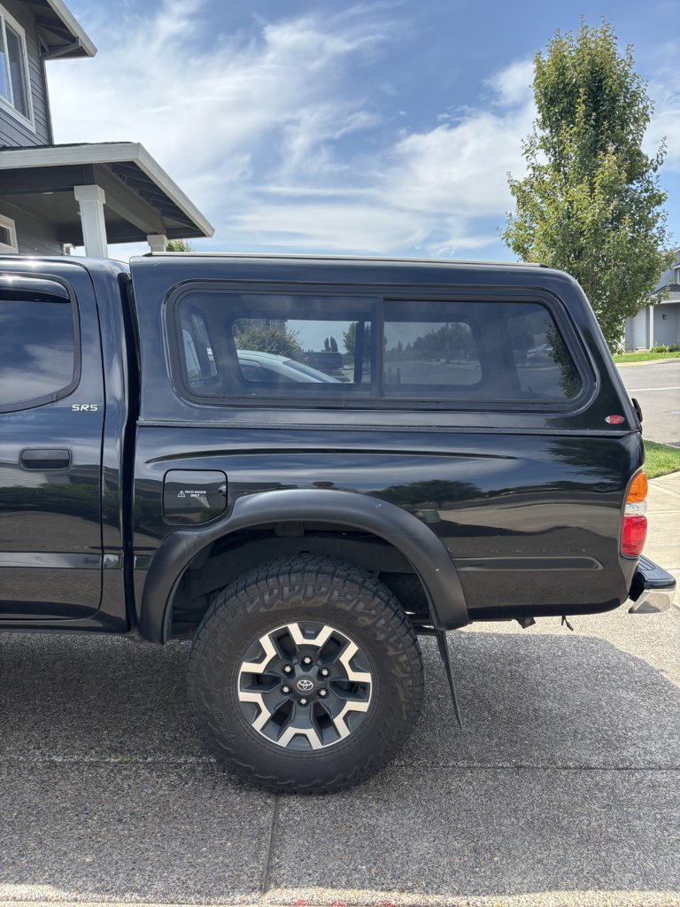

    I recently had the General Spring HD pair installed on my 02 taco PreRunner and I am content with them. Rear sits higher than before as pictured and it’s riding better as well (because the OEM ones had never been replaced). I have bilstein 4600s shocks/struts
