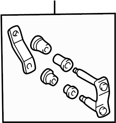

    I considered sliding everything off the top one and replacing the shackle, but the shackle kit 0448304030 is discontinued with no aftermarket options! My 2wd has a bushing on both ends of both bolts, which is how I can tell it's not the same as the 4wd version that is everywhere on Amazon and ebay.

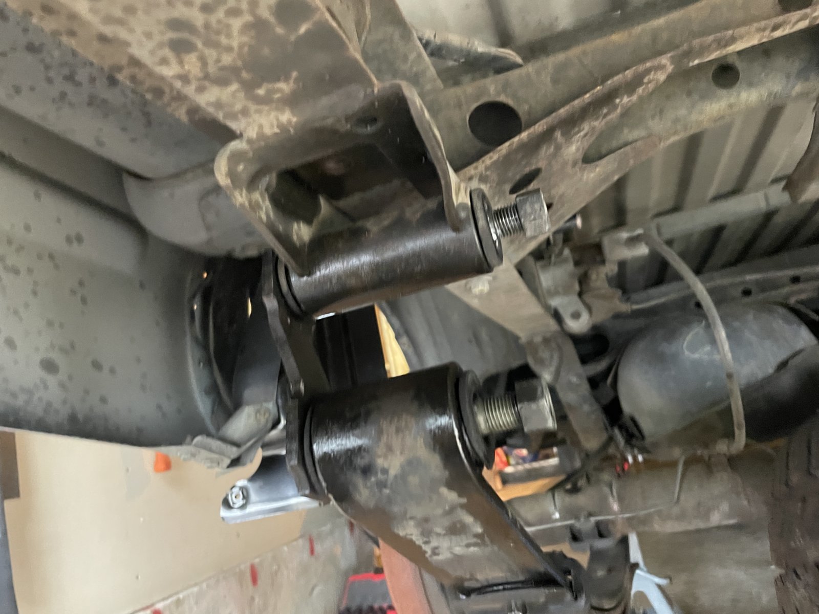

    Can you get us some more pictures OP? Might be helpful for us to see how you have everything supported.
    JustADriver[OP] likes this.

    I will if I can. But I want to wait until I'm ready with another plan and more tools or parts or something before I set it up and do all this over again, and then if I get stuck again I'll take more pics.

    Update - The Dorman leaf spring shackle kit I ordered all matches up perfectly. There are several other brands besides Dorman, and I'm surprised that all of them are wrong when they advertise them as 4wd compatible only. I'm not 100% on it yet until i do the job, but from what I could tell today, every dimension of the shackles, bushings, pins, and threads are right.
    Should I grease the 2 shackle pins and front eyelet bolt on each side, but leave dry the outside surface of the bushings that are pressed into the leaf spring eyes? That's how I understand it, that you only want the bolts/pins to rotate.
