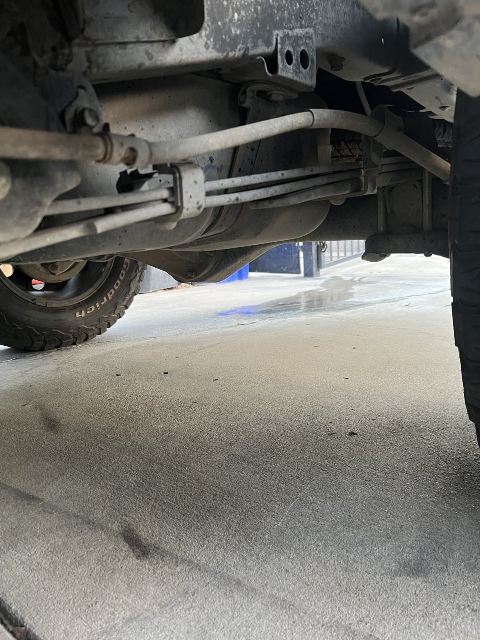

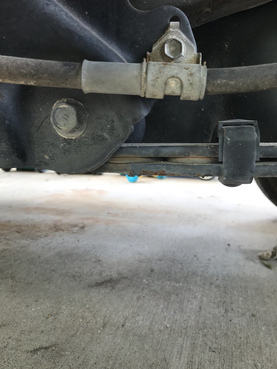

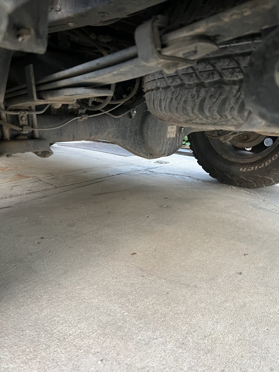

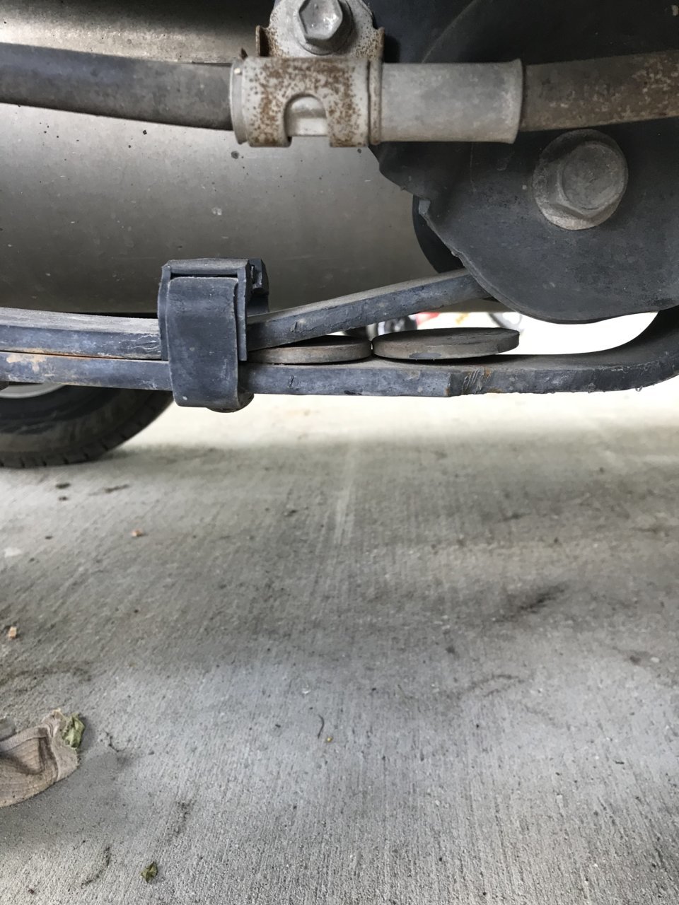

    This is my 2013 Toyota Tacoma single cab I never tow or load anything in my truck but today I loaded the bed with around 1300lbs of grape boxes I got paranoid but forgot what my leaf springs looked before it sagged a lot but the ride wasn’t bad I just drove slow 35 mph how do my leaf springs look ? Shot out ?
