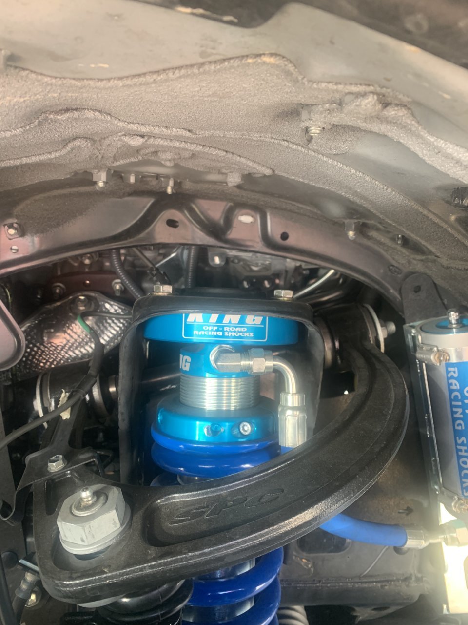

    Its pretty stiff in the front that's why I want to lower preload. When I took it to a shop to get aligned they also mentioned that I was running a lot of preload

    Post a pic of the front. That is nowhere near a lot of preload. The beefier the shocks on these trucks, the stiffer they ride. If you're at only 9 threads showing above the top collar that is very much in the acceptable preload range and should not cause enough loss of downtravel to be uncomfortable - however the valving in the shock is likely significantly stiffer than the Fox setup you removed.
    That's why mine are on their way back to ADS for the second time. The valving in these bigger setups is unnecessarily stiff.
    EDIT: Here's my setup on the driver side with a few extra threads to compensate for taco lean. Looks like I'm at 12-13 - getting somewhere around 1.5-1.75" lift.

    The first pic is driver side 58F2ACC0-D7E5-47FB-9728-201AA1D6A523.jpgD717B7BC-1A86-4C60-BD0C-595425D95E21.jpg

    Preload length is not the length of exposed threads...read the link.
    I promise, it will be very enlightening.
