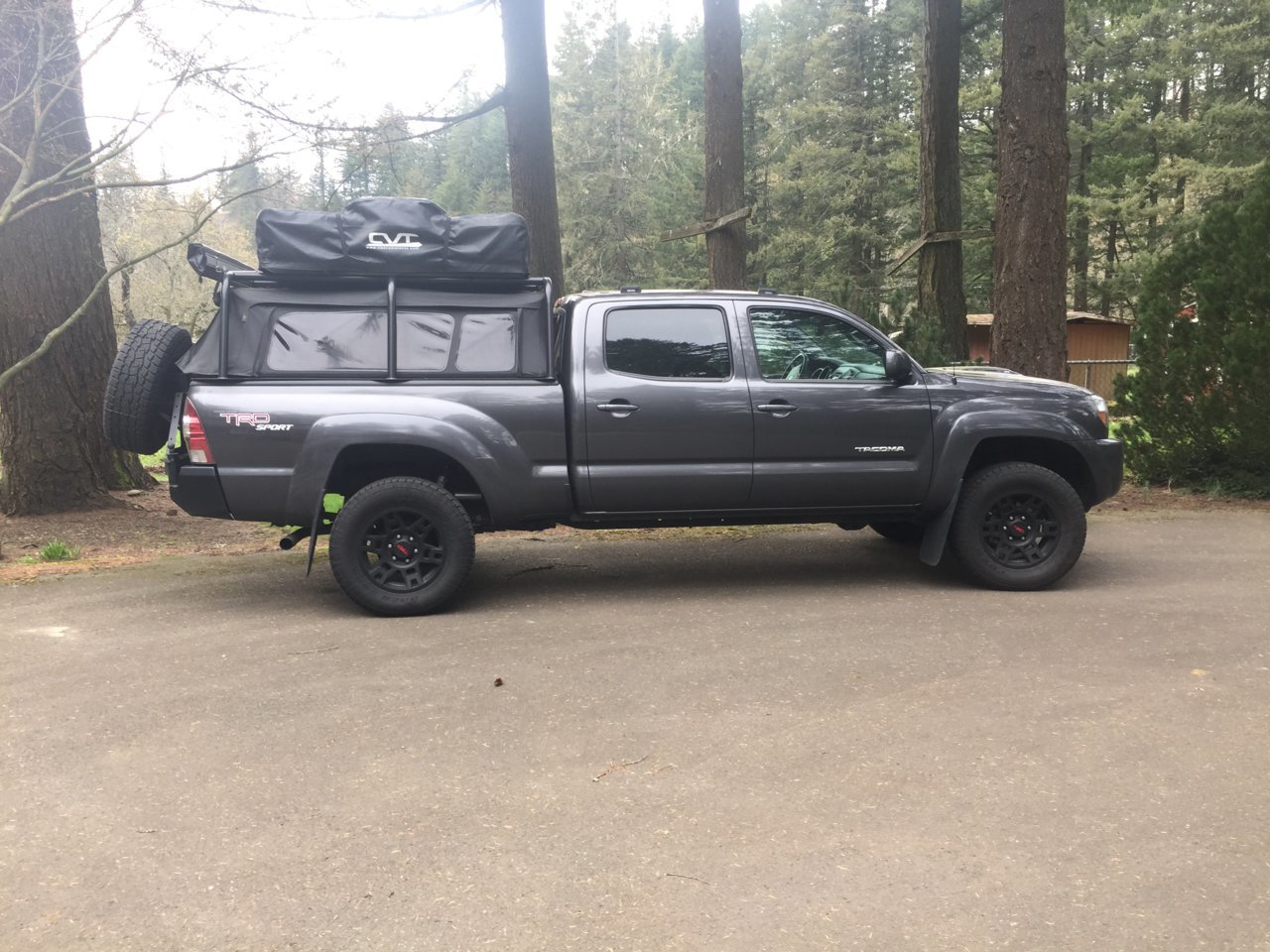

    LostCaliTaco

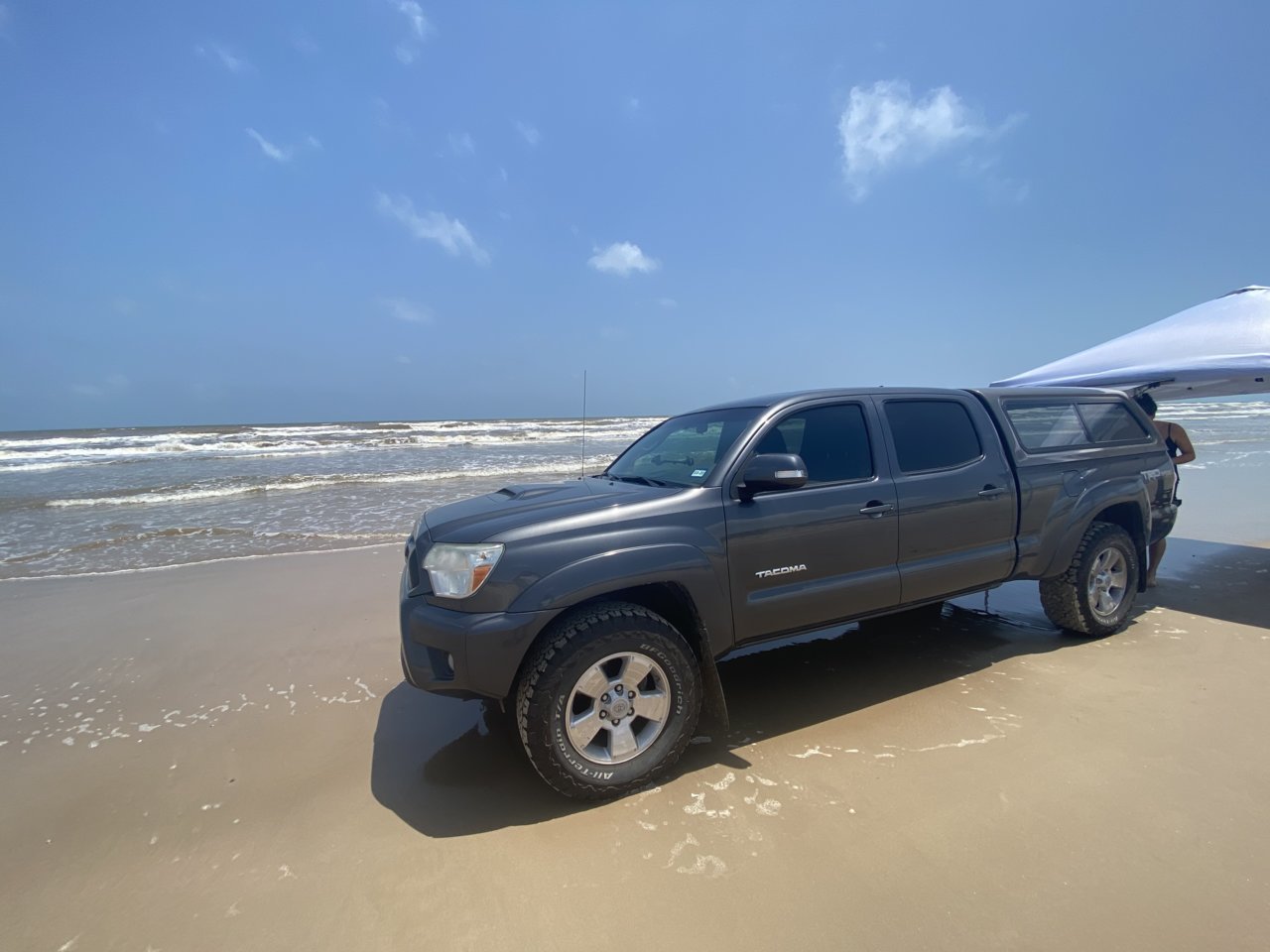

    I have a stock 2014 DCLB Tacoma TRD Sport.
    The leaf springs are sad, as you can imagine. I’ve seen some mentions of a recall on the springs, but don’t know if it’s just for younger models.
    I’m trying to do my upgrades in stages. I’ll be adding a sleeping platform/drawer system that I will build in the next month.
    I’d like to then replace my leaf springs, and eventually replace the rest of the suspension (possible adding air bags).
    Can I replace the leaf springs with a OME set without doing any other suspension upgrades?

  4. Aug 1, 2020 at 10:27 AM
    coylifut
    coylifut Well-Known Member
    Dec 2, 2010
    #47028
    523
    tk
    portland or
    2011 TRD Sport DBC LB
    Weather Techs, Wet Okoles, cbi rear bumper with swingout
    Nice looking truck at a nice looking beach on a nice looking day. You are going to have to give some thought about what you want to do in the front and the rake you want. A Dakar HD pack with your cap and platform will initially result in up to 2.75 of lift in the rear. You can remove a leaf and bring it down a 1/2 inch or one of the overload leafs and bring it down an 1 inch. I've found that all packs sag a bit after time and use. I would expect a Dakar pack with a leaf removed to settle at around 2 inches of lift over time. You can add airbags later if you start towing a travel trailer or a boat and your new pack doesn't support the load the way you prefer.

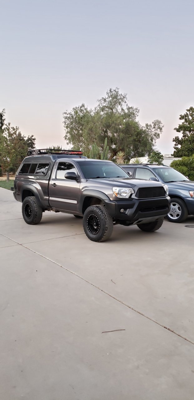

  8. Aug 1, 2020 at 11:38 AM
    MightyQ
    MightyQ Well-Known Member
    Aug 10, 2018
    #262311
    56
    2012 Reg Cab 4x4
    I have the 5100's in the rear a 1.5aal and hellwigs ez-helper 990 I have a full drawer system camper shell cargo basket and tons of gear in the bed at all times, works great.

  9. Aug 1, 2020 at 11:49 AM
    BlkDakDave
    BlkDakDave Well-Known Member
    Oct 20, 2012
    #89422
    1,120
    David
    CC TX
    07 AC PreRunner TRD/Off Road
    If you replace with OEM, most likely they'll flatten out after a while. I had the leaf springs replaced on my truck (07) with the recall. With a Leer Cap (300lbs) and hauling a dirt bike on a hitch carrier or dirt bikes on a trailer it wasn't long before I noticed my truck sagging a bit more. Even with a Roadmaster Active Suspension system (RAS) those new OEM leaf springs were settling a little more that I wanted I then added Sumo Springs and along with the RAS my truck seems to handles weight with the bed loaded while hauling dirt bikes with a lot less sag.
    There was a recent thread where Deaver leaf springs were mentioned. I checked them out and they different leaf packs with different capacities. I liked that you can get a set that works for your truck and stay in budget.
    Looks like you're on a beach on the Gulf of Mexico. Some friendly advice. Be careful parking along the water's edge on an incoming tide. I've seen many a vehicle including RV's get stuck when their tires sink or get sucked into the wet sand. Just a couple of inches can cause a problem. It's hard to go forward or backwards so rocking the vehicle is impossible.
    Good luck with your search.

  11. Aug 1, 2020 at 12:43 PM
    MightyQ
    Aug 10, 2018
    #262311
    56
    2012 Reg Cab 4x4
    Thank you, yeah put a lot of work in to maintain the clean look as well as improve and or maintain ability. The ez-helper was a great option as it maintains spring rate and keeps the truck riding as comfortable as stock with improved load rating!
