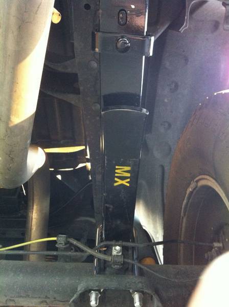

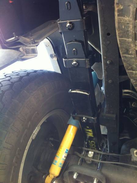

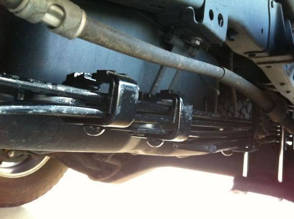

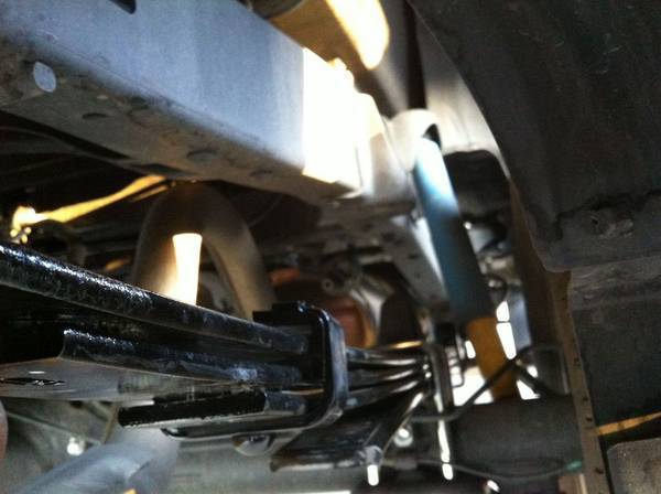

    I got 4 leafs on each. but they both look different. do you see the passengers side doesnt have the square metal brackets. Please see images below:
    Drivers side
    Passengers side
    [​IMG][​IMG]
    Drivers side view
    Passenger side view
    [​IMG][​IMG]
  5. May 30, 2012 at 2:53 PM
    dexterdog
    dexterdog My pee parts itch
    Jul 12, 2009
    #19571
    4,917
    Oly WA
    2012 F150
    4 leafs are 4 leafs. You're not paying for them are you?

    No I am not paying anything. They say all is done under the tsb. but I am uncomfortable with them looking different.

    Looks won't affect the performance and if you haul with any regularity performance won't matter either as the 4 leaf packs will fail as well.

    I have both of the "new" 4 leafs on mine and they look just as flat as yours (driver side). Not sure if your truck is on level ground in the pics, but the "old" 4 leaf (passenger side) looks like it is doing it's job better. I'm not too happy with the new springs, but don't think there's much I can do through the dealer.

    Had it in hand at the dealership and was told that the new 4 leaf springs were 48220-35020 and 48210-35A20. Did a search here and found several guys that had the same springs put as well. Now I'm just confused. And call me crazy, but leaf springs shouldn't be sitting flat, right? (see op's driver side pic)

    Usually the added leaf is rather flat. Not snug to the other springs. It is an extremely stiff spring that aids in support once the other leafs start to flex too much.
