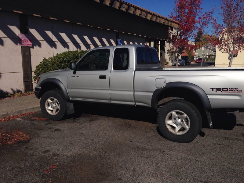

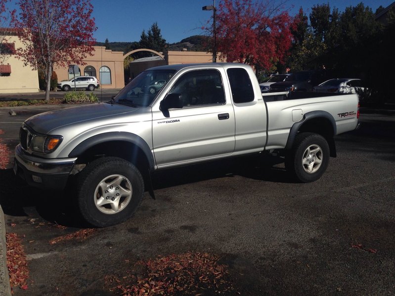

  12. Nov 16, 2015 at 1:04 PM
    #32
    Baby
    Baby [OP] Well-Known Member
    Nov 23, 2009
    #26409
    91
    Northern, CA
    03 Tacoma 3.4
    Here are a couple quick pics from the phone. Sorry about the lack of effort in making it look good. I went with the 881s and I installed the full Dakar leaf pack. Dan at Wheelers suggested I might remove a leaf to level it out more, but I like a bit of rake. I expect the whole thing to settle 1/2 inch or so over the next couple weeks.
    I don't have much to say that hasn't already been said. Installation was super easy. Extraction of the stock stuff was a different story. I racked up a huge Advil bill. Wheelers was great to deal with. They answered my many questions and were open to possibilities rather than to just pushing something on me. I have just a little bit more noise from the drive train, but nothing too bad; and I suspect some of that may go away once the suspension settles. I'm not sure yet about the need for bigger wheels. Maybe...

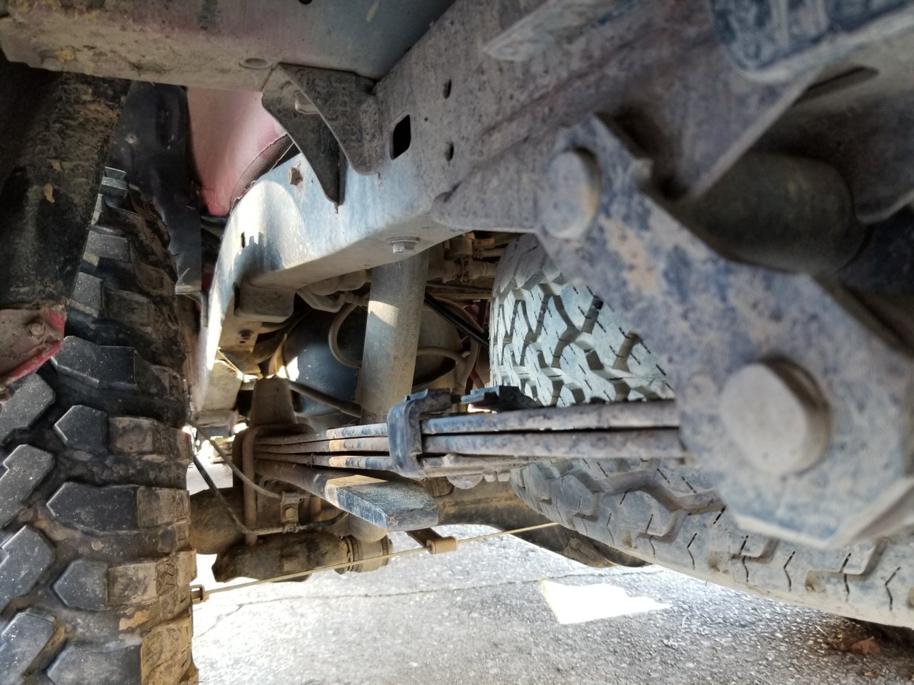

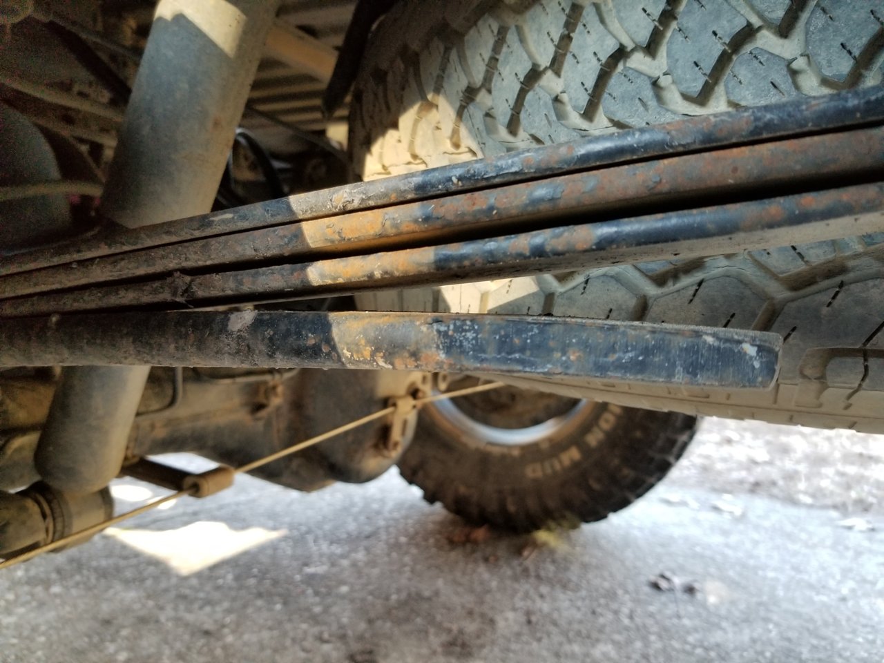

  17. Dec 30, 2019 at 1:26 PM
    #37
    Tikibutt
    Tikibutt Well-Known Member
    Feb 20, 2019
    #283843
    140
    Rich
    Knoxville, TN
    2004 Tacoma 4x4
    JBA UCAs, Radflo Coilovers, Lockrite mechanical Locker, All-Pro Offroad Skid Plates, 4x Innovations Sliders, Dakar Rear Springs, 37x13.50r17 Cooper SST Pro on Beadlocks
    Well, I'm back. Just a curiosity question. Should my bottom leaf look like it's arched the wrong way, and I'm not sure if this is the right angle for my shackles.
  18. Dec 30, 2019 at 1:47 PM
    #38
    Kwikvette
    Feb 27, 2019
    #284735
    82,164
    Fresno County
    4 run, 2 don't
    The bottom leaf (overload) looking like a frowny face is normal; when you apply weight to the truck, the leaf pack flattens out. At the same time, the overload leaf counteracts that flex to support heavier payloads.
