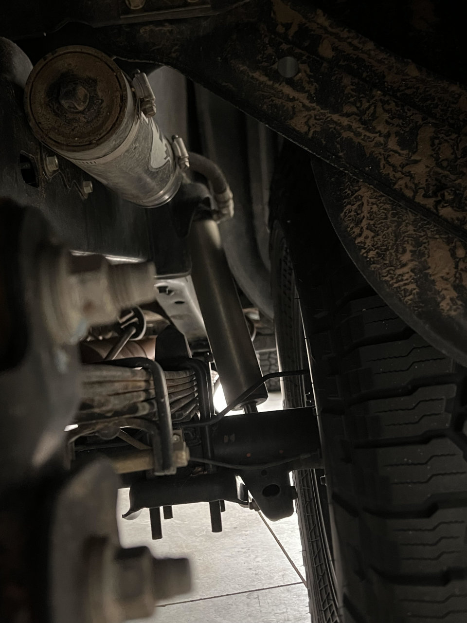

    I have the Icon RXT Leaf pack w/ add in leaf. I recently got service done on my truck and they mentioned my leaf springs look like they are "doubling under". I can't find too much on this online and am not 100% on what constitutes this. Wondering if anyone else has any more info on it. I have a RTT and Bed rack on it. Got it installed about 25k or ago about a year and a half ago. Pictures were awkward to sneak in and get, apologies for that.
    Am I good to keep wheeling on it or do I need to wait to try to get new ones put in? Still learning things and any help/advice would be appreciated!

    You been getting any air …..

    When I lived in SOCal would hit whoops in the desert. Other than that not launching my rig to be with Elon in space or anything of the sorts

    They look beat up, that sucks how little life you got out of them.
    The shock even looks like it's not getting full stride.
    Does it look low in the rear?

    Yeah it does look low in the rear. The shop I went to said its probably about an inch or so lower than the front

    I have an older 1st gen, and w/a new OME leaf pack with the AAL it looks more sagged than you pic. I don't know the relative nature between the old and new.

    What stage on the RXT are you running with the RTT? It may be too much weight for whatever stage you're running and need to bump up. Did you add the tent after you upgraded the leaf pack?
