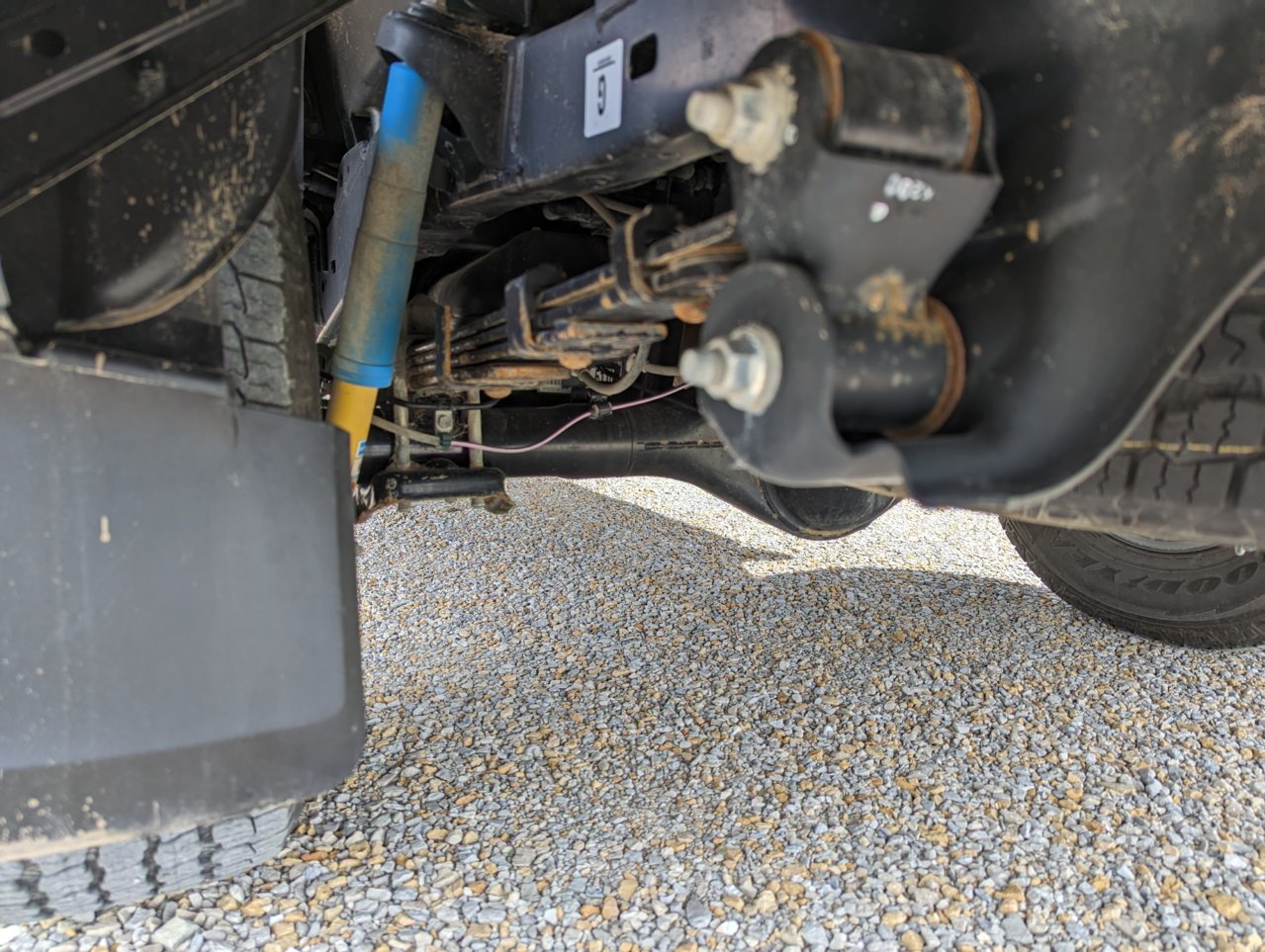

    So for the spring still look flat while the truck is on the ground? Is pretty much normal or do I need to take it in, the truck is not sagging nor has a very large rake the rear , if you step back it looks pretty much level from front to back

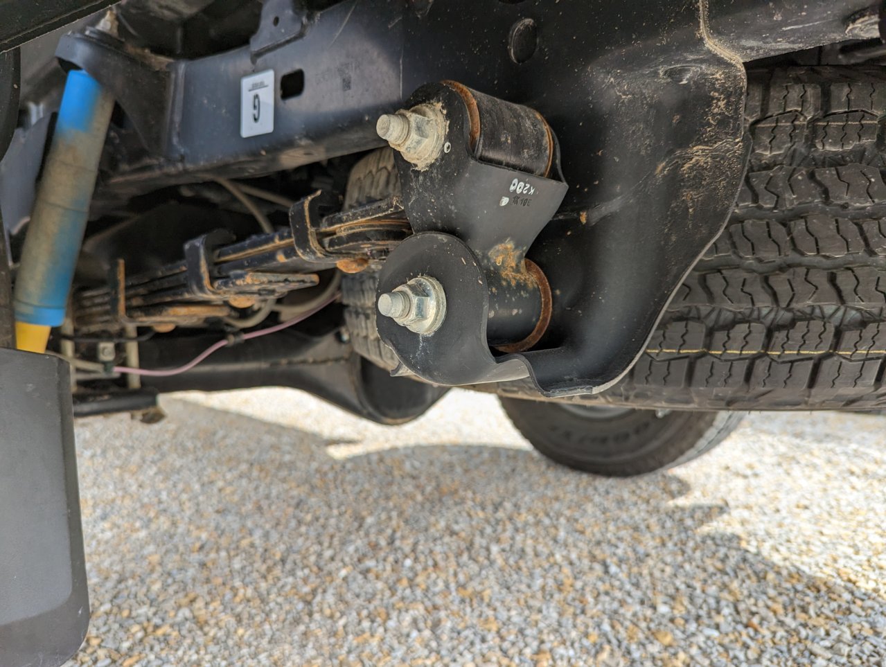

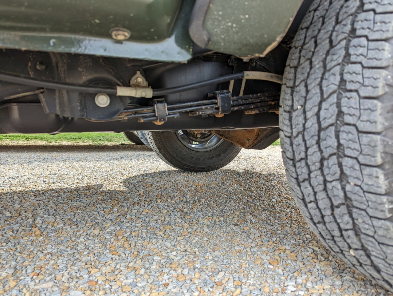

    Could you take some photos so I could compare them with how they look on my truck cuz on my truck they're flat and towards the front it looks like they're bent down a little bit due to the way the bracket is

    PXL_20230415_193949714.jpg PXL_20230415_193949714.jpg PXL_20230415_194026465.jpg PXL_20230415_193949714.jpg PXL_20230415_194026465.jpg PXL_20230415_194145278.jpg PXL_20230415_193949714.jpg PXL_20230415_194026465.jpg PXL_20230415_194145278.jpg

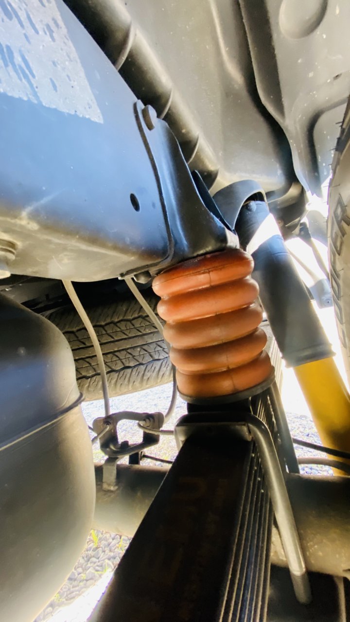

    Alu-Cab Canopy Alu-Cab 3.1 RTT OME HD SPC UCAs Reframed 2021
    Thank you for assuaging a concern I didn't realize I had until I got on here. OME HD + Sumosprings is the sweet spot for me.

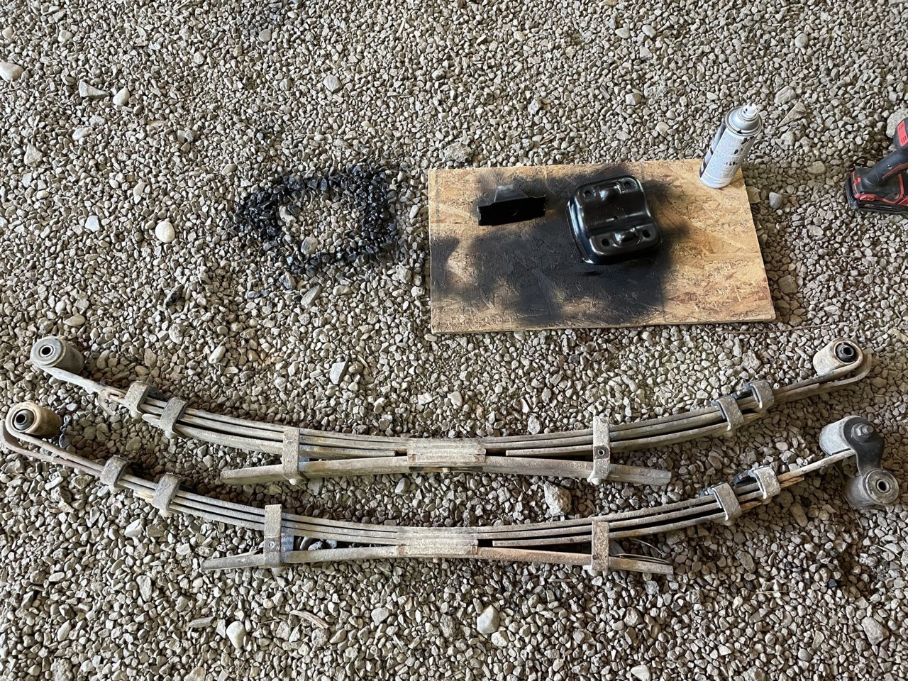

    “TSB” leaf springs are still garbage. Do yourself a favor and buy real springs.
    This is what mine looked like before replacing.
