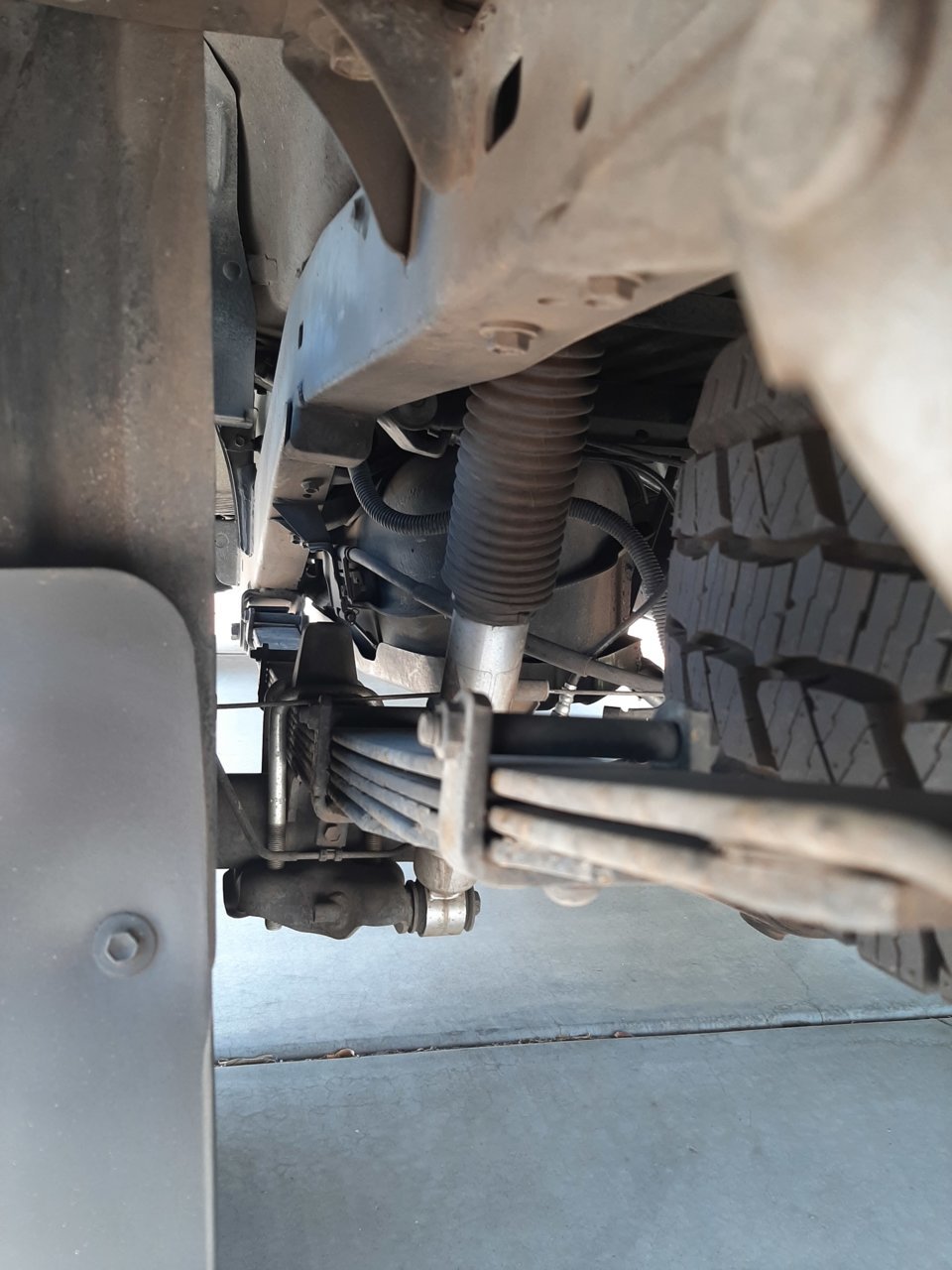

    I had standard duty General Springs on my truck for about a year and a half. Looked good at first, but within about three months and one session of hauling a wall tent and a bunch of other gear to a hunting camp they sagged worse than the original 20+ year old leafs. I do have an old Raven fiberglass shell, but it isn’t that crazy heavy. I installed ride rites to help with the sag for a bit, but those were a band-aid and I didn’t love them for that purpose. Had to keep about 30psi on the driver’s side and the minimum 5psi on the passenger to just level the truck out. Made for a rough ride using air to offset crappy leaf springs.
    I recently upgraded to some Dayton HD springs and removed the ride rites for a bit to see how the springs settle. Only have about 1000 miles on the new springs without the ride rites, but I’m happy with the purchase so far. They’re keeping the truck at a pretty standard rake and very minimal on the lean as well. I’m actually driving cross country at the moment and have a bunch of junk in the back along with the shell, and no sag of yet. We’ll see how they look once I’ve been back in the Rockies tearing around on Forest Service roads for a bit.

    If I bought those SD springs I would be a little upset. They are almost as flat as the rusted out ones. Why bother ??
