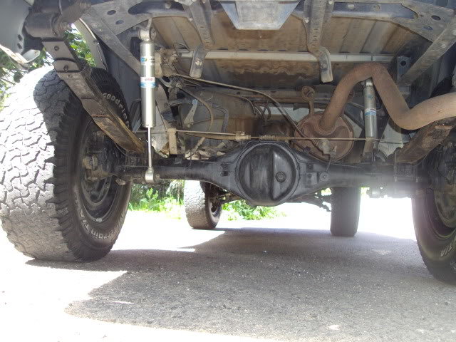

    the measurements of 40.5" & 33.5" <<bottom leaf combined with the 3 remaining stock springs is what I did to achieve 3"

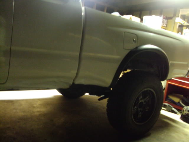

    theres nothing special about this pic except Matt noticed & then i noticed the relation of body & cab to the terrain you can't tell from pic but thats about a 20" drop into creekbed & im damned near level

    OK, I see then you left the 3 stock springs on and just added the 2 from the Ranger after cutting them down to the sizes you gave me.
    I will try that first.
    I had Friday off but I picked up an extra shift so I'll have to wait until Sunday to work on them but at least I'll be at my parents house and I have access to more tools and a garage then.
    So i just need to subtract 6.5 inches from the big sring by cutting each end 3.25". then cut the smaller one 4.5" by removing 2.25" from each end.
    How did you reuse the anti squeak pads?
