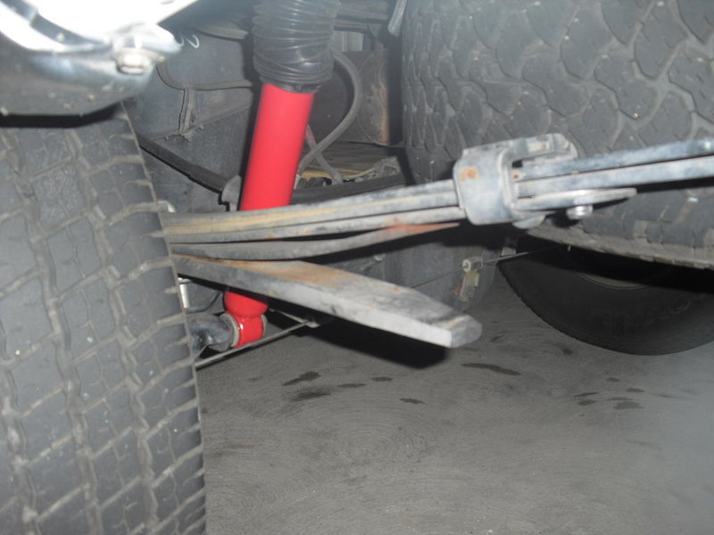

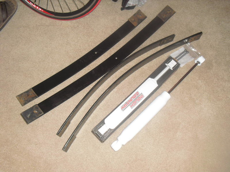

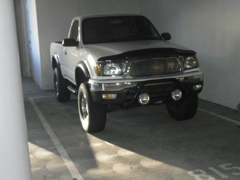

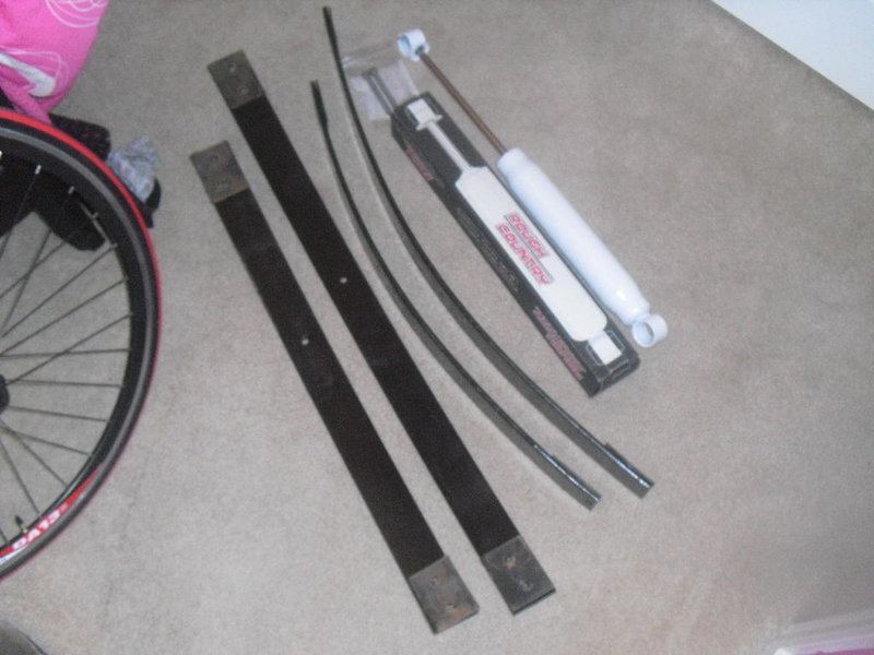

    OK, found my camera and took 2 pictures of my set-up. Notice how much better the leafs look now that they are cut and painted! Also included 2 more pictures. One of my current leaf set-up with 1.5" fabtech long leaf with my new Monomax shocks. The last is my truck the way it sits now.

    Wow, you are going to get a fair amount of lift , good thing you're dumping the OL.....:eek::D

    I was hoping to leave the OL in but with the addition of 2 new leafs I don't think there would be enough threads left on my U bolts. I know you said that your Ranger leafs allowed enough threads but I am adding 3/4" minus the AAL that's there now. It would be close. I'll try it anyway and if it doesn't work then screw it I'll control alt delete them!
