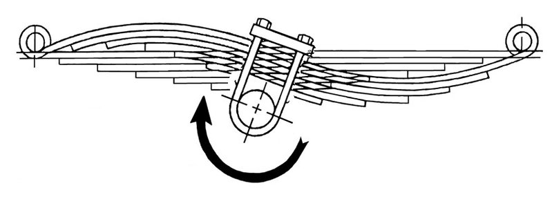

  6. Feb 20, 2011 at 9:58 PM
    747
    747 function > form
    Jan 27, 2008
    #4465
    3,005
    1st Gen.
    if they do this when you brake [EDIT: or accelerate]...
