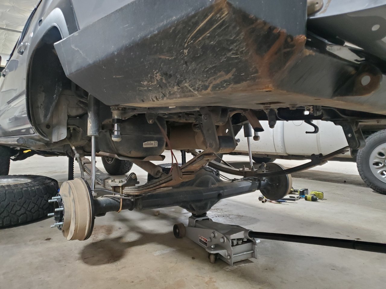

    Just do 63s if you're doing the work of making the Tundra leafs work. I have hardly any axle wrap with my setup.
    Currently running:
    3 Original Chevy leafs.
    1 leaf cut down from a stock tacoma pack.
    1 Chevy leaf cut down and added on top to act as an antiwrap leaf, retained by the stock clamps.
    All in all technically a 5 leaf pack, but the Tacoma leaf and the anti wrap leaf are just there for extra support against wrap.
    Chevy leafs are also 100x more common than Tundra leafs. You can find them on almost any Chevy in a junkyard, or can order new packs or $130 each and have them next day.
