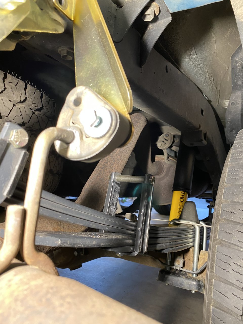

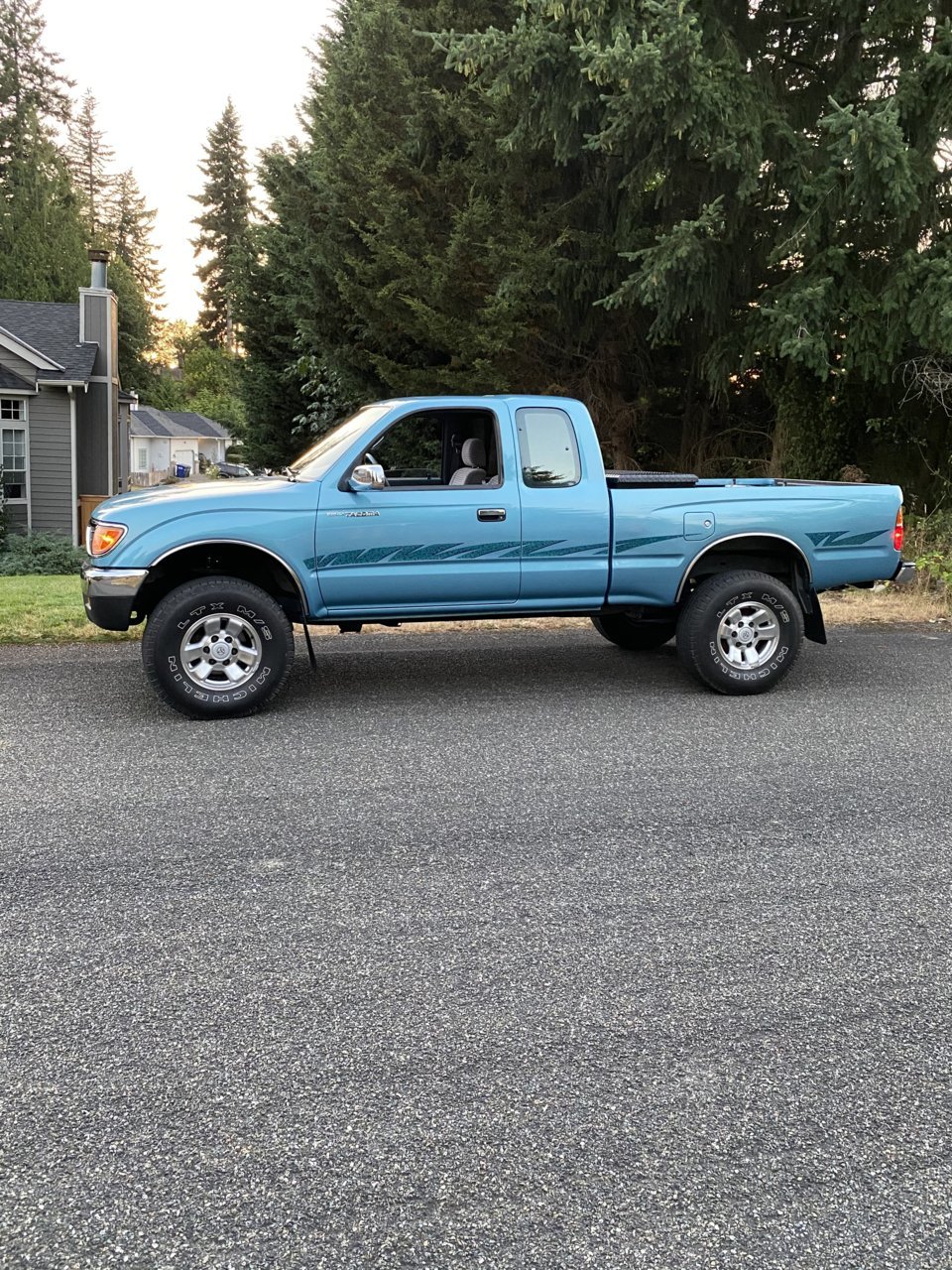

    Just installed Dakar Leaf Springs since my olds we in terrible shape and also did OME881 in the front. 95.5, extra cab, no added weight. It's leaf pack CS019R, No added leaf. Setting me up at about 2.5" taller in the back than the front. I read this might happen. Which leafs are ok to take out? The set has 3 leafs and 3 overloads, each overload at about .5" each. If I take out two, I assume that drops me 1"? If so, which two? I've heard people taking "the third from the top" but in this case that one has the alignment brackets on it.
    Tbh I drive 95% of the time unloaded, but I have sandbags if that will help settle. Any input appreciated. Also side-note, the passenger side is a little taller, maybe due to full tank of gas?

    How recently did you install the leaf springs? They will settle over time, Dakars especially are known to settle some. I would give it a few weeks and see if you like it more after they settle a bit, you can help it along if you put some weight in the back.
    A good 1 - 2" higher in the rear is ideal in my opinion, the rear should be higher to accommodate any loads you might carry that would otherwise make it sag below the front

    Take out third from top
    Stock only use 2 and now you got all that metal down below.
    hopefully you don’t get driveline vibrations. If you do you’ll need a shim which increases lift even more. May also need to explore a carrier bearing drop.
    e/ imo rear should only be at most 1” higher unless it’s a farm truck
    jammer likes this.

    Honestly just installed them yesterday, just had a bit of shock when they were that tall. I will throw some sandbags in there to help settle them down, but still would like to come down an 1" or so I think? I haul maybe 3-4 times a year. Also on those fronts, I got the spacer installed and have no lean up there, pretty happy with the front! I meant the back being a little lower on the driver side.
    Third from the top is the one with brackets keeping the leafs straight I thought that one had to stay? I agree I would like to be about 1" higher in the back. I have a carrier bearing drop haven't driven much yet

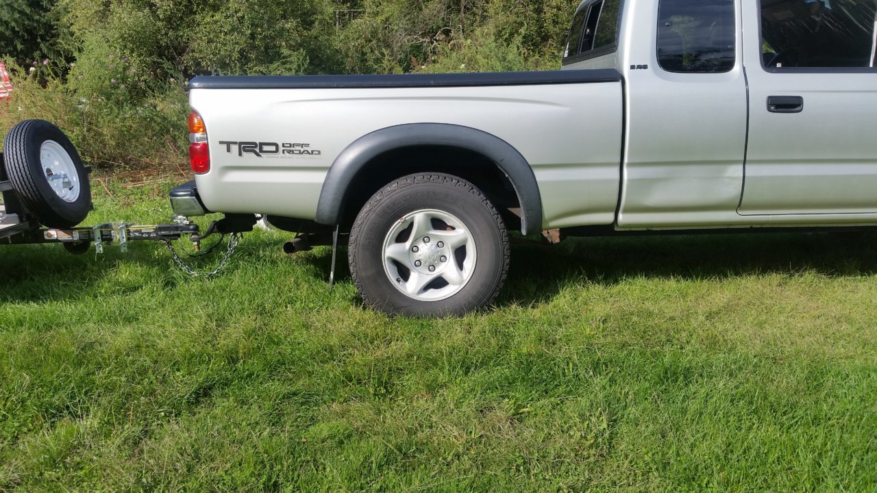

    remember that you are getting 2.5" over "STOCK" height, not over "worn out spring" height. many people forget this.
    but yes after about 3 months mine were pretty flat settled and ride fine.

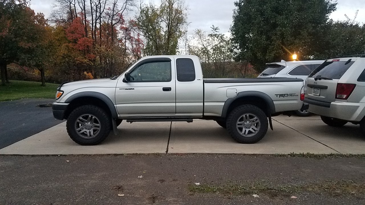

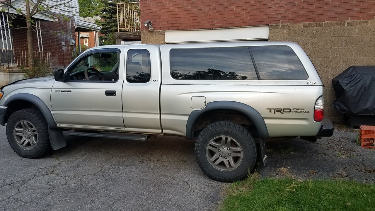

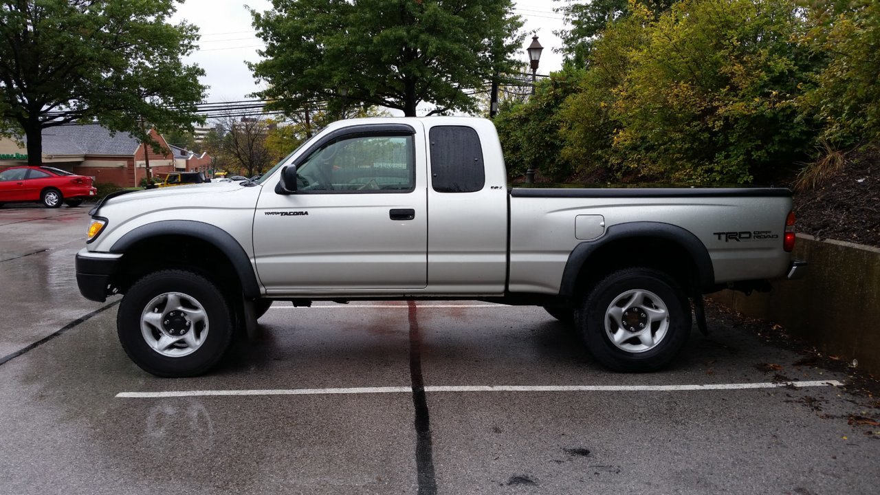

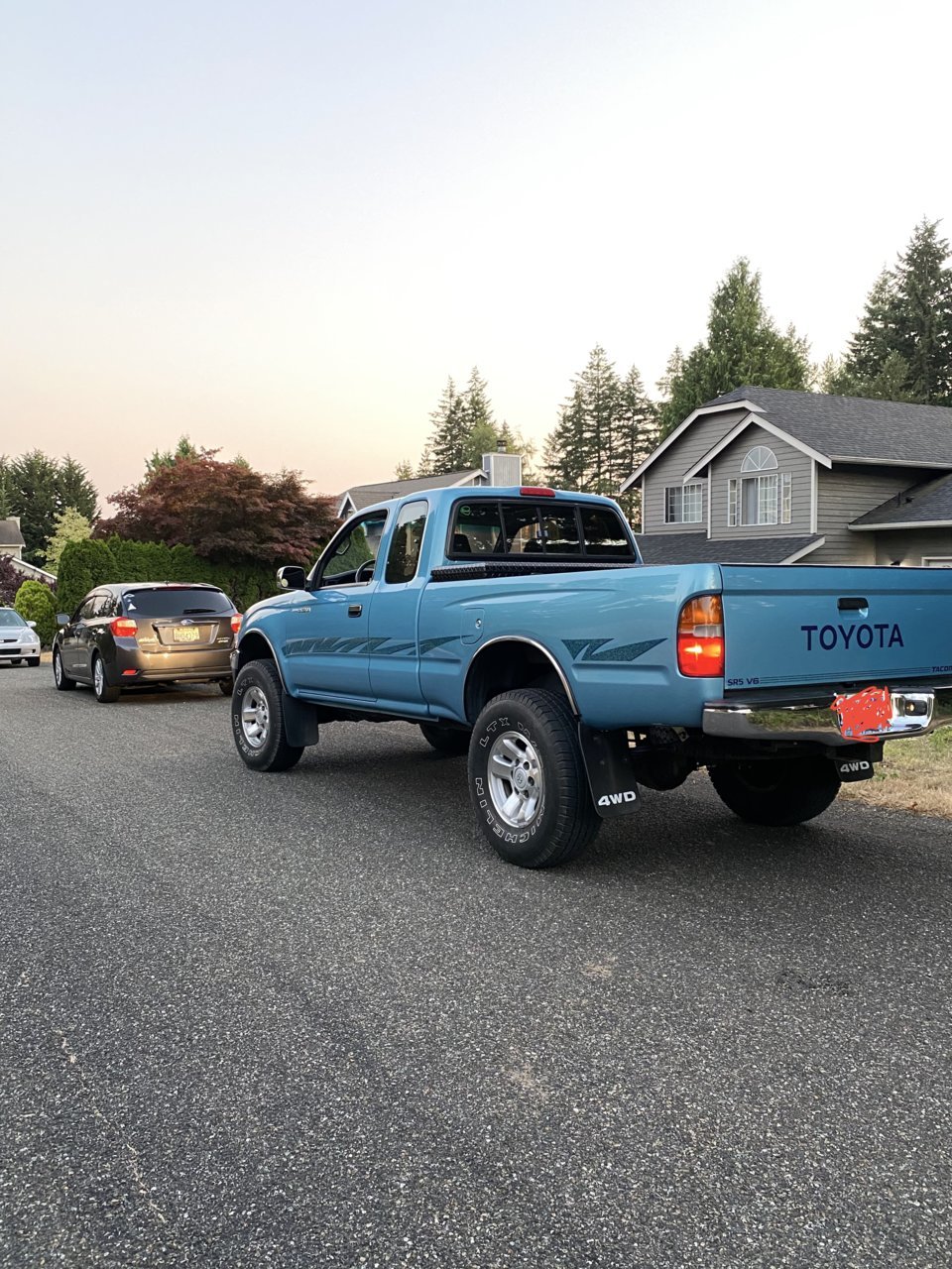

    first pic: stock worn out (trailer didn't lower it much, it's a light trailer)
    second pic: new suspension (like > 2 weeks)
    third pic: after 1 year
    fourth pic: after 3 years
    Currygoat and Krogers128[OP] like this.

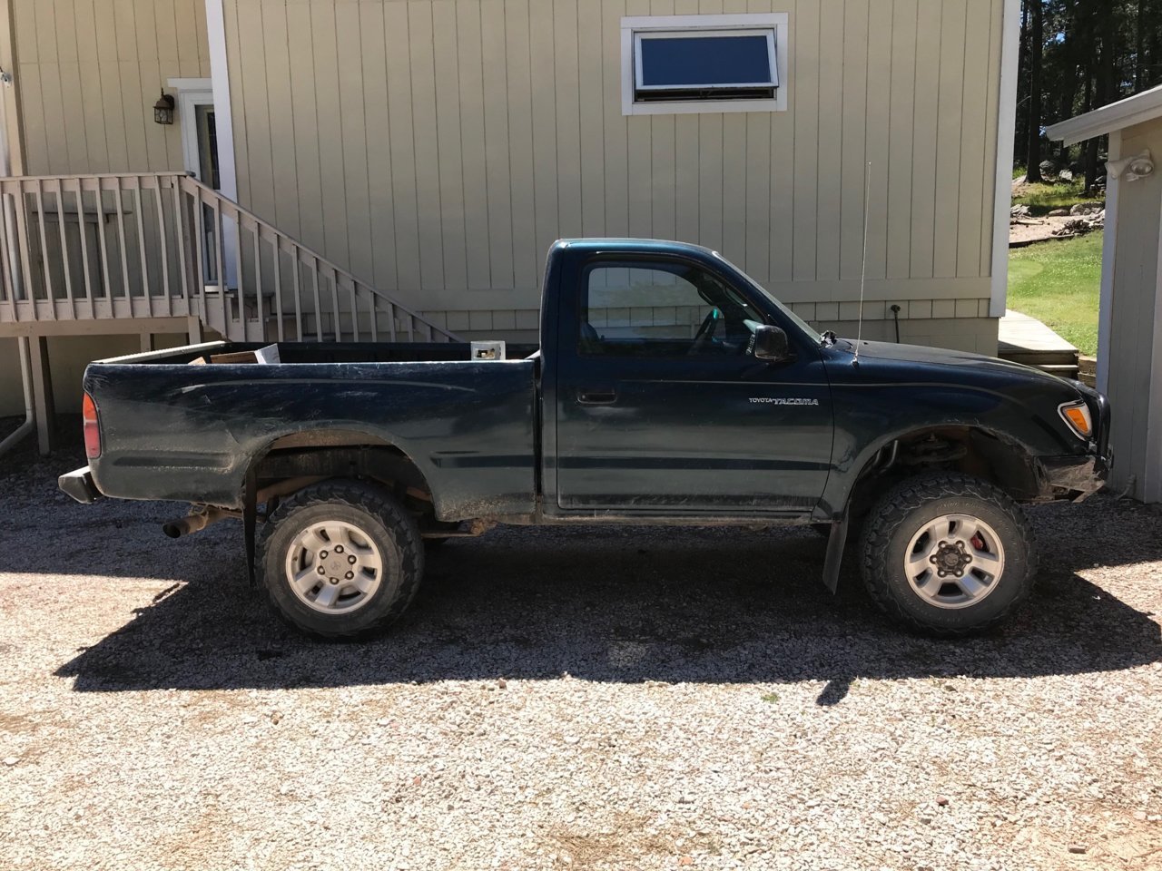

    If that first picture is after install, I don’t see any excessive lift. I wouldn’t be worried at all.
    Here’s what excessive lift from dakars really looks like:
    I gained more than 5” over the worn out stock leaf springs.
    A week ago I pulled the third leaf from the top and it sits much closer to even with the front 880s.
    Asian Dave and Krogers128[OP] like this.

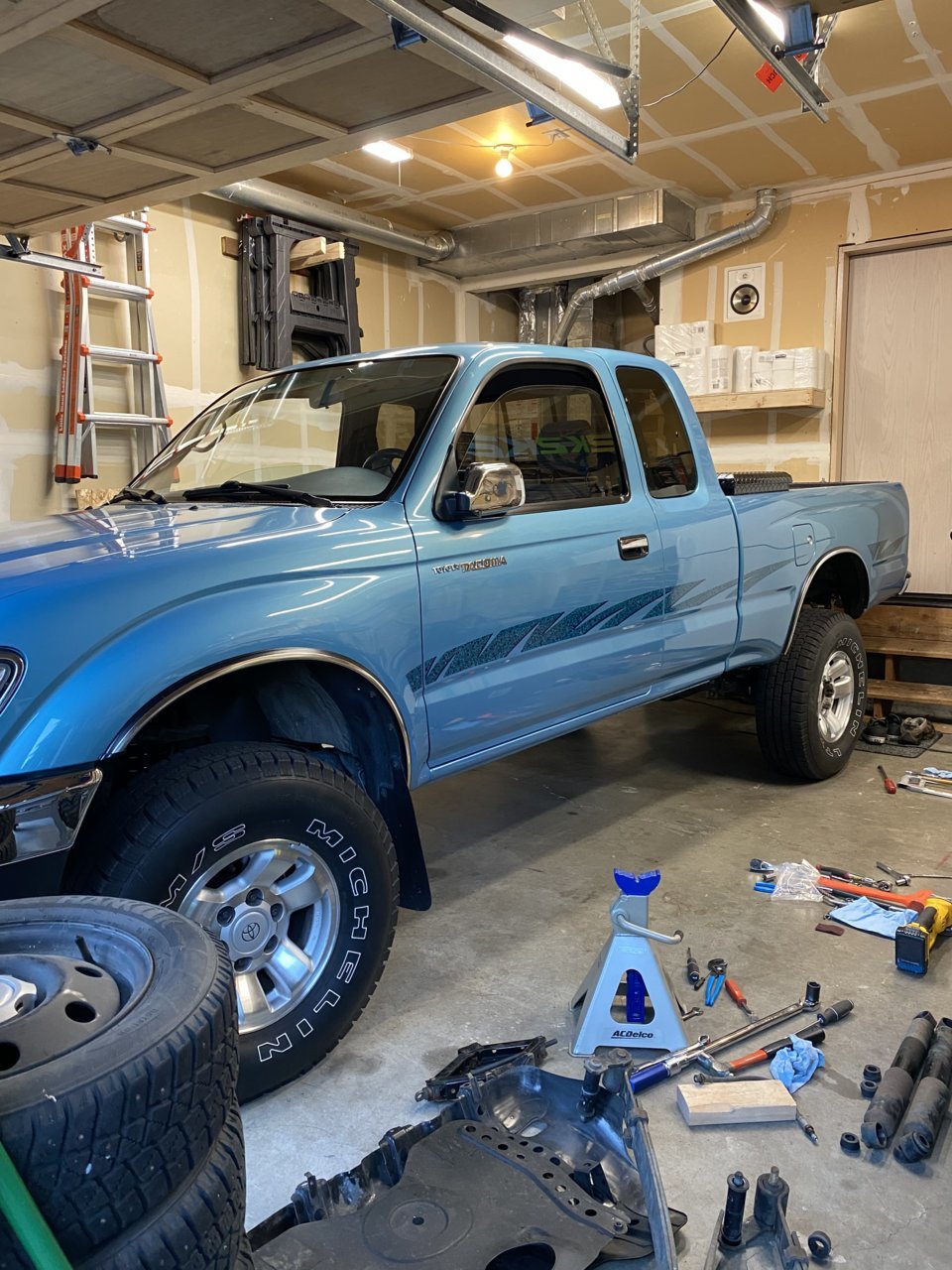

    I took the 3rd spring out (From the top) and it evened the whole thing, doesn't look like a 70's hot rod. I have transported a motorcycle in the back that is about 585 Lbs with no noticeable sag.
    After spring removal:

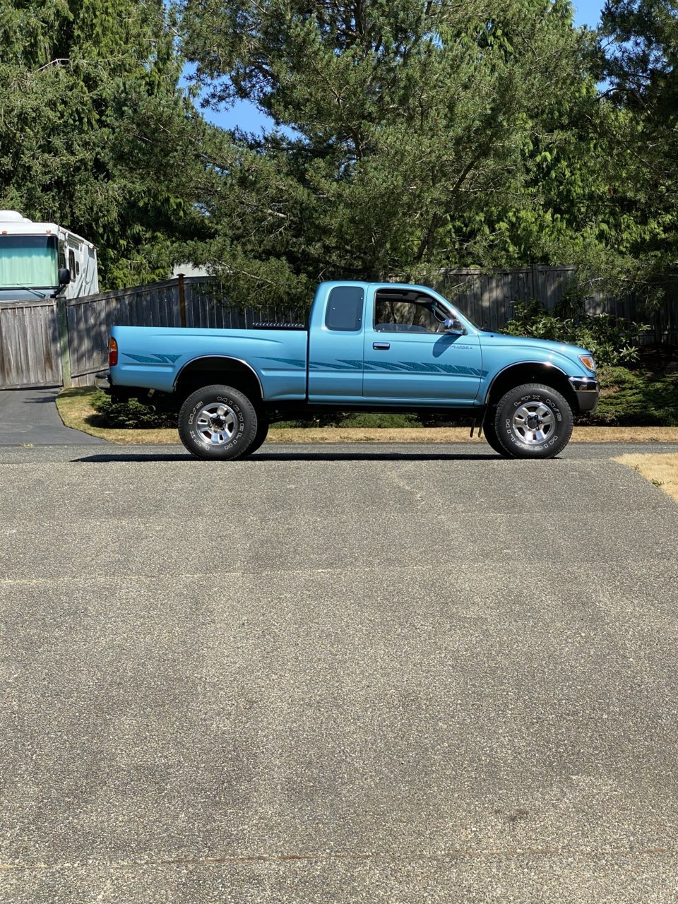

    yeah definitely more than mine! was this the 018R? I guess the first pic doesn't show quite how much rake so I'll post another. After a handful of mixed answers, even from ARB, I just ended up pulling a leaf myself. Did it with the leafs on the truck, wasn't so bad, a couple hours. I'm happier with how it looks, I don't haul often. Worst case I just throw it back on later? Sitting just over 1" higher now.IMG_9636.jpg IMG_9637.jpg IMG_9639.jpg IMG_9641.jpg
