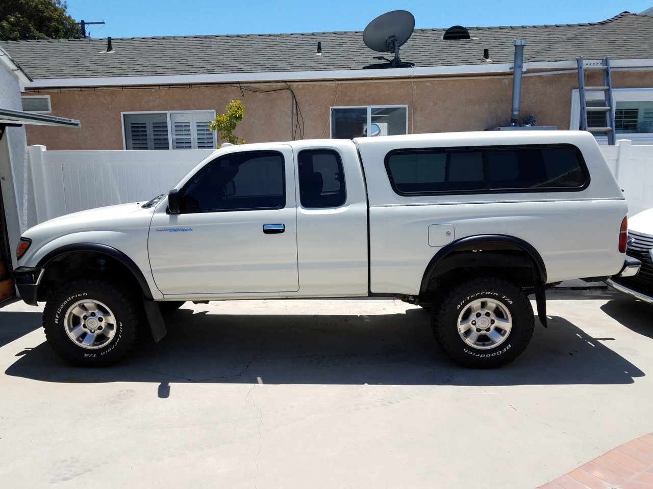

    ahh ok yeah that was a decent rake. Definitely hard to tell from that first angled shot.

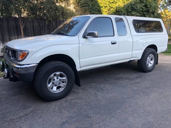

    Before lift I had 35". After I had about 40" maybe 40.5". Now after a leaf gone, I'm at about 38.5" (37.5" in front). I don't plan on moving the front any higher, at all, so I didn't want to just leave them in and lift the front more, I like where the front sits. If it settles a bit then I can throw in the other leaf. One thing that only concerns me now is the top two leafs are resting on the overload, isn't much space between them as there was with the 3 leafs left in as it came.

    thank you! Truck gets about 4K miles a year (maybe more now with new goodies) and I keep it in the garage since I bought it. I clean underneath anytime they salt the roads (not often). Also shot with an iPhone 11pro so not a bad camera!

    Man, I thought I had a clean truck. Super nice looking truck. It looks perfect with the leaf removed. Now you gotta decide what tires... and size. 265-75r16 (32's) would look great on there when you get the 16" 3 spokes.

    thank you! Yours is very clean as well. I’m leaning 265/75-16 just so I don’t have to mess with much (if any) trimming or the pinch weld mod. At only 2” in the front should look good, not sure about the back. Really wanted some 255/85 but.. maybe next truck.
