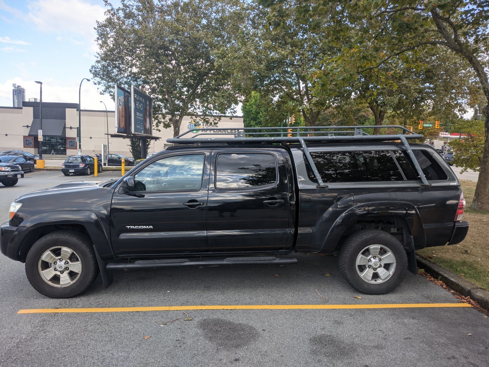

    Hello guys I recently purchased 2011 Tacoma. The leaf springs need replacing because they're almost flat now.
    I have found a lot of useful info here but could you help me with my specific case?
    I will be using the truck for camping (no crazy offroading) and work (no crazy loads 0.5yd soil max). I wouldn't mind going with Deaver or Dobinsons but I'm worried how much it will lift the truck. Right now I can fit in our underground garage. I have a canopy with custom made rack. I have probably couple inches to spare.
    Edit: I live in BC, Canada

    That's a very distinctive-looking rack. The rearward-swept uprights look cool. I guess the trade-offs would be considerably-reduced overall load capacity, and being incompatible with gullwing doors on a topper. (If there were such. I have gullwings on my ARE contractor cap.)

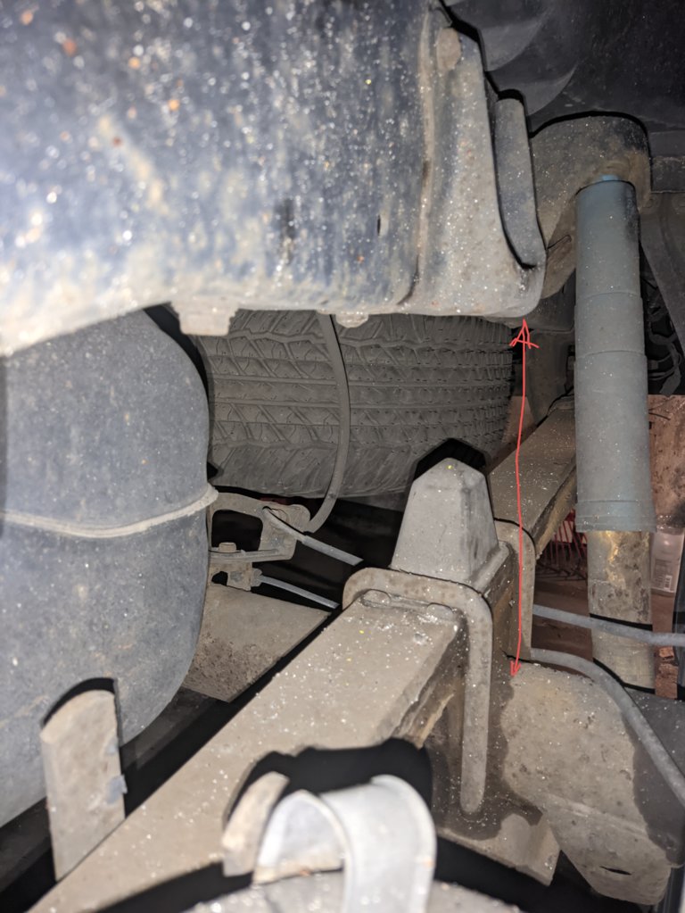

    That's right, they don't have much arch at all even when new. Best to use measurements instead of looks to determine how worn a leaf pack is.
    OP, take a measurement from the center of the hub up to the fender edge. That will tell me/us what height you're at now compared to stock. New stock is usually about 22". In relation to the front, the rear lift height doesn't look bad on your truck right now.
    Most lifted springs are 2" or 3", so you'll have to jump up a bit unless you just do an add-a-leaf, and you'd do that to add load support (extra strength) as well as lift height.

    If you're talking about this height (poorly visible red arrow) it's around 22". The leaf spring are flat. I would even say negative arch. Made me worried.

    no, from the center of the tire to the bottom of the fender directly above it. NOT from underneath, just standing next to the truck

    Oh I see! Lol. I'll measure again tomorrow. Thanks!
    Edit: it actually makes sense now. English is not my native language so I was a bit confused at first.

    Like this, but for the rear:
