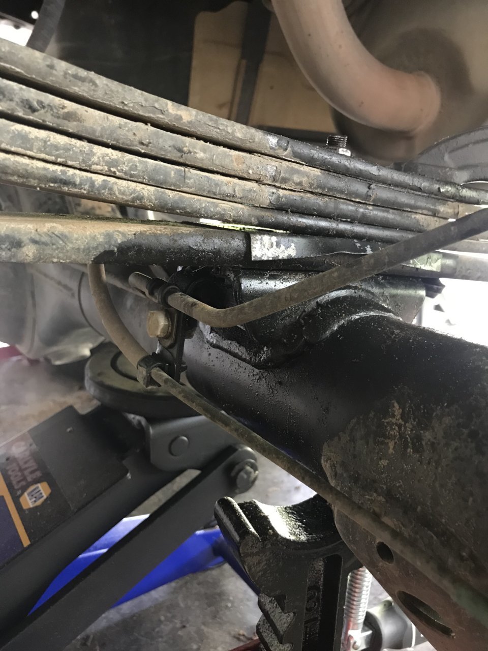

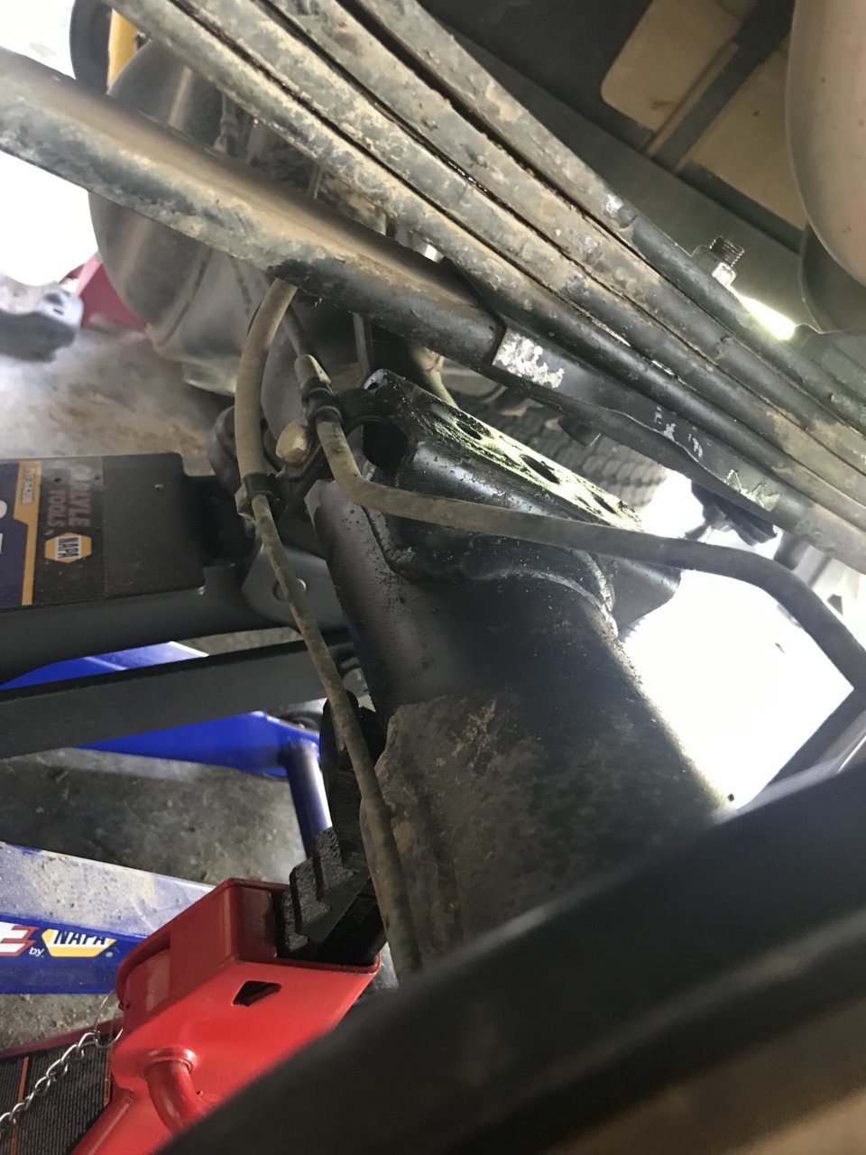

    hey guys,
    I've searched and couldn't find exactly what I'm looking for. I'm changing out the leaf packs w/AAL that I currently have for a set of Dakars. I've got everything unbolted except the front and rear eyes. U-bolts and all disconnected. But the leaf packs won't separate from the seat on the axle like every video you see. Am I just missing something obvious? Could the leaf spring retainer bolt head be hanging onto the axle or something?
    Any advice would be well appreciated. I'd hate to put it all back together being only halfway done. Lol
    Thanks

    Both sides appear to be stuck the same way as well.

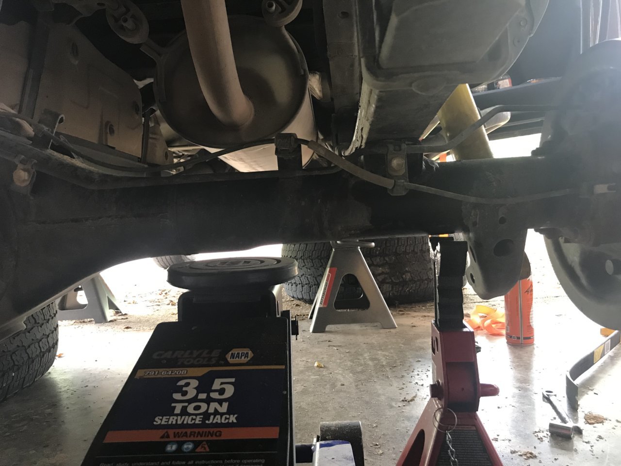

    Yeah, I've got a floor jack under the side I'm disconnecting and a jack stands holding the other side. It droops a bit then hangs like normal. I was thinking the axle would continue to droop below the leafs? That's how I put the AAL in there maybe 7500 miles ago.

    Can you post a few pictures?

    I was originally working on just one side, but couldn't tell if one tire being on the ground was giving it a weird angle.

    I cant quite tell but is your shock unbolted? That will give you more droop.

    Yeah, the shock's unbolted

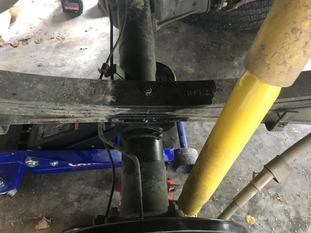

    So I put a clamp on the pack on one side of the axle and you can see the overload is still touching the axle. I've hammered upwards and still nothing.

    Idea 1. The pins are jammed in there some how. Undo the leaf pack bolt and see what you can see. Clamp the leafs together while you do this and release the tension gradually.
    Idea 2. Get a bigger hammer and get serious.

    I was just about to do that when chiselling finalling separated it. Really though, I hope the same hammer and chisel will work on the other side.

    Both sides took some chiselling and praying for them to pop loose. Not sure why, but my guess is it had something to do with my AAL install. But I really couldn't say for certain. The second side hasn't taken nearly as long. Guess that's true of every install I've done.
