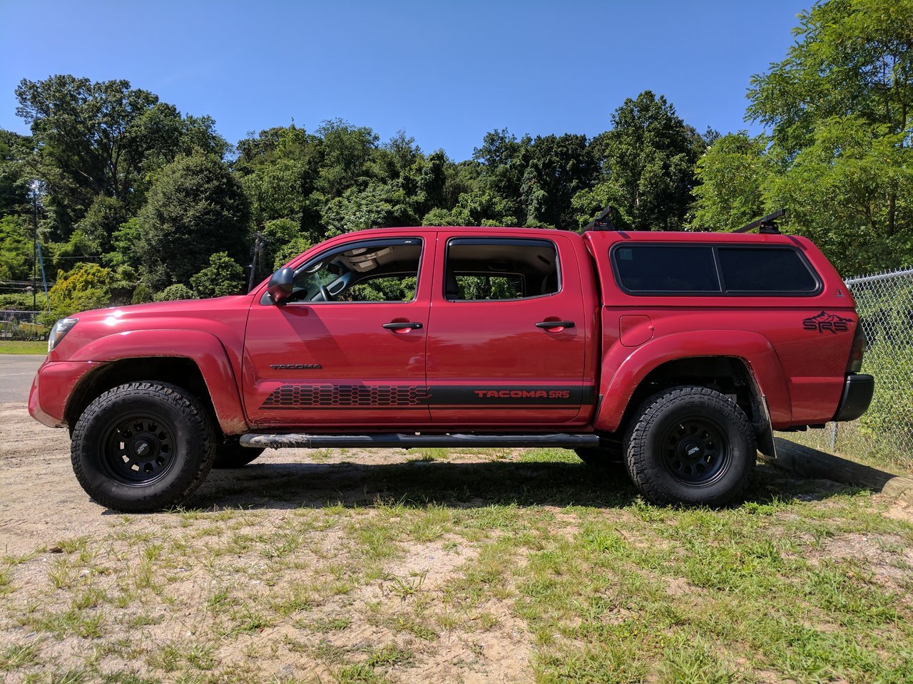

  20. Aug 1, 2017 at 6:30 AM
    #20
    Gcsteve
    Gcsteve Well-Known Member
    Dec 30, 2016
    #206069
    610
    Steve
    long island
    2015 Red sold, 2017 Inferno Sport Traded for a Honda w/ payload #1500
    Shackle flip with 2 AAL, 2.75 spacer in front and I think I am pretty close to stock prerunner height. 31s with 4.10 gears. shackle flip gives at least another inch and softens the ride much. With the gears it rides as if I still had the tiny stock tires on it on the hwy. Its not down shifting as much as before the gears. Also getting about 18 mpg if anyone cares about that.IMG_20170726_150012.jpg
