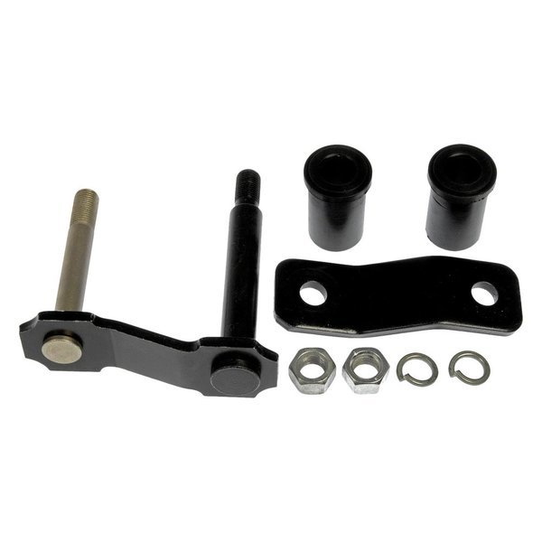

    Thats what I was talking about... that part of the bolt is meant to stay in the hanger plate, so if you try and smack one bolt out, the other one is still press fit in which will make it seem like its frozen, kinda like how lug bolts are set in...
    Like others have said, it don't matter now...cut everything that wont budge and start fresh
    Nothing like new leaf packs :thumbsup:
  10. Sep 2, 2016 at 10:01 AM
    WinSlow939
    WinSlow939 Road Salt Life
    Jul 31, 2016
    #193357
    659
    Nate
    The Rock, Mass
    2002 with some '99 thrown in for fun
    All the Money I Have
    Like this:

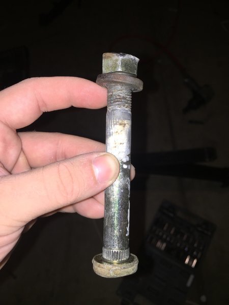

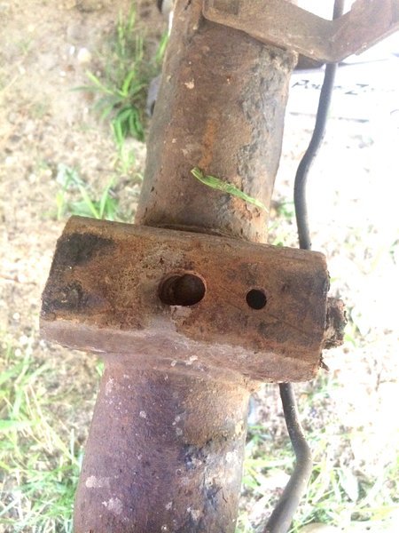

    I don't really ever check torque again after a wrenching mission, but leaf spring/ubolts/shackle nuts will all move around like mofo's cause of how much the rear end cycles.... its a good thing to recheck everything in a bit...cause if you don't, you might end up with a leaf spring perch that looks like thisIMG_0898 (1).jpg
