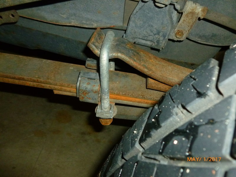

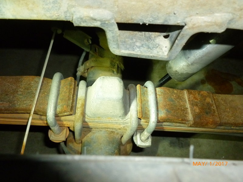

    P1030074.jpg P1030081.jpg Here's a couple pictures of my Hellwig add-a-leafs. I would add one caveat: the springs install easily, but I found the front leaf pack u-clamp had a bit too much forward lean to my liking because of the shackle position on the factory leafs. I didn't want to take any chances with losing that clamp under load bounce, especially with the gasoline tank in proximity on the driver's side, so I took a hack saw to the axle end end of the leaf. I attached two pictures. One is the forward clamp on the driver's side as it appears now (almost vertical = good); the other photo is at the passenger side axle and you can see where I cut maybe a half inch or so off the lower add-a-leaf spring and that allows the spring pack to slide just a bit closer to the rear axle allowing for a near vertical clamp position on the forward leaf.
    Also, in the picture notice there are dual nuts on the clamps with lots of threads so you can engage those add-a-leafs a lot or a little as you need. I only wantP1030074.jpg P1030081.jpg ed a little extra oomph so I am at minimal engagement and used some loctite on the nuts so they don't back out under vibration.
    ChadsPride likes this.
