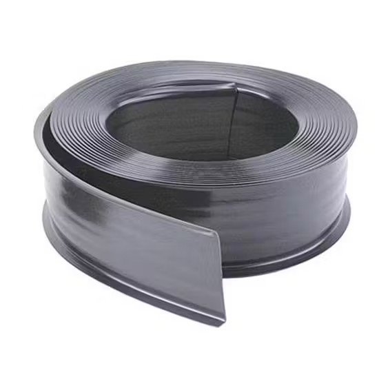

    Needle attachment on the grease gun .Get between the individual leafs . Then spray down with a rust prevention spray of your choice ! No squeak :D

    They all squeak. It's a characteristic of leaf spring design - many pieces of metal moving against metal, made worse once dirt gets in. Put in plastic liners suggested by @soggyBottom and squeaks will be gone. I've been running liners for 4 years with no squeaking.

    Got a newer OEM pack from Craig's for cheap, split them and added a leaf and the overload from a Chevy. Added some garden edging I had around to isolate the leaves from one another and combined it with a set of used Icon's. Said a prayer and the damn thing sat perfectly. After lots of miles and several adventure trips with some hitting the rocks pretty hard I managed to bust one of the Icons. Now ready to cut everything off, relocate the shocks with longer Kings but haven't decided on the springs yet.
