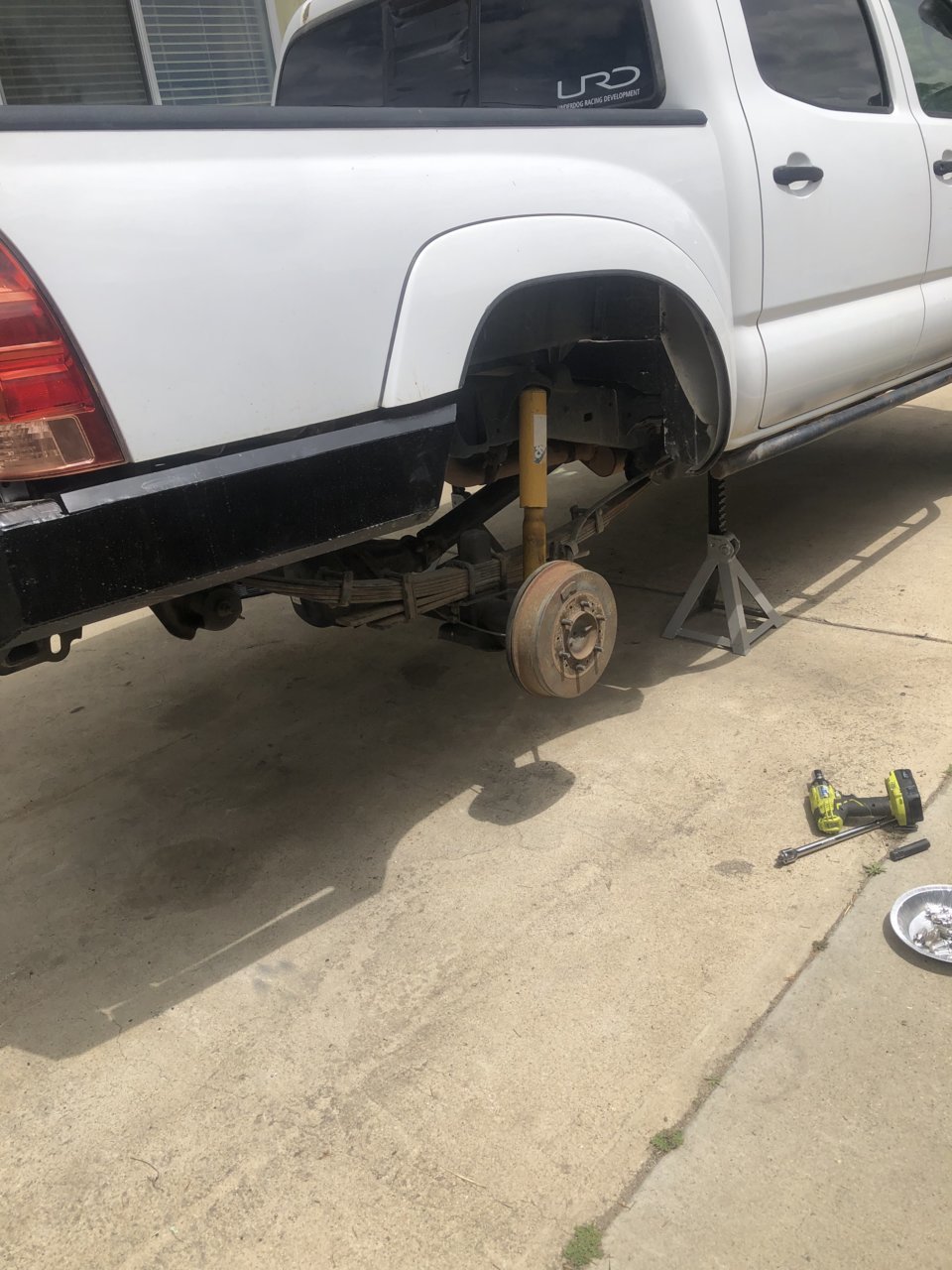

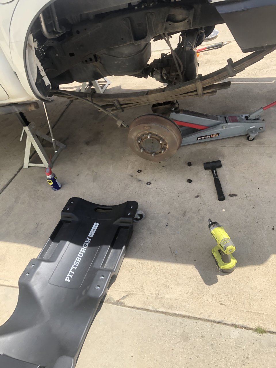

    I used 6 ton stands to hold the frame off the ground
    ADA2B281-6CFF-425E-89CE-6FB63618DD01.jpg 24BB5B00-3A69-48D2-B8B9-6B20C4F2E2D7.jpg
    Did 1 side at a Time and used the floor jack to hold the axle in place while doong u bolts

    As mentioned above, jackstands under frame in front of rear tires, jack under 3rd member to support/control rear axle and do 1 side at a time
