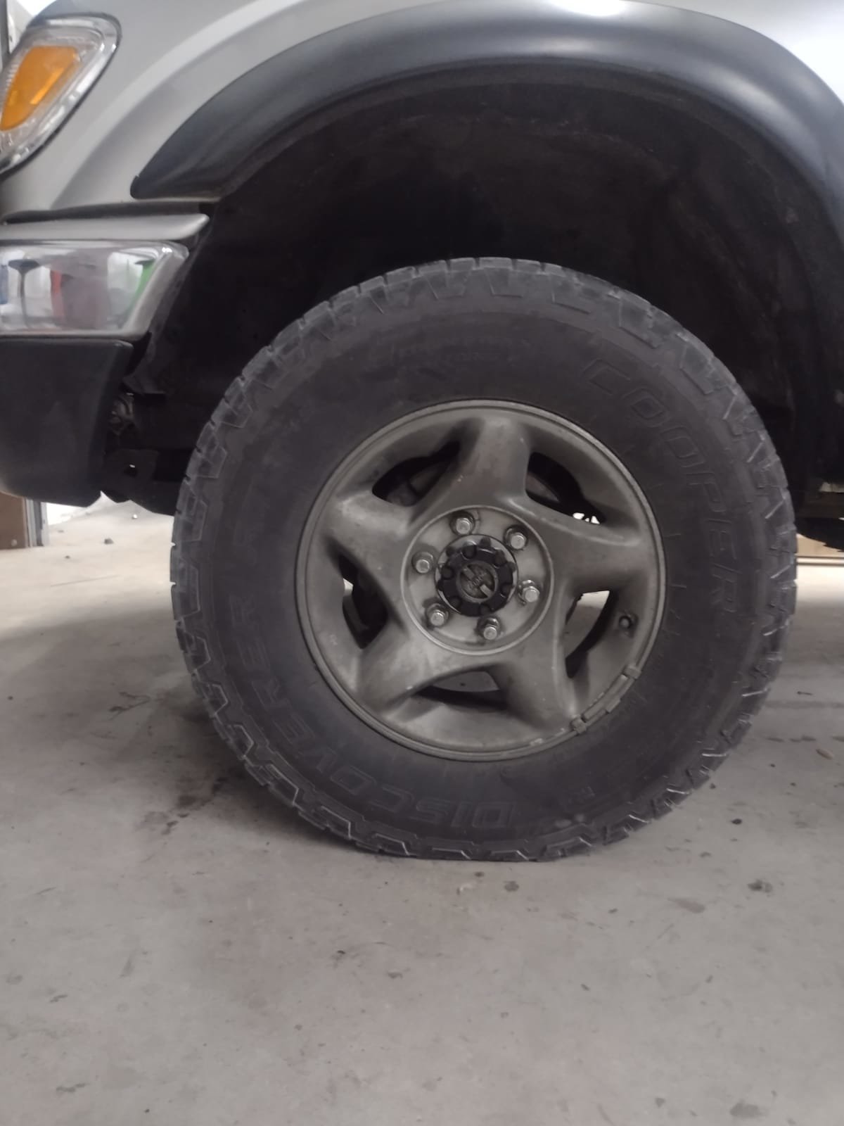

    Hi TW,
    As the title implies the stars have aligned and all my suspension components are bad so if I am ever going to do a lift the time is now. I am looking to get some advice before I buy anything. I am wanting about 2" of lift. From the research I have done on TW, I think I can accomplish this with Bilstein 5100's allround, OME springs (I am thinking of 881's I plan to add a bumper in the future), and Dakar leaf springs with additonal leaf added. https://www.srqfabrications.com/pro...gFu8H49ze_6sZgwhjTWevW8n1GVsfFkJnPOixO9nplHJ4
    I am currently running 265/75/r16 wheels, from what I can gather I should keep these the same size to prevent any rubbings. Am I missing anything?
    Any help is appreciated!
    (Pic is random, my truck is on a hydraulic lift so that is not the ride height)
