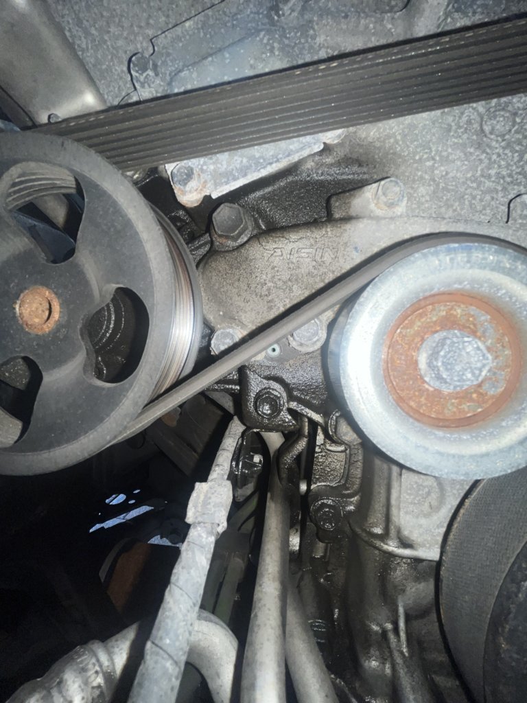

    None yet added some things. Still contemplating if I should get a small lift. I want to take it out on more trips with a skid plate and see how it does.
    Was doing a visual inspection and noticed this. I have never had any oil drips on my drive way or on my skid plate but i just noticed this. I whipped it off best i could. any ideas of where this is coming from?

    Infamous timing cover leak, it will be covered if you're under 60,000 miles 5 years.
    thanks for the reply, i got a little over 41k on it. finally got a work van and it’s been sitting for about a year now. i drive it once a week 10-15 miles. did a more thorough check since i plan on going on a trip this summer. I called and they said they’d have to take a look at it to see if it’s coverable. i still got my 60,000 warranty they said i’ll bring it in on monday
