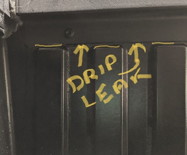

    I am not sure if I titled this quite right, but here goes. I have a Diamondback cover, which I can’t say enough about. I love it! However; I have had a persistent leak at the cab area when it rains hard. I did the fix where you take the plumbers putty and fill the transition between the cab and side bed rails, but the leaks persisted.
    Today I crawled into the bed with the cover closed during a steady rain. I could see water leaking/dripping along the bottom edge of the cab bed rail, about 12” in from the corner on each side. I have attached a photo for reference.
    I am wondering what I should do. Should I remove it and run a bead of sealant and then reinstall? I haven’t been able to find anyone else with the same problem. Thanks

    Yes uninstall and run a bead of silicon. Only way to fix it. You placed the putty in the gap but the water is likely coming in from somewhere else and traveling to that spot to leak down. A bead of silicon on the entire panel will fix it

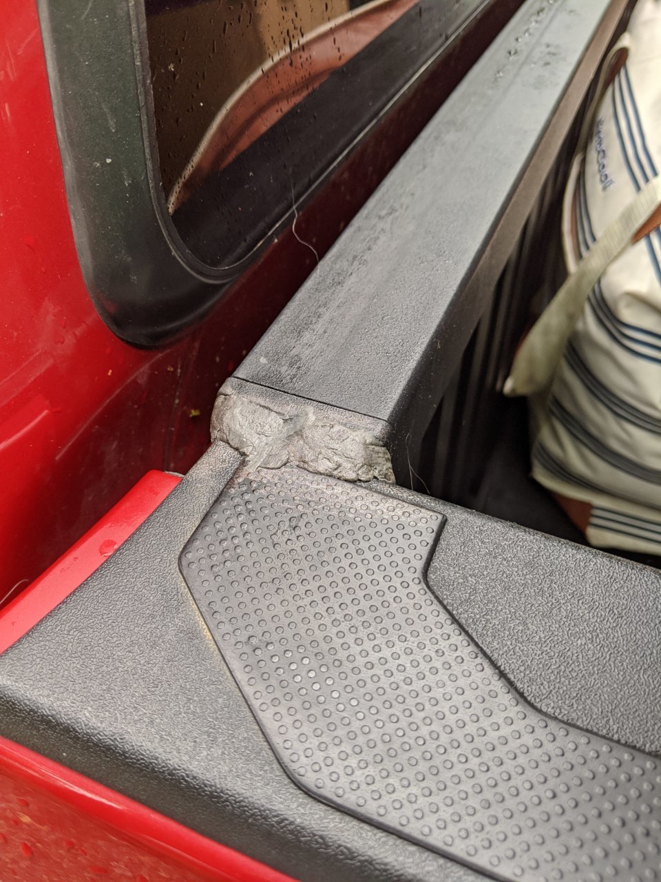

    Here is a photo of the HVAC putty that I used to transition from the cab bedrail cover to the side rail cover. I painted it so that the rubber gasket would not stick to the gasket.

    When you remove the back rail you'll notice there is a gasket type material that runs along the backside where it meets the bed/cab, noticed it installing my bakflip, I'd just reseal that or replace.

    Water travels by capillary action, so the origination of your leak(s) could be anywhere. A rather silly way to help find a leak would be to put sticky notes all under the bed rails before a rain. Afterward, check which ones are wet. One more thing you might look at are the end caps to the front rail. They seem to be just friction fit, so if the putty is removable you might want to remove it and seal up the caps with silicone then re-putty.
