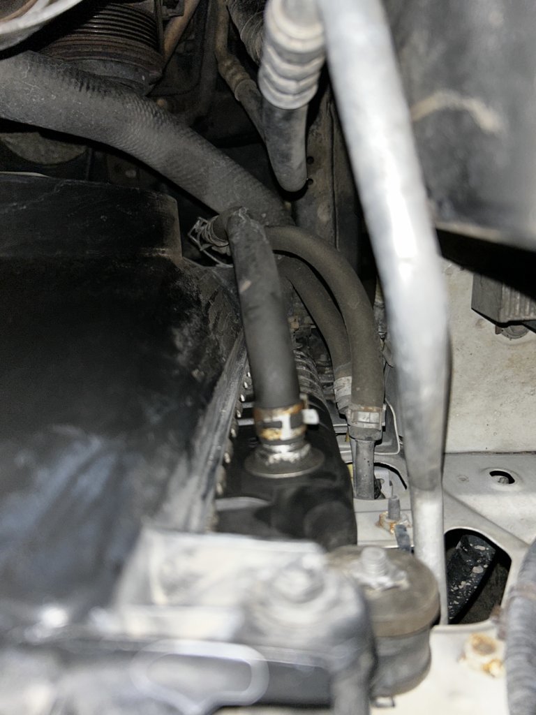

    This is the cooler line that was wet

    Just pick up a double ring clamp at the auto parts store. Mine had this issue several years ago and that’s all it needed.

    They clamp the whole circumference and install with pliers instead of a screwdriver. Like these but available in smaller quantities at auto parts stores.
    https://a.co/d/fGCDyrB
    measure your tubing size first to get the right size. Pull the tube off the nipple, pinch the clamp with pliers and slide it a couple inches up the tubing, then push the tubing back on and pinch the clamp and slide it into place.

    think that hose can be replaced. But yeah a new hose clamp might just be the ticket, but if you can replace that whole thing 2 hose clamps and that bit of ATF rated hose be good to go

    IF you have enough slack in that hose, you might snip off the end to slide a 'new' portion back onto the nipple.

    I see the build-up but thats a really crappy picture, pretty much useless for diagnostic reasons....
    If its the hose, it would easily slide around on the barb, by just rotating it....
    If its a stiff sticky solid adhesion, most likely not sealing past the hose & the barb...
    but its a place to start.
    from that blurry pic, its nothing more than just dirt collecting on some "sweat".....
    Ford warranty admin would want us to call that "normal".....
