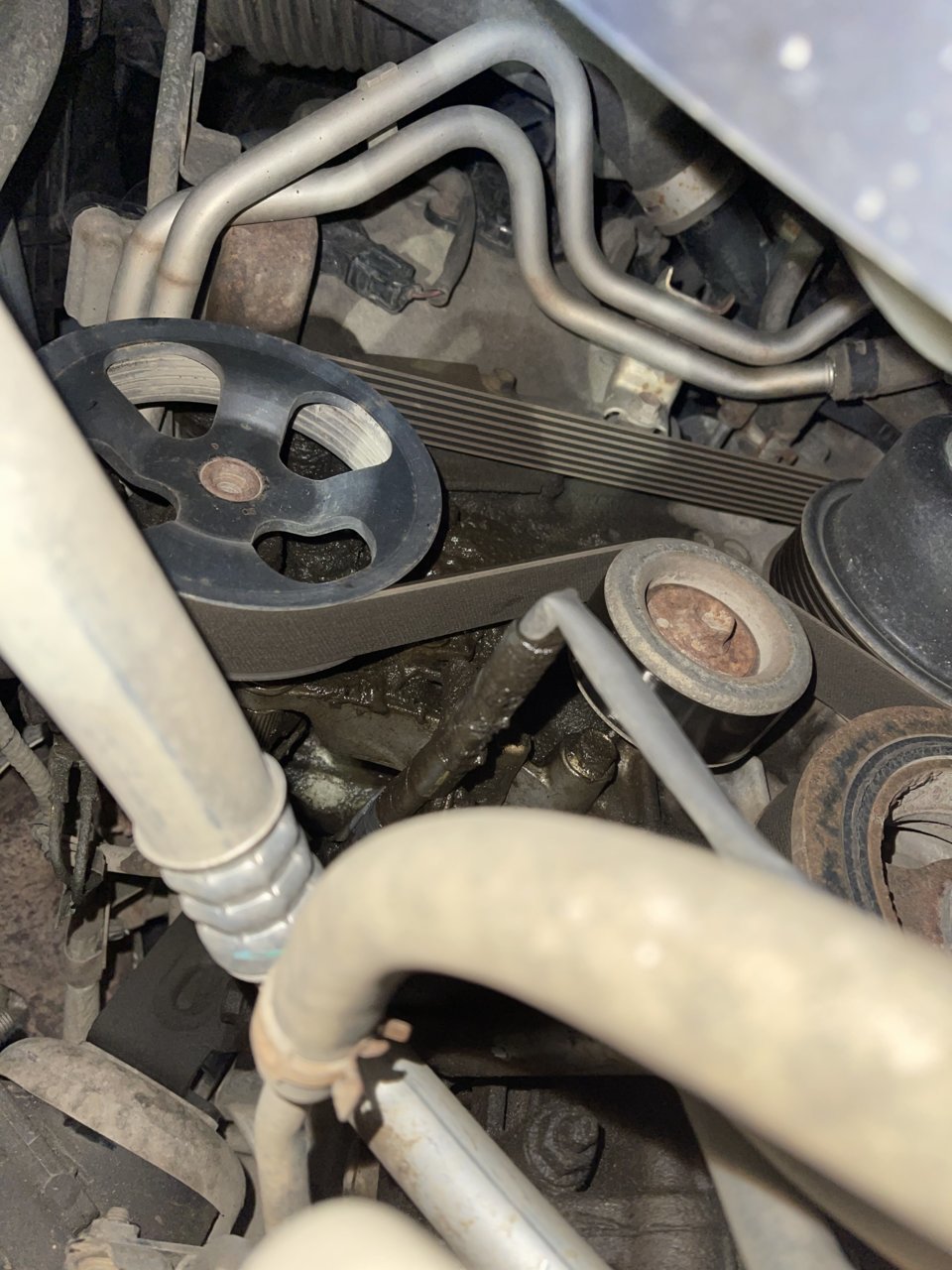

    Anybody else seen this before? Not sure what kind of leak I have going on here.

    Check the PS reservoir

    V6? If so, there's a good chance that it's the timing chain cover leaking. Pretty common issue.
    Unfortunately, it's a major/expensive job to repair.

    Prooooooobably timing cover, as mentioned above :oops:

    If you are under 5 years / 60,000 miles get it to the dealer .

    Took it to the dealer this morning, timing chain cover. Good thing for that extended warranty. Thanks guys.
