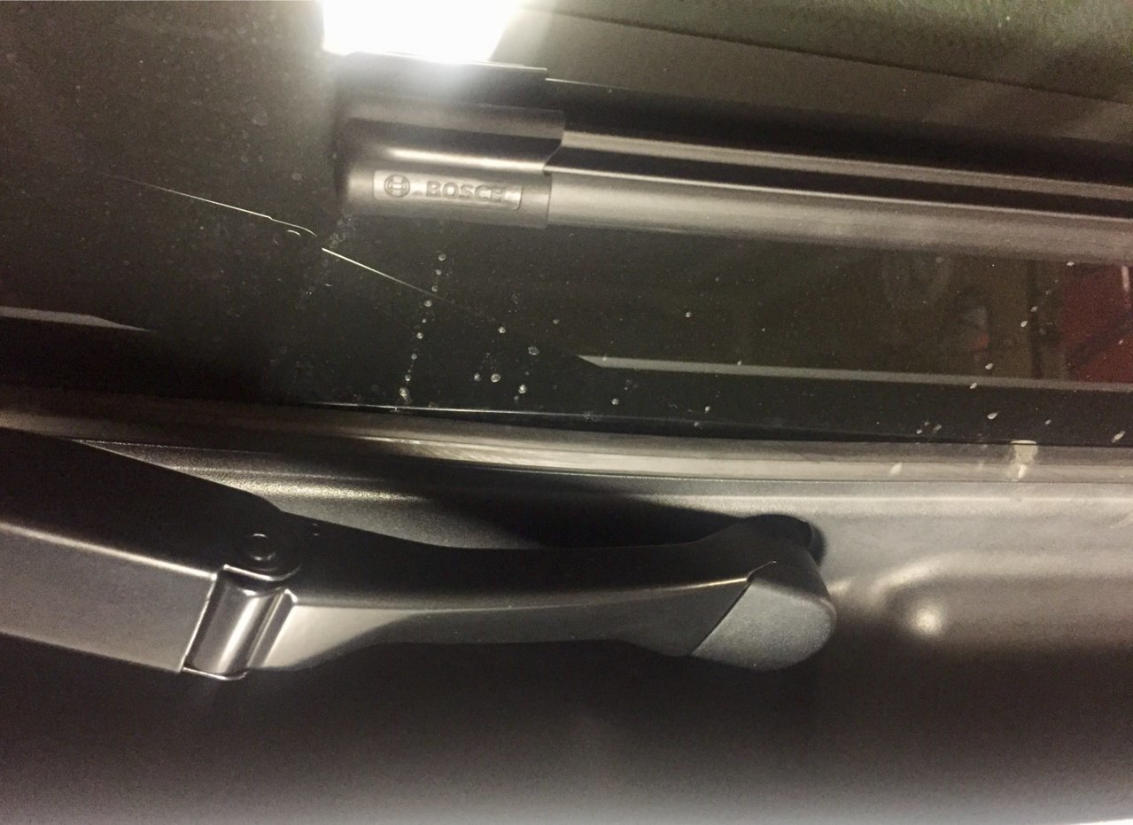

    My gap isn’t over the cowl opening which is further to the left on passenger side. So I dont have leakage into the interior. I also installed a piece of vinyl siding over the cowl opening to prevent any possibility of water intrusion.
    Your best bet is to remove the cover under the wipers and try to rebend the bent cover and reinstall with some sealer under the rubber gasket. By removing the cover you will get an idea of how the water gets into the interior. Also why it is removed install some metal screening over the cowl opening to prevent rodent intrusion.

    My leak was further to the right as you sit in the cab and right over the cabin air intake. It looked just like armkbs picture. I removed the cowl and cleaned the base of the windshield well with a razor bade and acetone. I applied a black adhesive sealant that I got from Advance Auto.It was not silicone. It was a small tube and I think it was from 3M. I squirted into the u shaped recess, the whole length, in the cowl weatherstripping. Make sure you clean the recess in the weatherstripping before applying the sealant. I reinstalled the cowl, wiped off any excess sealant neatly and taped the cowl weatherstripping firmly to the windshield with masking tape. The next morning I took off the tape and there was no more gap. I just checked my rain gauge, two inches so far last night and today. I'll check the floor tomorrow morning but I'm pretty sure the problem is solved.

    If the drains are opened and or unobstructed, there is no way enough rain could fill the area under the cowl and overflow into the passenger compartment. Remove your cowl...really an easy 10 minute job...inspect and get an idea of how water drains out. Make sure there isn’t a gap in the rubber gasket of the cowl over the cabin intake. That can be a direct source of water intrusion.

    I'm not so sure about the drains being big enough. Mine are clear, water from the hose goes right out of the bottom of the passenger fender. I have removed the cowl for inspection. I sealed the whole cowl gasket to the windshield with adhesive sealer. There is no visible gap now. I used auto body seam sealer around the cabin air intake curb under the cowl. I put a sheet metal shield over the air intake sealed to the fire wall so water cannot get into the cabin air intake from above as in rolling off the windshield and through a cowl gap. Unless there is another leak or gap under that cowl somewhere, the only way I can see is for that area under the cowl to fill faster than it can drain and overtop the air intake curb. We had 3 inches of rain this weekend in a 24 hour period. There were several tropical downpours during that time. Normal rains didn't seem to be an issue after the above actions were taken, but who knows. All I know is that the carpet is now wet again. It's really a pain in the neck. I'm open to all suggestions.

    I don't have any leaking, but I do have a gap in the cowl seal that looks very similar to Armkb's. I was going to see about the dealer replacing it, since it caught my eye, but now I'm worried that maybe the new one will develop same kind of gap, but over the vent!! Any thoughts?
