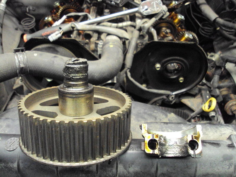

    I purchased my 04 TRD with a blown up 3.4L because the previous owner ignored a oil leak, and it was just a loose oil filter. The bed of the truck was full of empty oil containers. It's a shame because it only had 147k on it.
