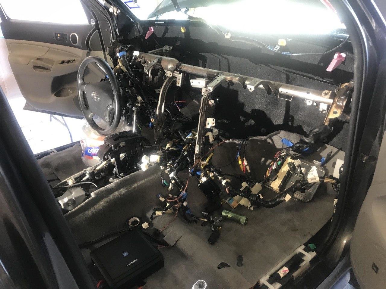

    Fortunately I’ve probably removed 80% of the dash at some point between the aftermarket head unit, sound system, and remote start installs I’ve done. So at least I’ve got that going for me lol

    We're in it boys.

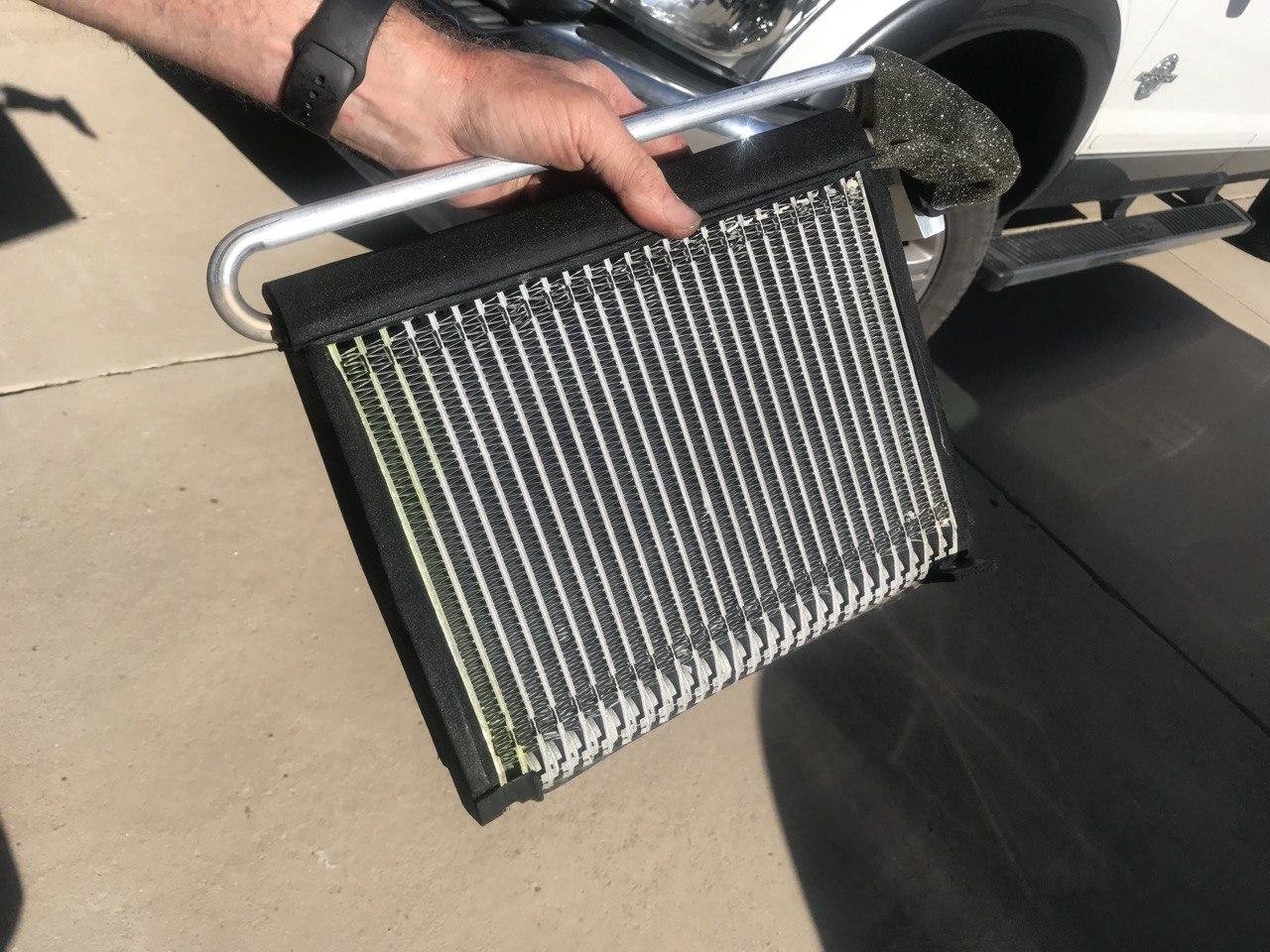

    Not sure of the process for that lol. You can see the dye leaking on the left side.

    I'll have to take your word. I can't see the dye in the pic.
    If you can see the dye, then you definatly found your leak.

    I found early in my career that I could take a dash apart. Putting it back together correctly, not so much.

    I can see the dye! Was that there from the factory?
    When my wife's car AC died the one of the "professional" shops said the evaporator was leaking. You can imagine just how happy I was when I tore the dash apart only to find a perfectly good evaporator. :mad::angrygirl::bananadead::boom:

    My biggest fear.
    I really didn't find pulling the dash that tough of a job. The parts really only fit one way. Pictures made it easy. Along with taking a few beer breaks.

    I was deathly afraid of this happening lol. The guy at the shop told me he could see some of the dye leaking from there when he removed the blower fan, so I trusted him. As I started taking it apart, I realized there was no way he saw any dye.
