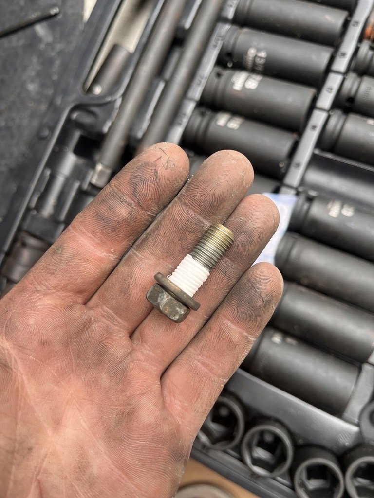

    I replaced my transmission mount the other day and when I pulled one of the screws out it was wet and some fluid came out of the hole. It did not drip more than what is pictured. I put some PTFE tape on the screw, put it back torqued it, then prayed to the spirit of Kiichiro and the 4x4 gods. How cooked am I?

    Well yes, it containing oil is why I'm concerned. I have no service history for this car before I bought it, but I suspect the mount that I removed was the original. My thought was there was a internal crack slightly above the Oil level so the space behind the screw could fill when the tranny is in motion but not leak any more when it is not. Maybe a slight defect in the casting?

    It was gold like the manual tranny fluid

    Yes no more drip than what initially came out. I just talked to my motor head friend and he said it is common that mount holes can go all the way through, so I suspect the casting may just be super thin at the back of the bolt hole. I will take this one back out and take a look as you suggested though.

    Is this the tape you put on the threads or aluminum threads from the trans that came off from the trans case?

    That is shmoo and oil. I dont remember there being thread fragments in it. The tape I put on was just the white PTFE plummers tape.
