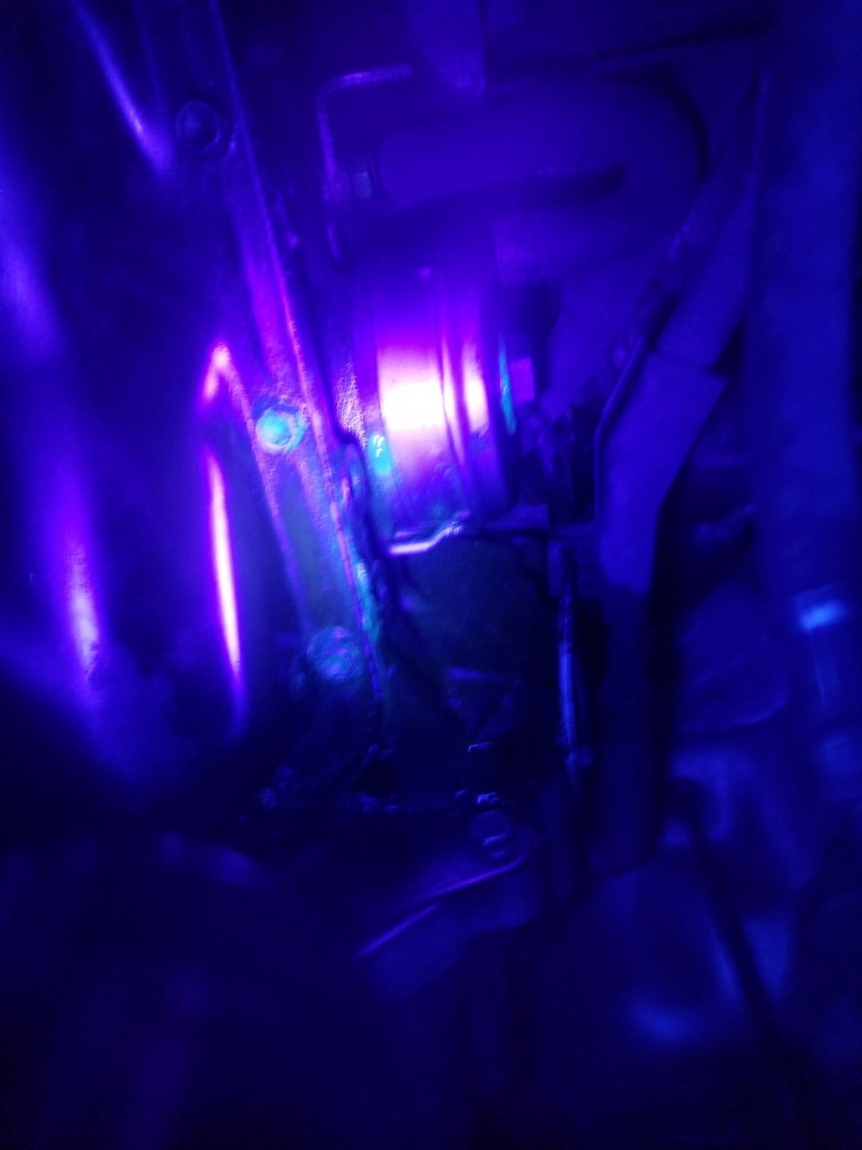

    I think I found my oil leak. Can anyone tell me what part that is??

    Your missing bolt I believe once was an alignment pin. There are no treads in the hole, kinda remember it being used to keep the metal plate in place during assembly.

    That is your oil cooler......famous for leaks.........

    Yup, definitely the oil cooler. I went to the dealer and they had 2 of the 3 parts. There are 2 gaskets and 1 crush washer for the banjo bolt that needs replacing. The diagram is outdated.
    Should all be in by tomorrow.
