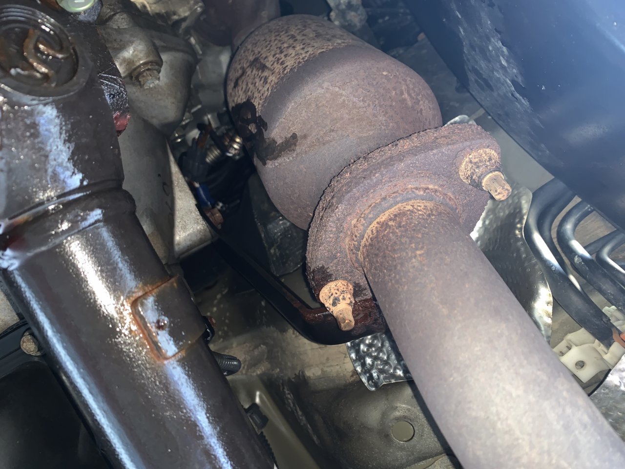

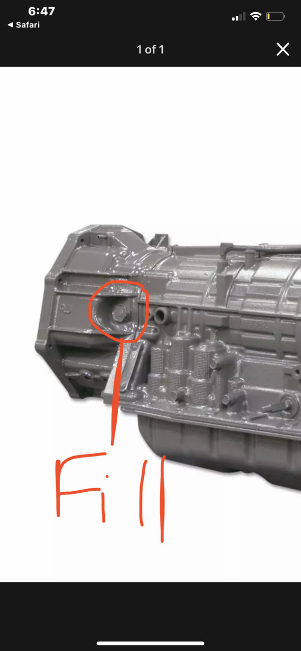

    I don’t believe they dropped it, no signs of that happening. The leak doesn’t seem to be coming from any thing obvious, drain bolts and pan gasket are dryer than other parts. It is all on the driver side, around the exhaust and driveshaft As shown in the last picture.
    No new drips after I wiped the frame down so it’s only coming out when driving. I can check later tonight for any fresh stuff to be sure.

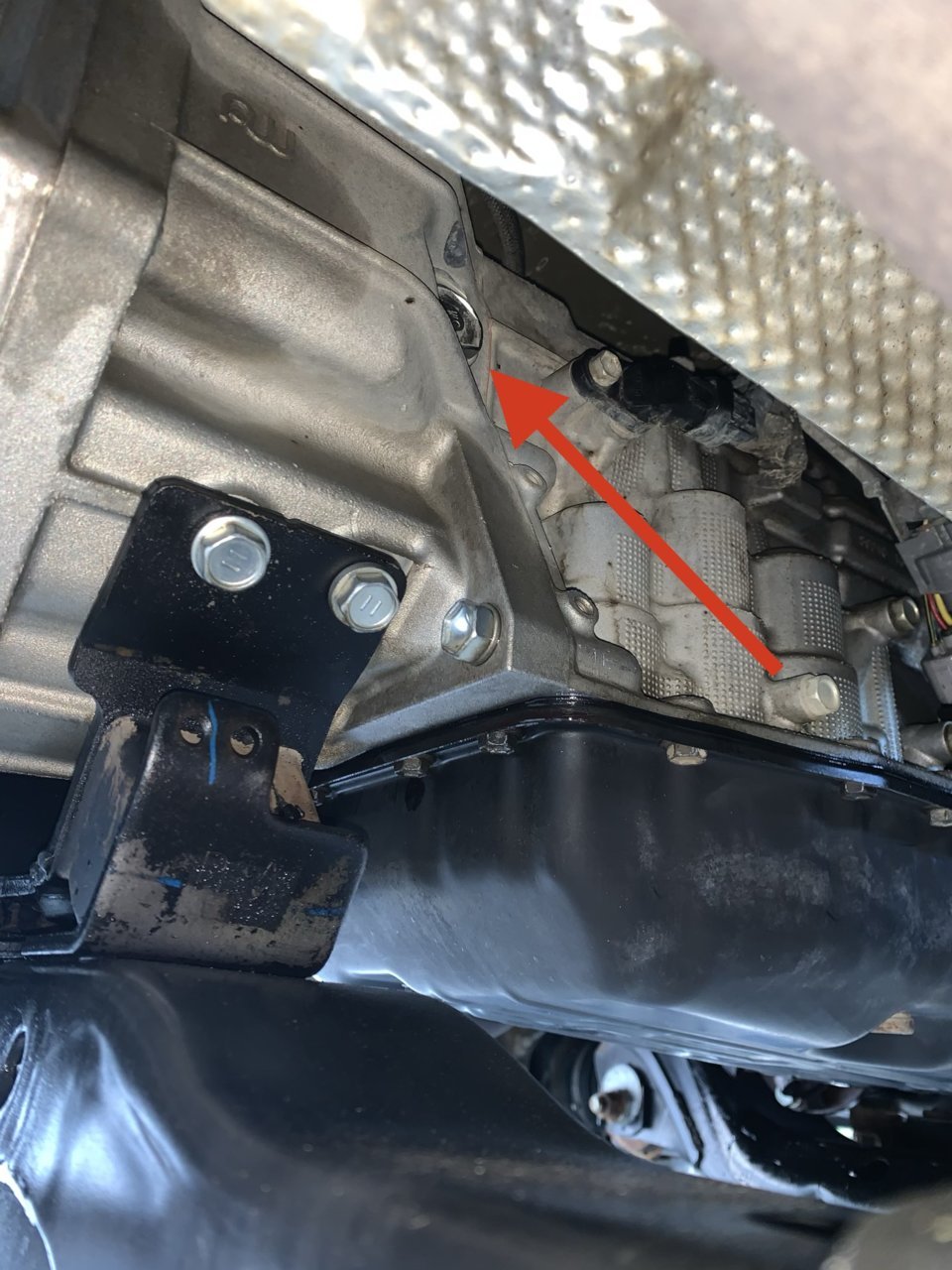

    I think I found the fill plug, it’s a big guy on the passenger side, right? I Took a picture and called it out with the arrow

    Yep

    Yes, that is the fill plug. You can also see the drain plug and check plug in you first pics and they all look good.
    Check back later and let us know what happen.

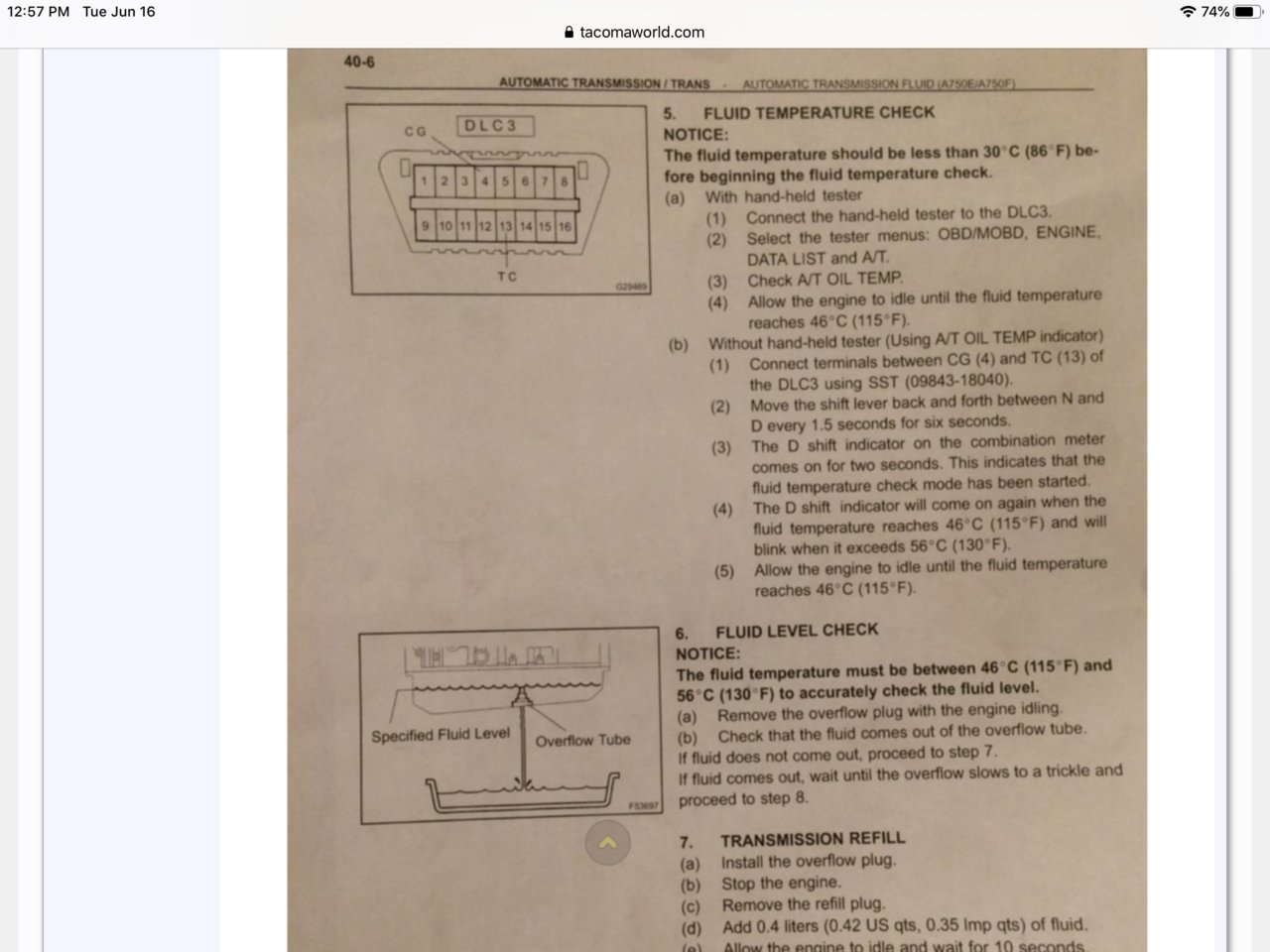

    That’s great that there being responsible, but It’s also important they actually know how to service a Toyota transmission.
    When you get it back, ask a simple question or better yet ask them to put on your receipt the temperature of the fluid when they confirmed it was at the proper level.
    There should be no hesitation on there part. Then you will know if they know.
