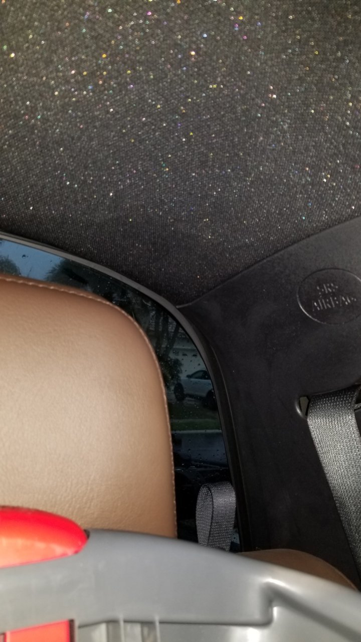

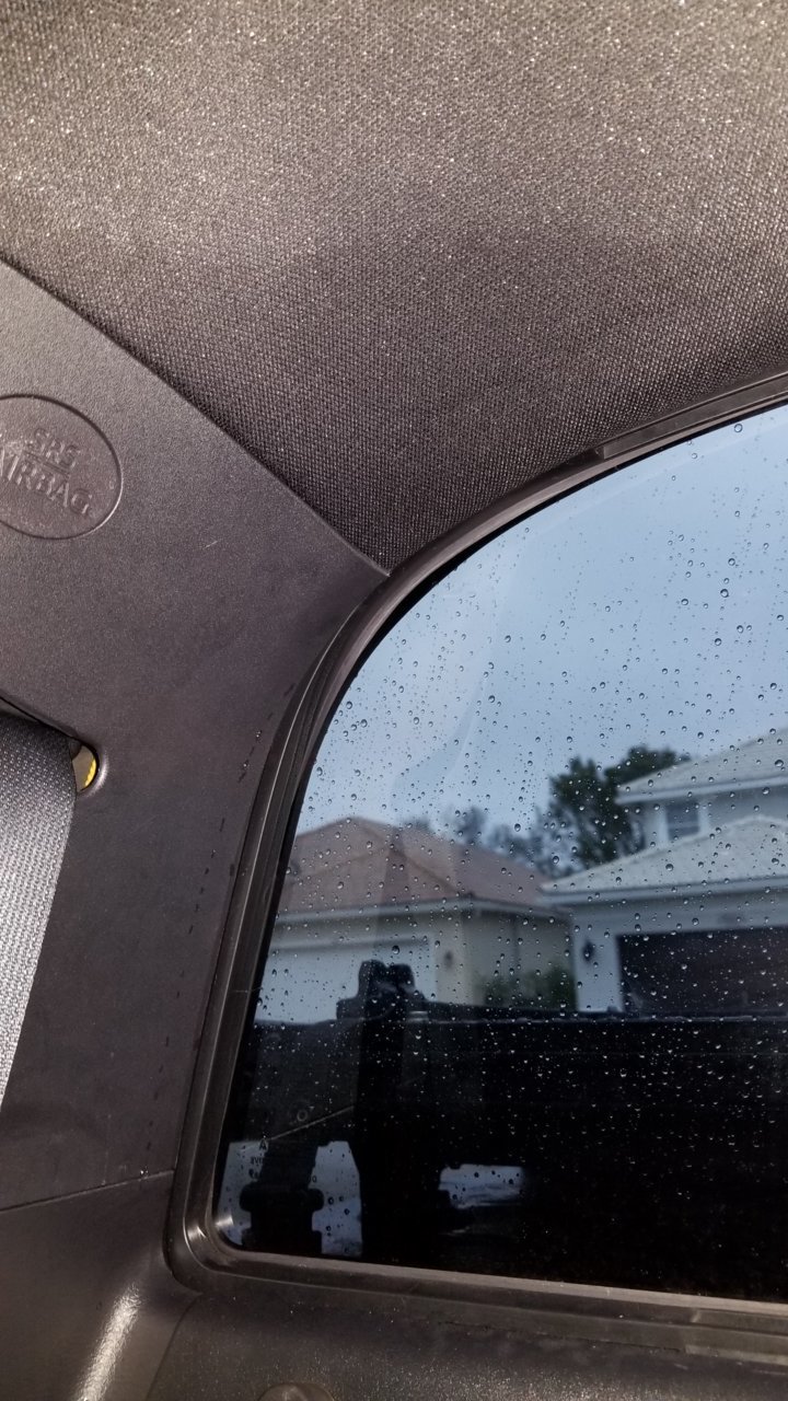

    I have a leak only in the corners of my headliner... Seems like a slow drip, but the other it came in hard, then slowed down again. Any suggestions of how to fix?

    It could be coming in through the third brake light. Here's the TSB with the fix.

    Both sides? Brake light. One side could be rack. I have installed two racks in the past and never had leak issues. Light is a known issue at Toyota.
    It’s absolutely ridiculous that Toyota won’t fix these even out of warranty. Should have extended it to a higher mileage and year. The damage can be costly and significant. All because some moron forgot to pull the backing off a light housing seal. This type of stuff is the reason I purchase Toyota due to things like this being more prevelant in other manufacturers.
    To pull that light, you have to drop the ceiling. If you are ok with sealant on the outside then that might last a few years and take minimal effort.

    100% the third brake light. Mine did the exact same thing. I haven’t had the chance to swap it out yet but bought the parts and just used electrical tape on the outside over the seams. Mines out of warranty. I was chasing the leak and thought it was the OEM roof rack so pulled that off and still leaking.

    Thanks guys... I poured water and saw it was that damn brake light.. The light is not flush with the body of the vehicle. I will try to seal it from the outside. Any suggestions on a sealer? I saw RTV sealant that I might use.
