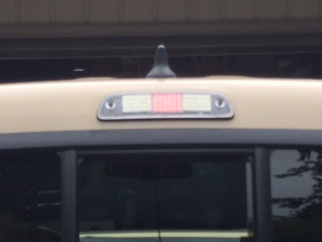

    No TBS for access cab third brake lights. They are totally different than double cab lights. Mine are not factory but this picture shows that the access cab light unscrews from the outside unlike the double cab which unscrews from inside the cab under the headliner.B3CE8888-726C-4C9F-905D-BDCE686C5A0B.jpg
