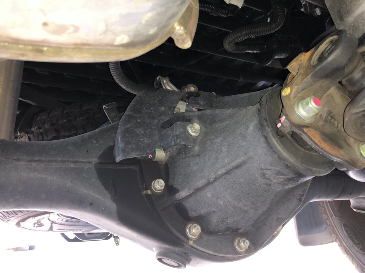

    I follow the forums, and know about the recall and numerous leaking 3rds under our, well, 3rd gens. But don't recall (search did not show anything) seeing where someone had their 3rd replaced due to the leaking diff.
    Took truck in and to notify them of the leaking diff. Four days later I get the truck back with a new 3rd, with notes on the service report:
    And...
    Pretty sure this is the first I've heard of a deformed differential being the cause? Have I missed something, or is this just possibly a case of a tech taking this thing out for a road test, engaging the locker, not knowing how to get the binded up diff unlocked?
    Rear diff lock was working just fine a month or so ago, and I've not yet in a dozen engagements / disengagements or so had any issue with it.
    My truck (2017 TRDOR) not part of the recall last I checked, and the service advisor (I thought) also said it wasn't under recall for that. Blower motor, yes....leaking diff, no.

    It’s the diff cover that has been deformed or not machined properly. A lot of owners have had the gasket replaced and bolts retorqued and it still leaked (seaped).

    That's what I'm wondering...if this is a new development where they realize it just wasn't a torque / gasket issue as previously thought, but rather poor machining / deformed issue. I know I've seen a few guys here complain that they had the work done under recall only to have the seepage return.

    When i brought my '16 in for a regular service i got a call from the dealer telling me that i would not be able to pick it up that day. There was a service bulletin instructing dealerships to inspect the rear differentials of any 3rd gen Tacomas that came in the shop for leaking or seeping and that if they found any that were then the truck was to be immediately 'grounded'!
    Sure enough they had a loaner ready for me when i arrived and the tech showed me the problem. There was a miniscule amount of seeping around 3 or 4 of the bolts and this was enough to replace the entire differential. I was told that since the lubricant was technically leaking out of the sealed unit there was theoretically a danger of the diff going dry and the gears seizing potentially causing an accident and Toyota Canada being held liable.
