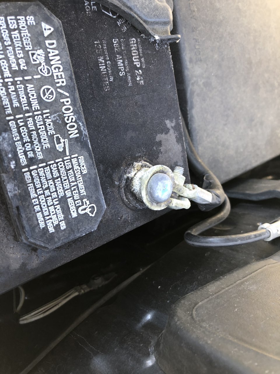

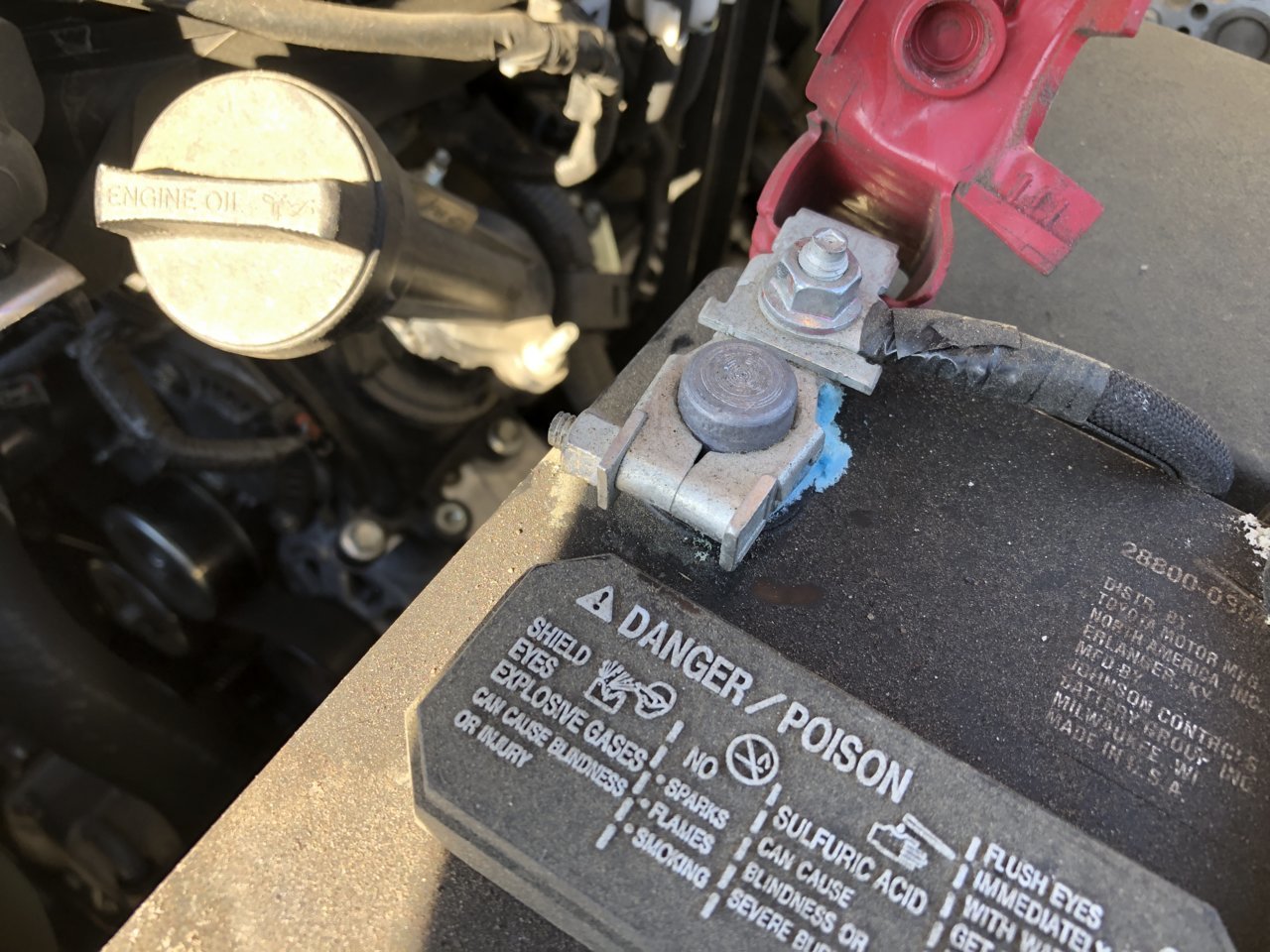

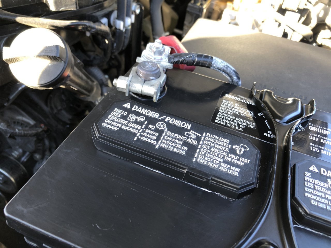

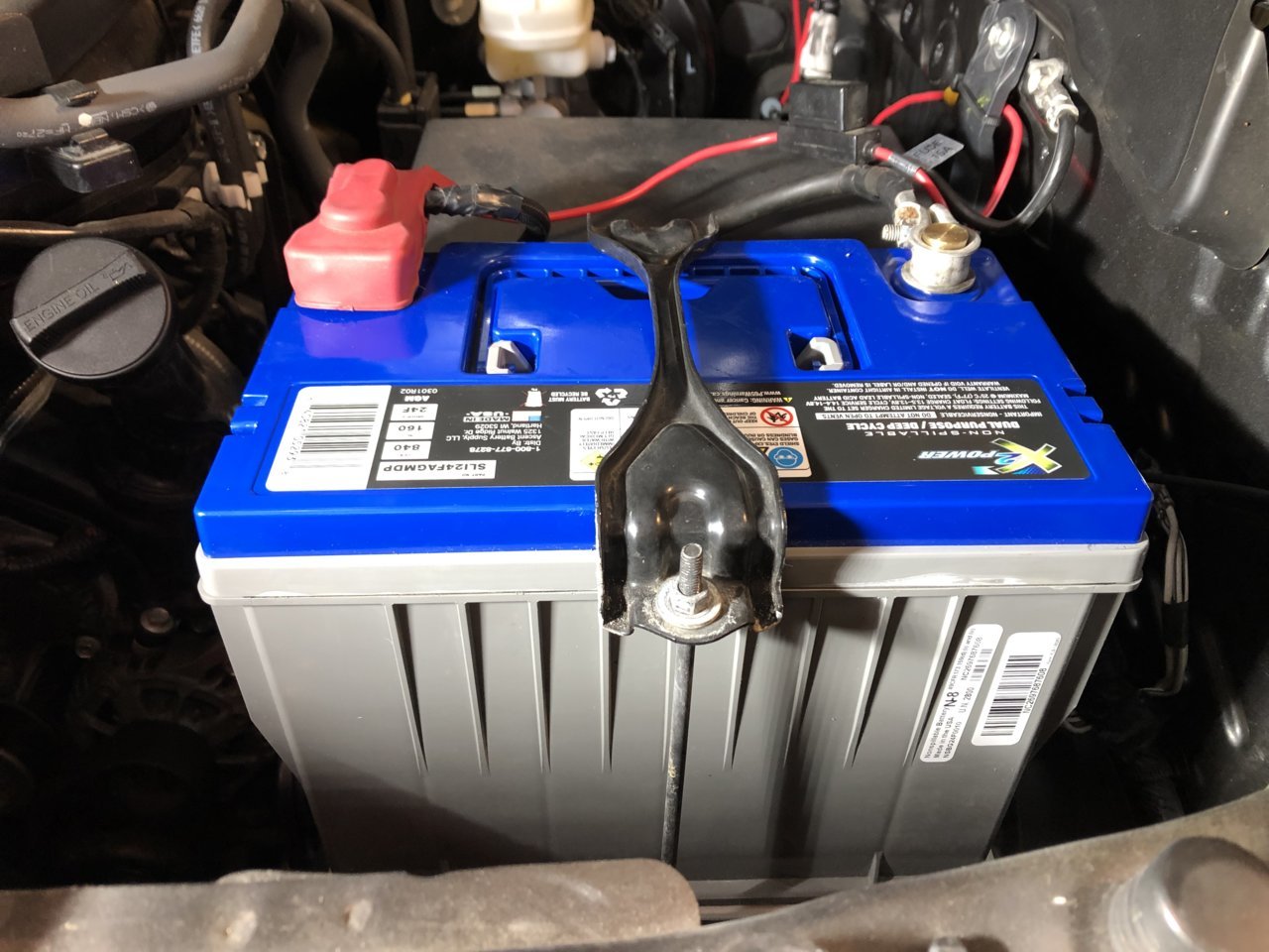

    Well I was going to replace it with a 27f and get a 2nd gen tray but once I saw how much is was going to be I decided to clean the stock battery and put the money towards other mods for now. Most likely a skid plate
    A few before and after pics:
    30966E99-2407-43FD-9AD3-F43036A545F0.jpg 17DF5883-F8A7-4C13-ACCC-3540C3F1E1CB.jpg 34B59467-B15F-47D2-9099-134AC540EAE6.jpg 729944A1-CF3F-47B9-9043-5D2A5BE65702.jpg
    Biscuits and shakerhood like this.
