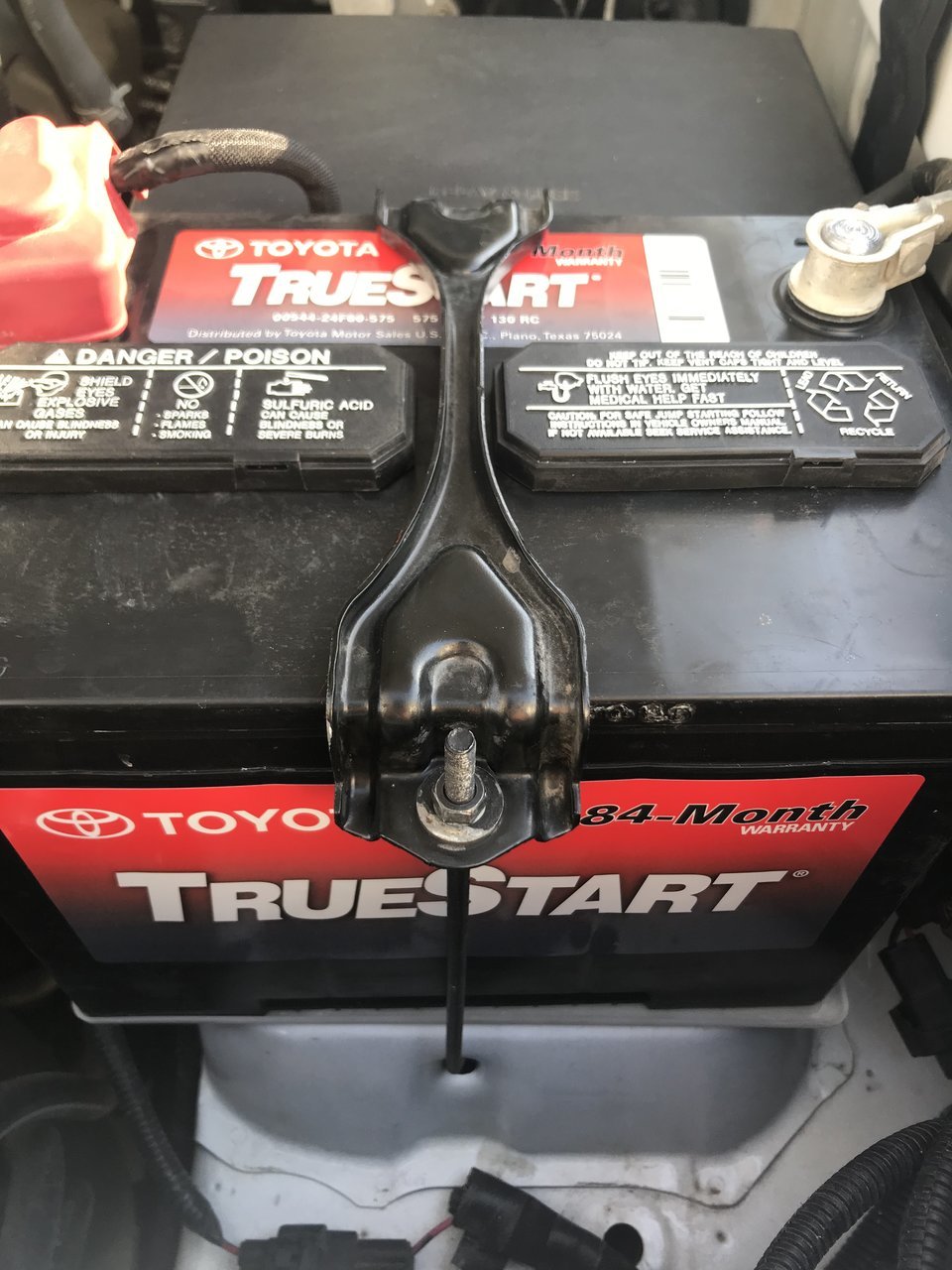

    Hi all, is this normal? 18k Miles.

    Normal, not really but batteries can and will "boil over" out the vent caps under certain conditions. As you see in the photo the acid has started to corrode the terminals and mount. You need to neutralize the acid with baking soda and water but be careful not to get that solution into the battery.

    My battery did the same,and was replace under guarantee.

    Mine also leaked (not quite as bad) at 14K and it had dropped to half its CCA. Wouldn’t start one cold morning. Dealer replaced under warranty.

    Looks like it may help to put in a plastic battery tray to hold drips.

    Had same issue in 2015 with my 2013 Highlander. AAA hot shock, than to Toyota Dealer for warranty. Dealer put in new Toyota Battery to replace defective Panasonic that came with vehicle.

    My Toyota battery had a short/dead cell and dealer replaced it. They should take care of it for you.

    Battery is covered under 3/36 I believe. We replace a lot of batteries for leaking. Usually when they leak they fail the load test.

    I bought my 2016 in December 2015, it has had a slight seeping that I was just wiping up, but today I noticed corrosion on the bracket. It was covered under warranty and they have changed batteries from factory stock. Now it is a 7 year warranty TrueStart aka Interstate I believe.

    funny. I just noticed this yesterday... Then found this thread. Dealer Thursday for 25000 service and I'll get them to check it out.

    You mean the corrocion?
    Yup seems perfectly normal on these engines.
    Not sure if its the batteries but i doubt it, i think its related to the added electronics/demand i.e. direct injection and other demands after engine shutoff.
    If you clean your terminals, you may find faster starts and smoother idle.
