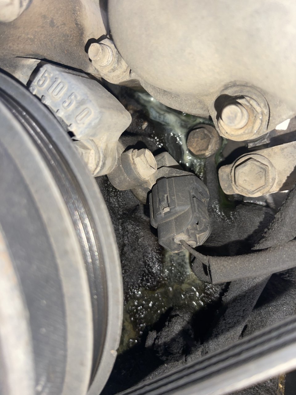

    Can anyone tell where this is likely coming from? Currently 4 hours in heading from San Diego to Sacramento. Just used Blue Devil head gasket sealer yesterday. Everything is running fine and coolant temps have been staying in 175-190 range.

    That sucks. Hard to say with given info and pic.Few things are close that it could be and that part itself carries coolant. Might want to try stop leak or pulling over letting it cool off and add more coolant/water that blue devil can make shit worse in the long run.

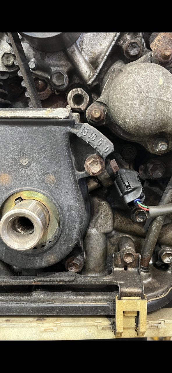

    That pic is way too close up.
    Is that the driver side, near the front? If so, your thermostat housing is right there.

    I’ll take another soon. Driver side.

    I’d say water pump. Sometimes they can leak for quite some time before it gets very bad.upload_2022-8-26_23-22-6.jpg

    If the water pump is a genuine Toyota or Aisin brand I’ve seen them last over 200,000 miles.
    i’ve seen cheaper brands only last 50,000 miles.
    It could be the water pump gasket. If that’s the case I’d replace the pump anyway since the pump has to come off to replace the gasket.

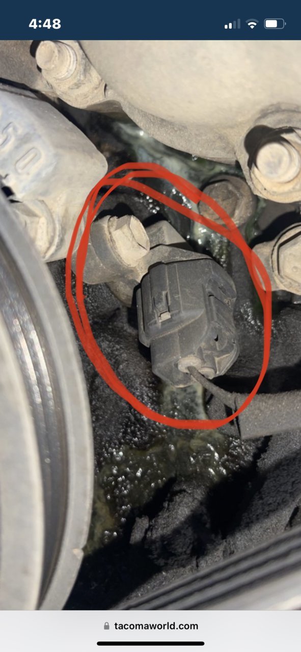

    I Doubt it. Although the crank shaft position sensor is right below your leak could be affected by the moisture.
    P0300 is a misfire code and I’ve chased this code before it’s usually fuel or Spark related. That being said a bad or shorted out crank shaft position sensor could cause this also.
    Here is your crank shaft position sensor.
    it has one bolt and an o ring.
    Moisture could have gotten to it if it’s cracked or gotten through the wire connector. Again I highly doubt that would be the cause of your p0300.
