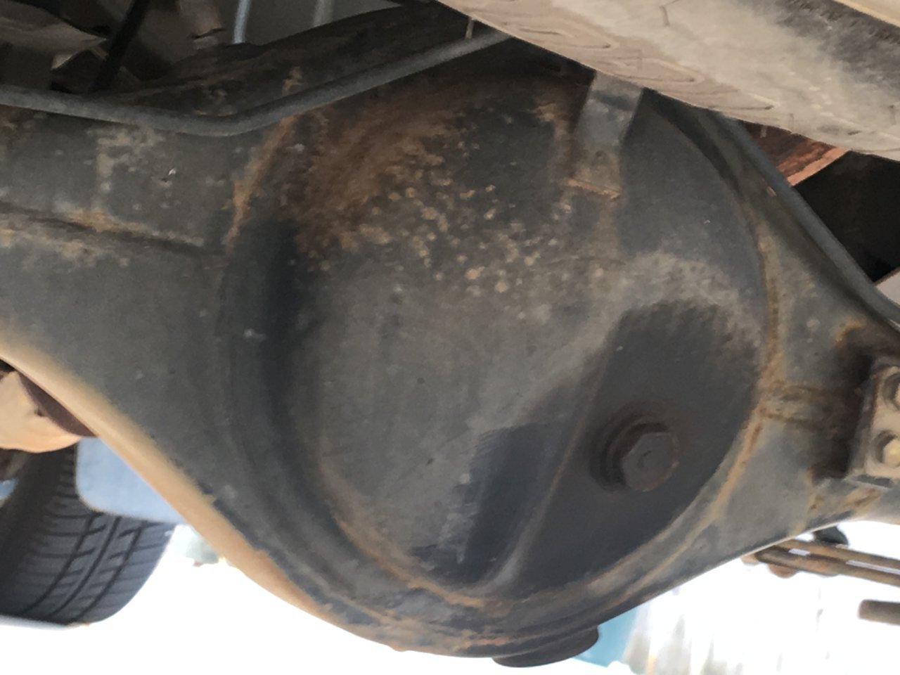

    Snapchat-1714825101.jpg any estimates on how much it could cost ?

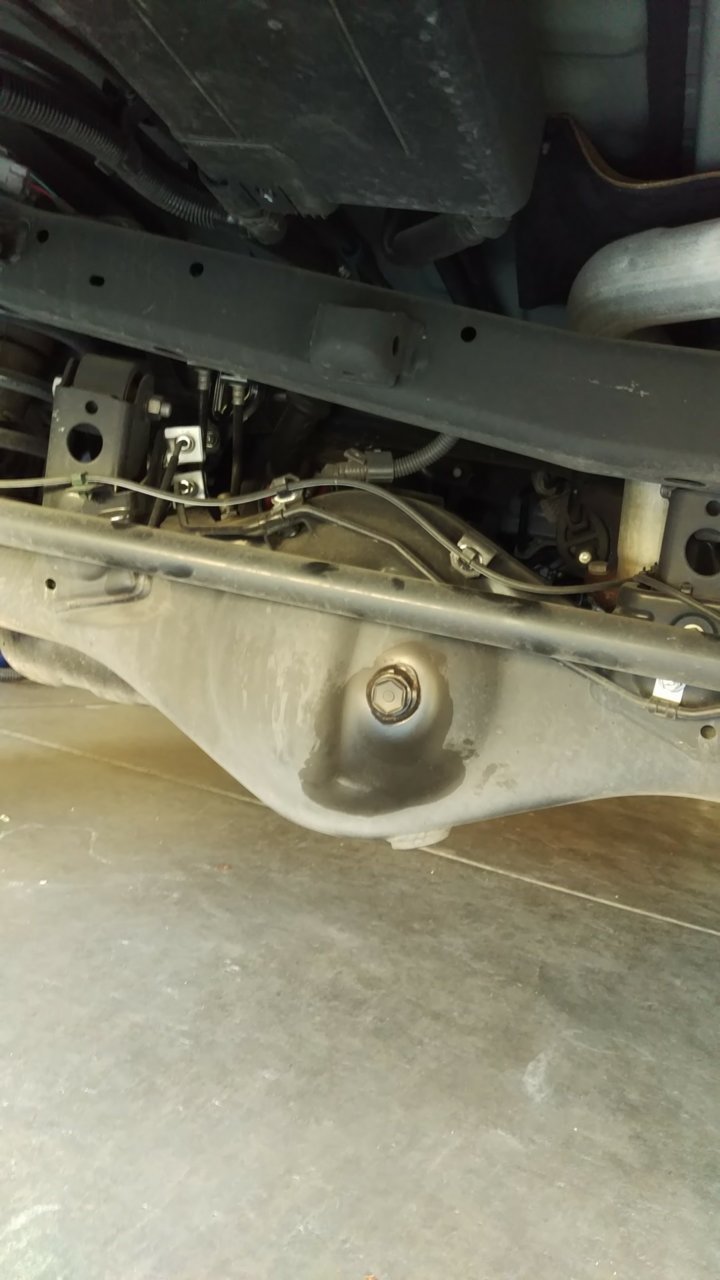

    Mine too

    Mine is the same. Always thought it was normal since I see so many others with the same

    that's a very minimal seep op. did it develop or did you have it in the shop before you noticed it? try spraying brake cleaner and wiping off the gear oil. see if it comes back. worst case from your pic is that you need a new washer.

    I’ve had crush washers last multiple oil changes, while others leaked right away. Get yourself a new washer and top up the fluid. Nothing to worry about.
    +1 on using brake cleaner to confirm whether the source of the leak has been fixed.
