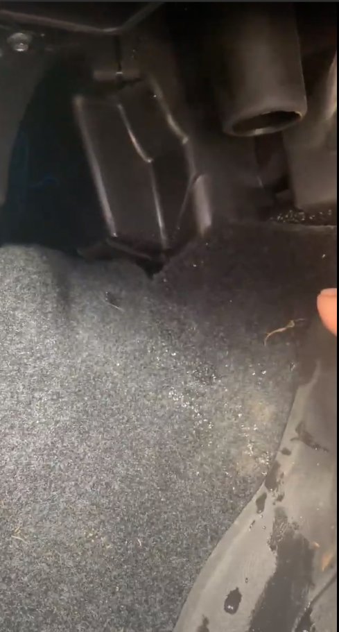

    I have not seen too much information about this issue so I thought I would share my experience.
    9/5/2020

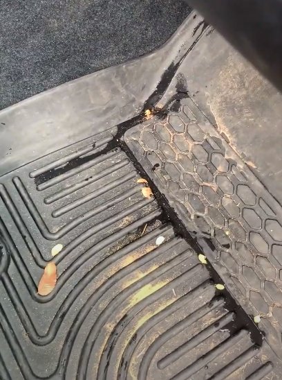

    My mom points out there is water at her feet after driving for 1.5 hours with the A/C running. It's a Sunday and the next day was Labor Day. No big deal, I'll schedule something.
    Water was essentially dripping from the plastic evaporator box, onto the carpet, and then onto my floor mat.
    Looked underneath the truck, the A/C was draining at a normal rate. Rules out a clogged drain.
    The drive back yielded some more water but not as much as this.
    9/11/2020
    Was able to schedule an appointment in the afternoon. I show up, only to be told to go kick rocks because the issue wasn't happening at that very moment. Understandable, I did not want them to drive/idle my truck for over an hour just to see.
    9/12/2020
    The next day, I drove 2+ hours and lo and behold, my passenger was almost drowning in water! Took truck straight to dealer while I had the chance.
    Initially, the lead tech wanted to tape some insulation around the evaporator box, then for me to keep driving around and monitor the area if it still leaks. I can't remember why exactly, so I won't type up false info.
    Sure, why not? It's their problem since my 2019 is still under warranty at 21,000 miles.
    Tech comes back to say they went ahead and just ordered a new evaporator box. He stuck a borescope up there and saw that it was leaking from a seam where the plastic box was molded together. Toyota Corporate just told him to stop messing with it and order a new part.

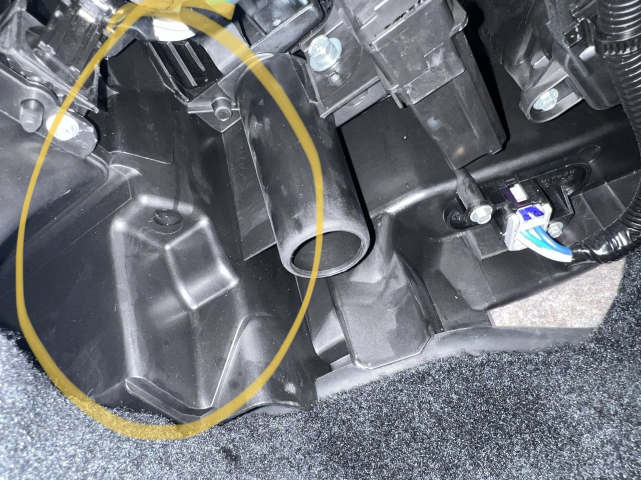

    So I have been having this same issue on my 2019 Tacoma TRD Sport! I was thinking originally it was an issue with the windshield, since I had it replaced October 2021 at Satellite and they really messed it up. They didnt seal it at all on the driver side and water flodded my cab. So I was angry and told them it was leaking again!! Come to find out, they inspected it and found no issues with their installation, and I didnt believe them! I have a leak now on my passenger side, coming from up in the dash so I am thinking what else could it possibly be other than the windshield. We checked the cowl and the cabin filter.... dry and no issues. I pulled the AC drain tube and it isnt clogged.... no issues! Finally, I am searching on google and youtube and find these threads where people are talking about this known issue with the evaporation box condensation and leaking water on the floor. Someone posted he was going after the Lemon Law and Toyota is apparently aware of the issue, but will not recall. So I will make a complaint and contact the dealer, to make sure they are aware of the issues that are on going with these 3rd gen!! I have the picture here and it appears that is exactly where yours is coming from....

    i might just seal mine up with some silicone from the outside. it's such a tiny area where it's leaking

    Not for $1200 for me, more like $10. J-B WELD for sure.

    I had to do that on my Wife's old Durango when it was passed warranty. I just hotwelded with the plastic stick stuff from harbor freight never had another issue

    took mine into the dealership today and they confirmed the leak. they sealed it up with what looks like black rtv and it has been dry so far. crossing my fingers.

    Any update on this? Just noticed a leak on my drive into work today from the exact same location as your photo. Would like to avoid the large bill from the dealer if this can be solved with a little RTV.

    the fix seemed to eliminate 95% of the leak. it will sweat a bit if it's extremely humid but that's about it.
    update: nevermind, still leaking, just in a different area...
