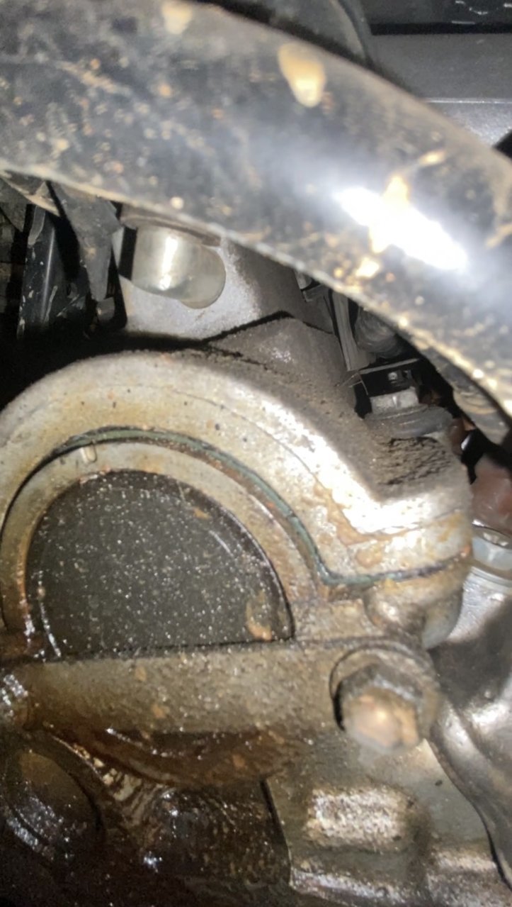

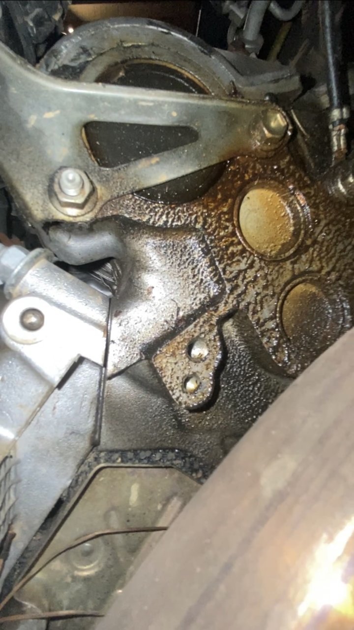

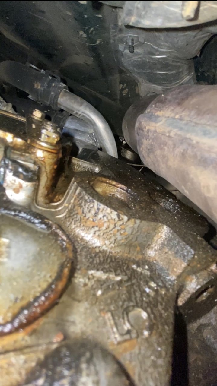

    Dark Fluid coming from back of engine near head gasket area. Has black color like oil but also hint of red like coolant. Here are pics
    2
    3
    Locations of the pictures
    I think my valve cover gasket is blown.

    Looks like valve cover gaskets and/or cam seals. I'd wipe that area clean as best you can, keep an eye on oil levels and recheck in a day or two to see if you can determine if those are indeed the source. Also a little inspection mirror (like what a dentist uses) is a very helpful tool for getting a better look at these types of things.

    Also, I wouldn't worry about head gasket at all. Looks like just a simple oil leak to me. AKA, free rustproofing lol

    That's a common point for them to leak. If you're losing enough oil or it bothers you enough replace the valve cover gaskets and reseal those cam seals in the back and half moons in the front. I had leaks with the cam seals and valve covers and looked just like yours.
