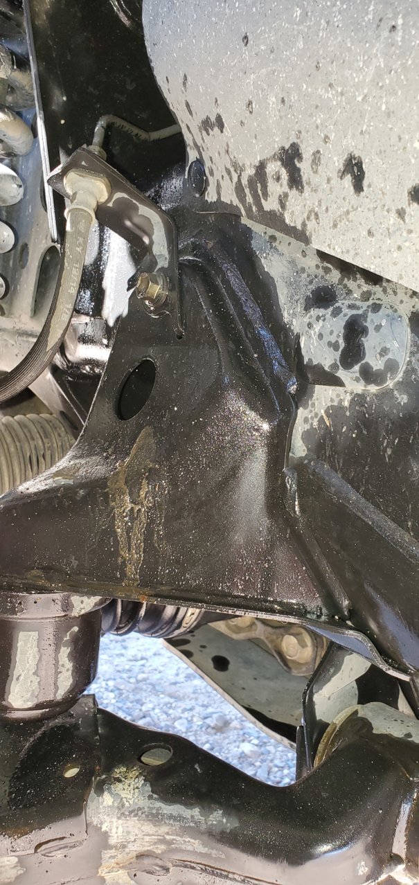

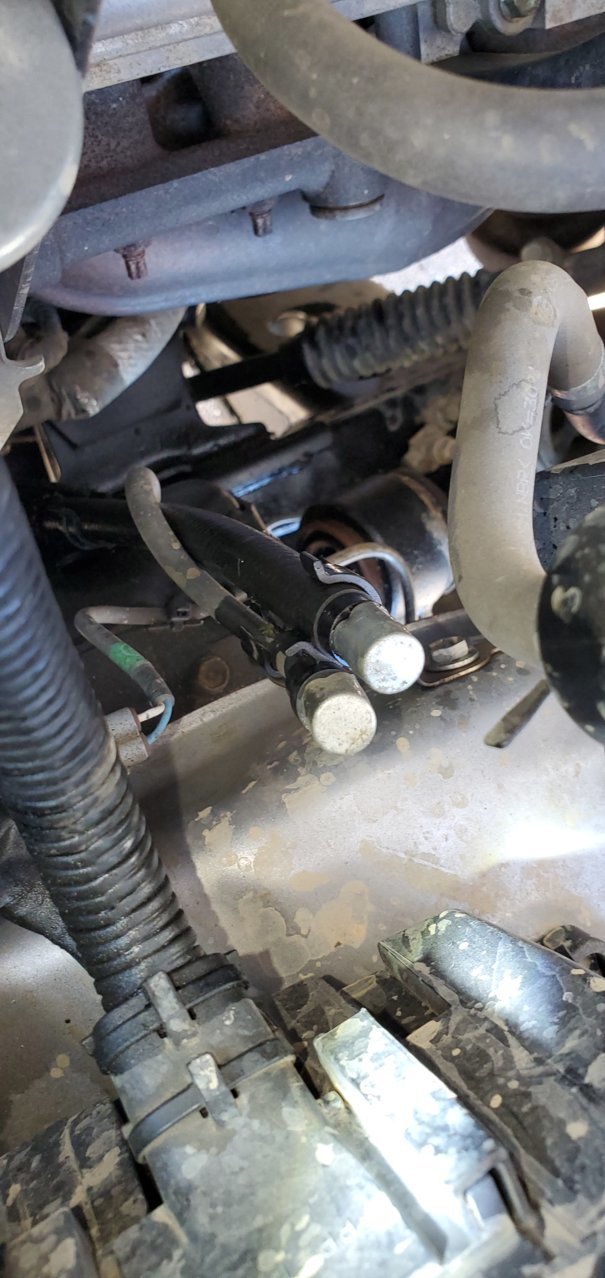

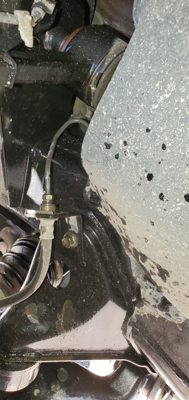

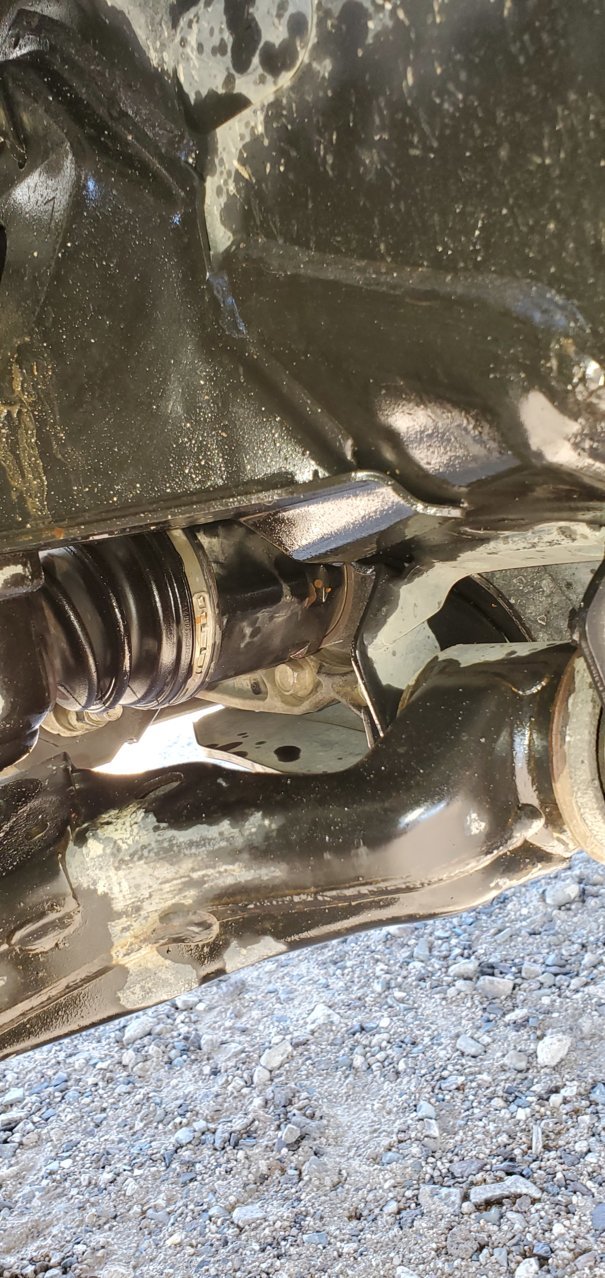

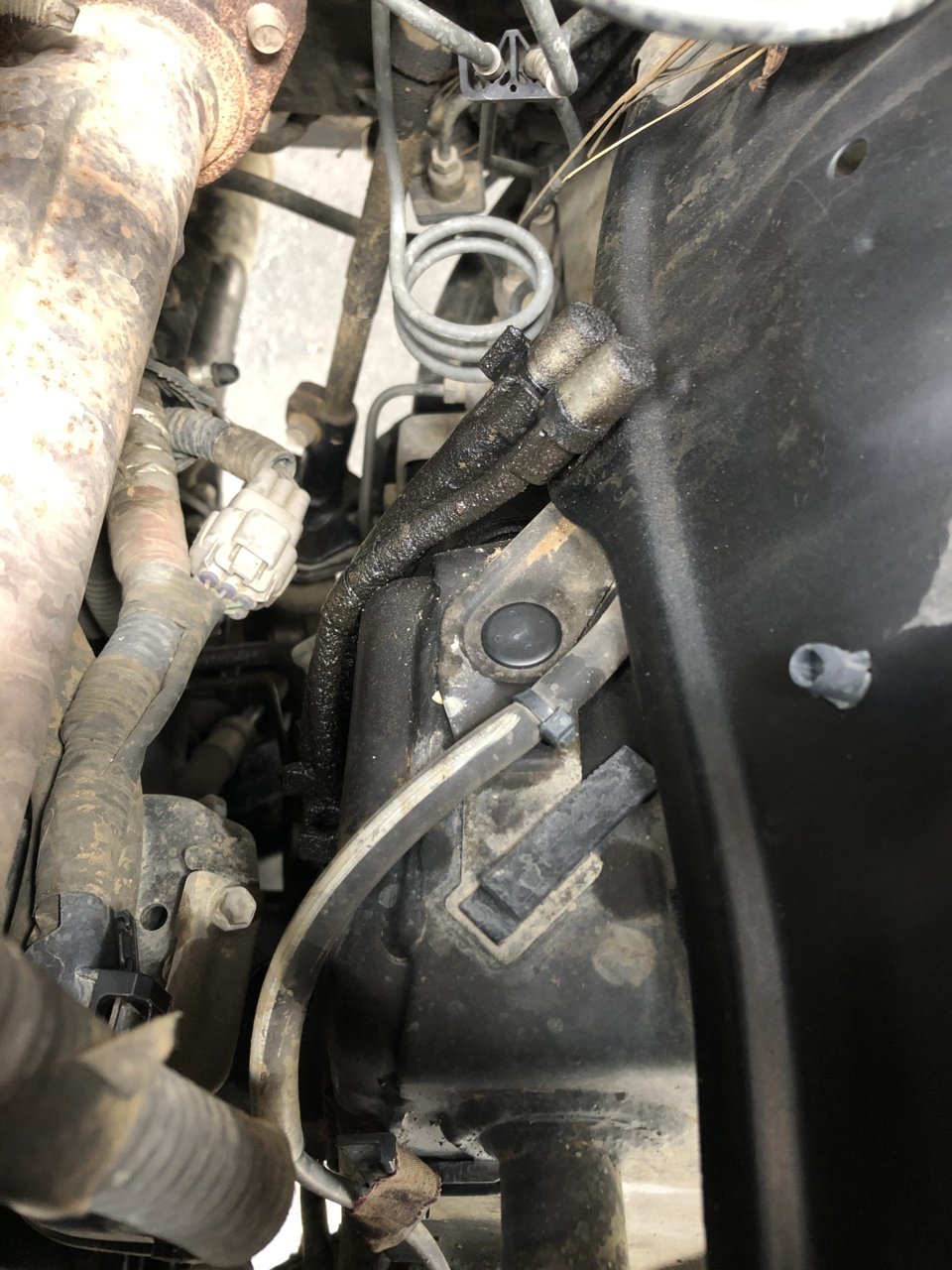

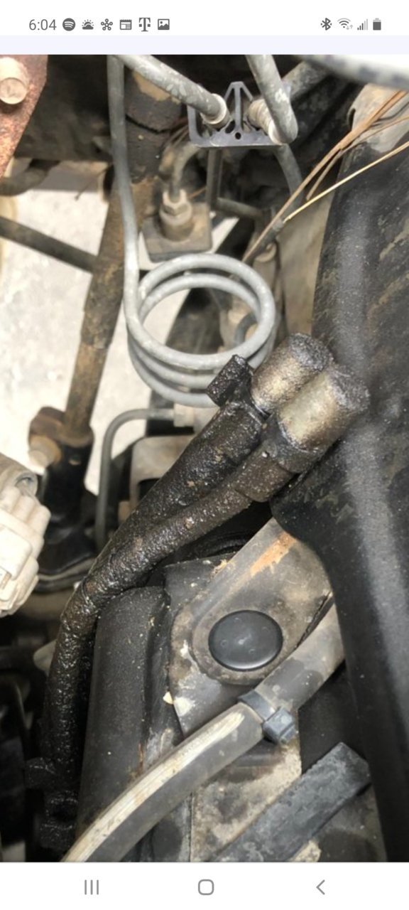

    I believe I just had the same problem in Death Valley. Oil everywhere in driver's side wheel well and the diff breather tube saturated. Called my trip short, I thought that it was more serious, I hope that this is all it is! I'm glad I found your post.
    20201229_125706.jpg 20201229_125632.jpg 20201229_125703.jpg @Unner 20201229_142819.jpg

    Looks like I'm having the same issue oil leaking out the breather valve and making a mess.
    I always thought you full the oil till it runs out the fill hole?
    I've always done that with the rear diff, transmission and tcase.
    So how much do I need to drain for the right amount to be in there?
    Also my truck 5 speed has one breather valve but I see people here with 2?
    Why do some have 2 breather valves?

    You have a part number on this filter,
    I filled mine to the edge and now it’s all getting pushed though the breather vent

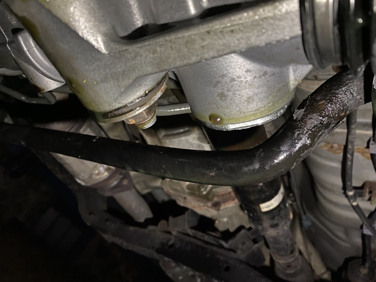

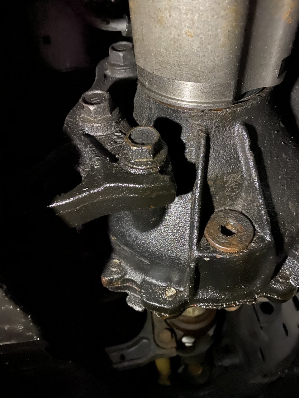

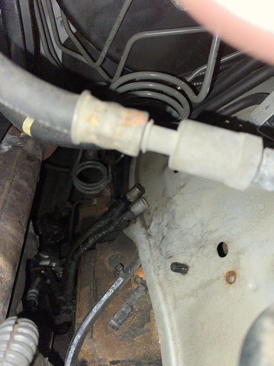

    Mine looked like this today and freaked me out. I drove for two hours and only in 2wd. Thank you guys for threads like this.
    which breather is the front diff?
    How do you remove the breather? Just pull?
    and I’m getting that fuel filter from post above. Should I install on both breathers in the wheel well or just for the front diff?

    With that much oil on the differential underneath it might be the axle seal,
    I only see some weeping on the vent breather
