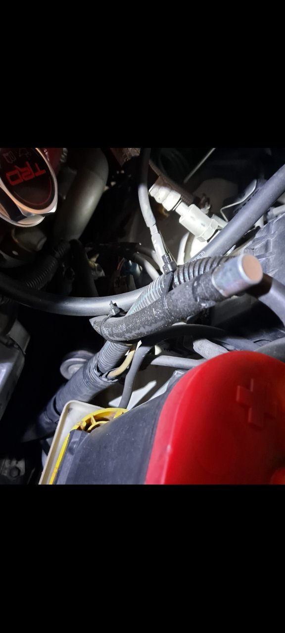

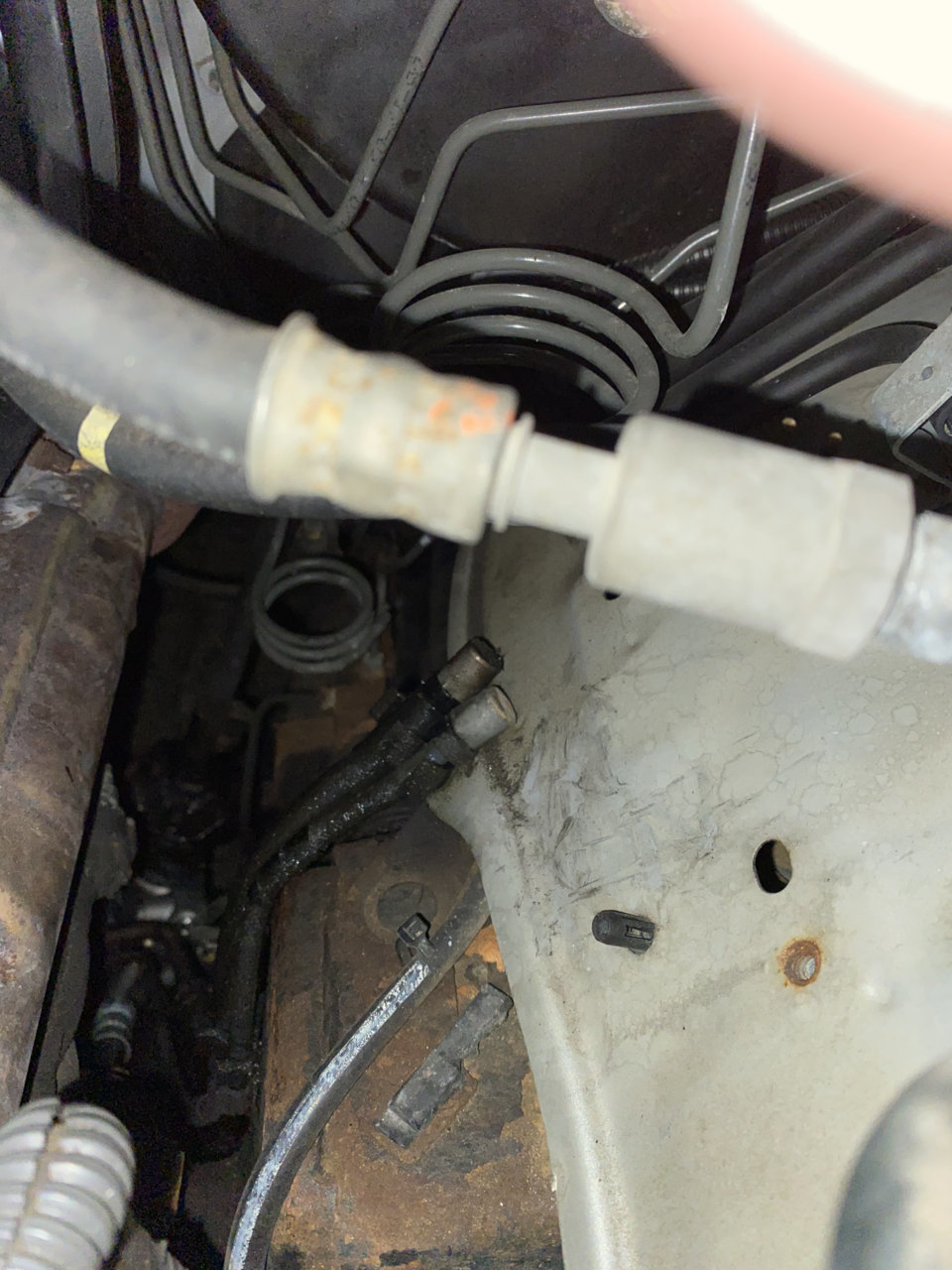

    Both axles are two months old. I have a mess up at the breathers.

    1st all take it to the car wash with a wand and clean everything,
    I had a diff axle seal put in by the dealership and it failed

    Could be the diff hose too but I see just a little weeping from the vent breather

    Does anyone know which is the front diff breather?

    Must be a bad pic because both breathers are sopping wet.
    Can anyone help with which one is the front diff breather and how to remove them?

    Do both of them, they are like 5.00 each and just pull off

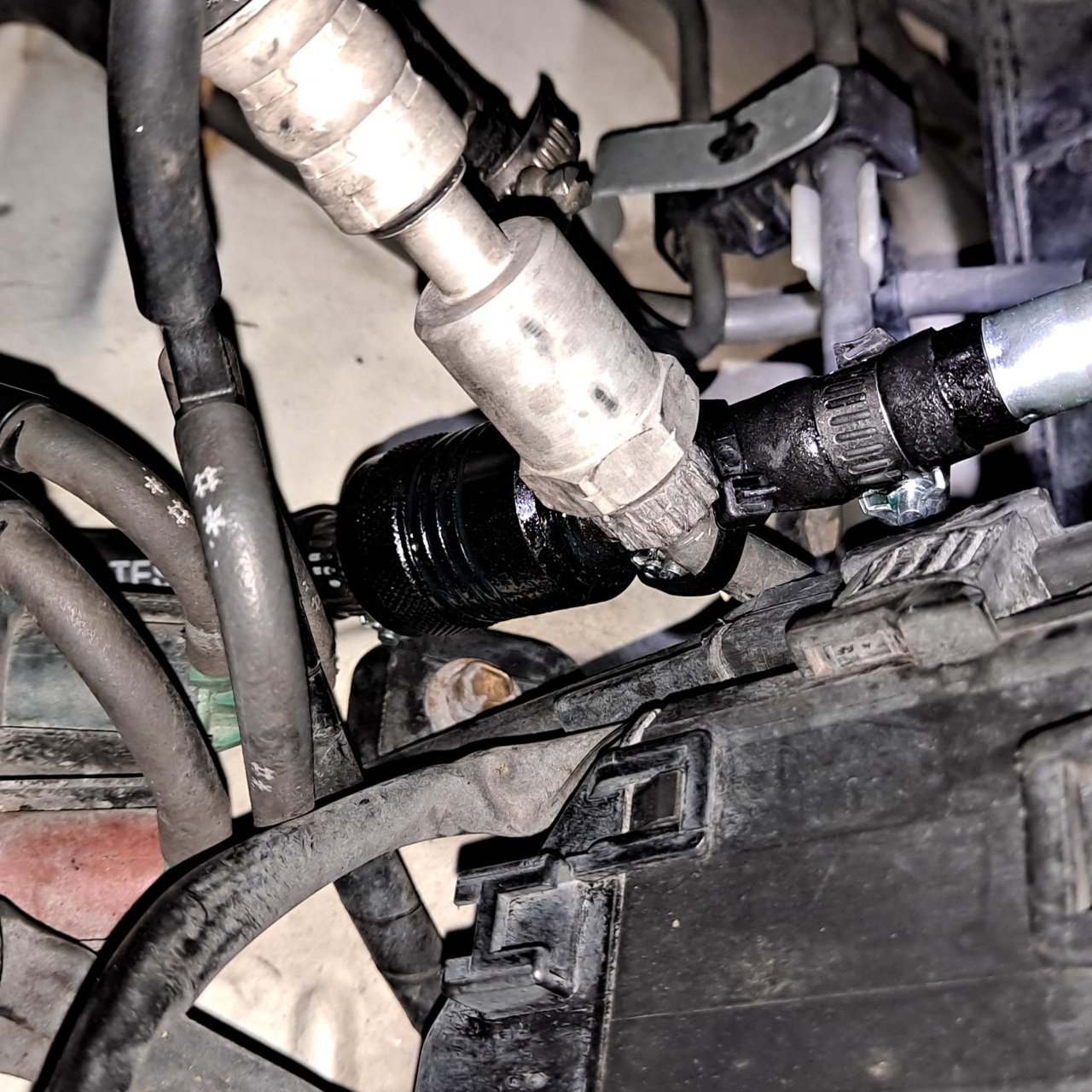

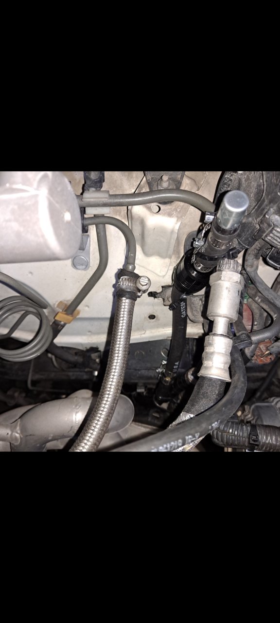

    Put in a new breather and brake cleaned the mess. Drove today and no more spewing. The old breather was gunked up and the hose was soaking wet.

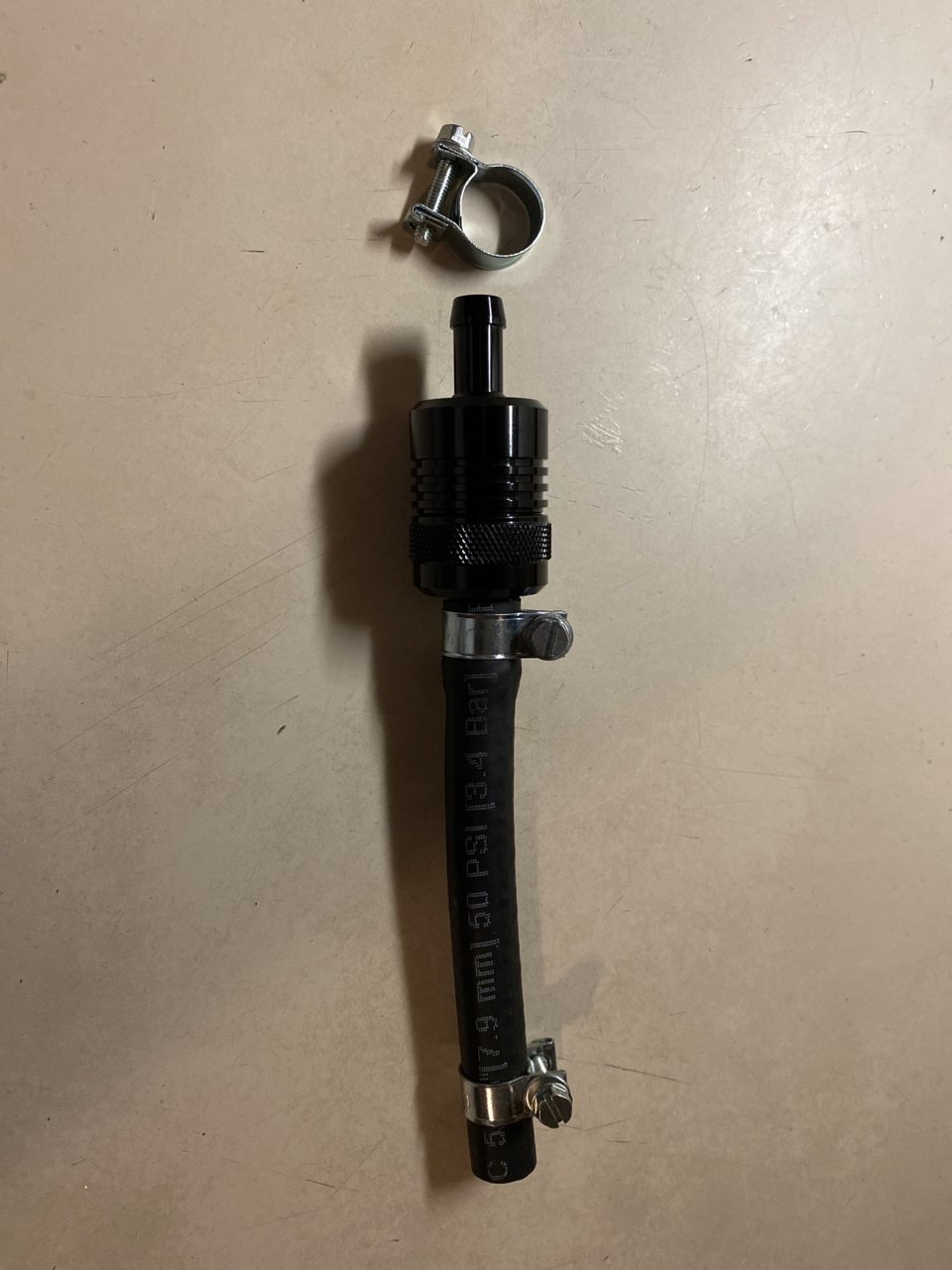

    Tomorrow I’m installing an in-line filter with the guts removed.

    This is going on in the morning. A little wd40 helped get the fuel filter into the hose.

    Would you happen to have a link to the filter? THANKS

    I am answering my own question...I forgot that @turbodb had kindly given us the details regarding the fuel filters as well as the links. See post #37.

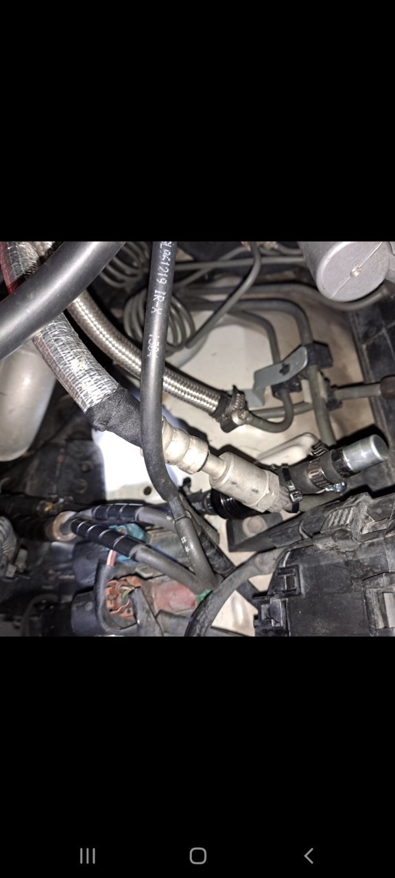

    Ok I raised the breather 6" and it still leaking so added the filter now

    Now I'm frustrated, added 6" hose and the filter and its STILL leaking,
    Guess I'm going to have to do some draining a little at a time till it stops coming out
