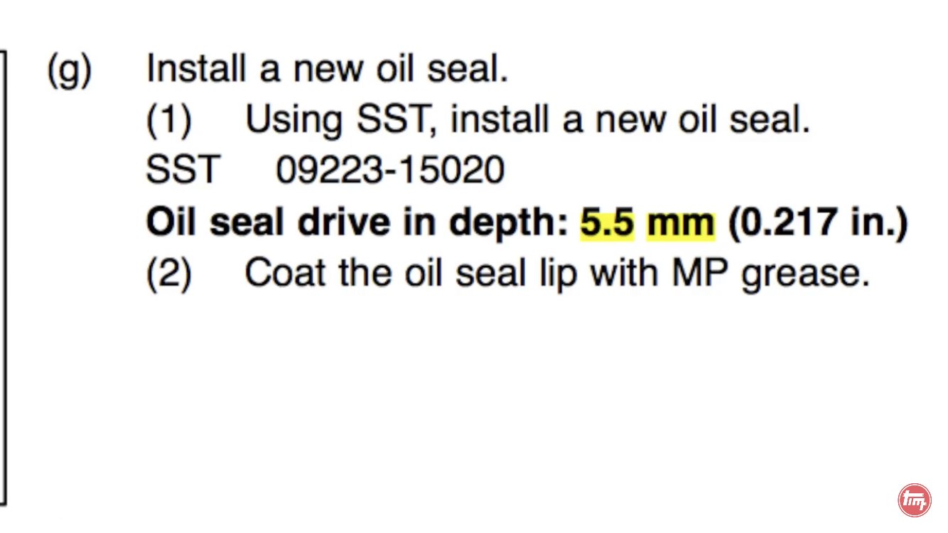

    Driver side seal will stop at a lip in the diff (it will be difficult for it to go further in, unless you broke it. Also check if you damaged the sealing surface. Sometimes the seal pullers can scratch the surface, and then the seal wont do its job)
    Passenger side you need to measure it to 5.5mm (lip of diff to edge of seal, all the way around)
    ghardy[QUOTED][OP] likes this.
