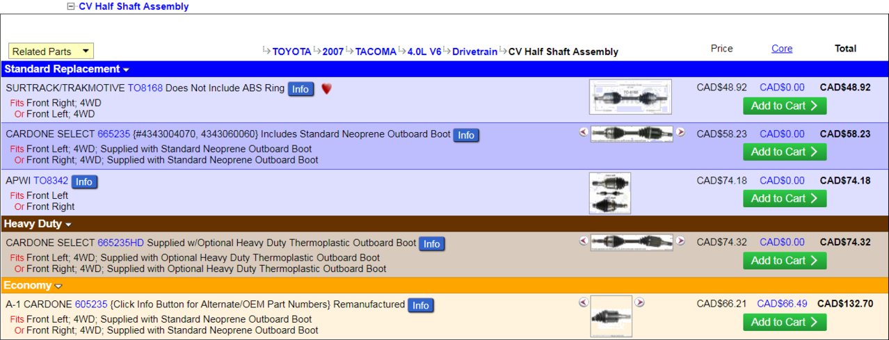

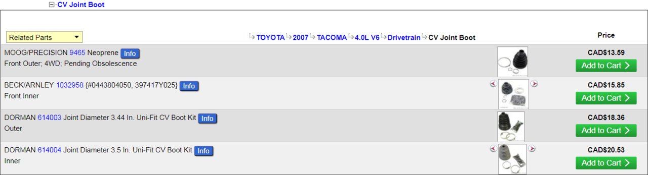

    What parts should I be replacing? Should I simply replace the CV Joint Boot or should I replace the whole shaft assembly?

    Should just be able to replace the boot.

    Whole shaft

    It all depends.
    CVs go bad when they get dirt in there. They get dirt when the boot tears and it starts flinging grease.
    If you just tore it and stop driving it? Sure. You can get away with replacing just the boot.
    If you’ve been flinging grease for awhile and it’s clicking? Rebuild time.

    I would personally buy a brand new OEM CV, rebuild the one you have and keep it for a spare.

    Any decent reman axle would be fine. I put reman axles on customers cars all the time and it's not like I have a problem with every single one.
    O'Reilly's has a nicer quality line called Import Direct. I put one in a 05 4Runner yesterday and it looked like a pretty good product, it fit good and had nice-looking band clamps. It was also a brand new axle not a reman
