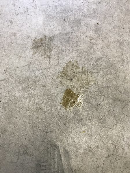

    Found a puddle on clean garage floor.

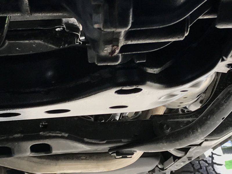

    Hard to see, but there is oil on the crossmember.

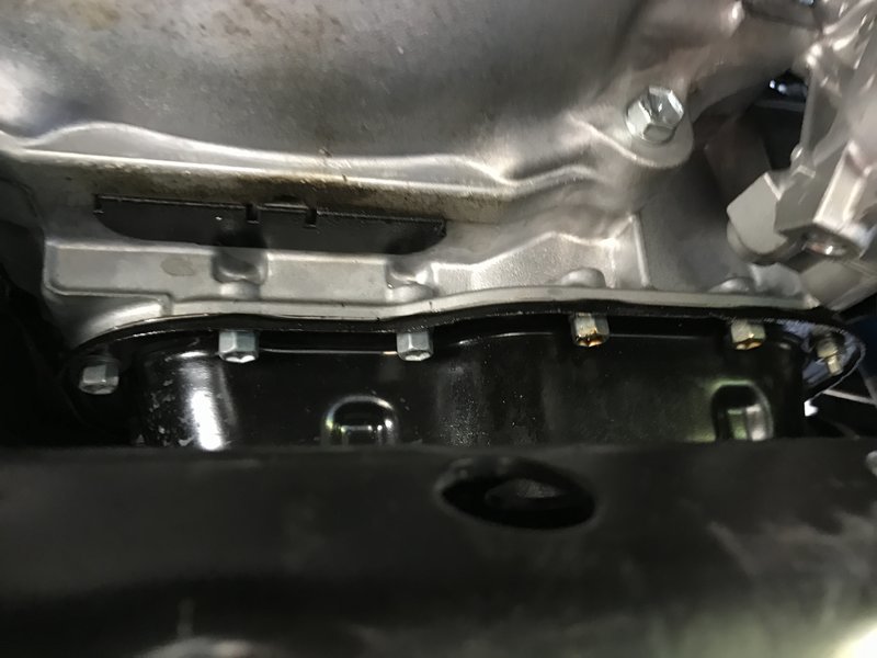

    Oil on two pan bolts and around inspection plate.

    What is the oil change interval on a 3rd gen? How low does the oil look on the dipstick?

    Hopefully just a sloppy oil fill at the dealer. Good luck.

    Check valve covers to see if there's oil coming from the camshaft position sensors.

    To add to this, check the valve cover on the rear passenger side. That's where mine leaks.

    You guys are sharp. Dealer said they found oil on engine block. They are keeping it overnight to dye the oil and run the motor to see where it's coming from. Now I drive a Corrolla :(

    Mine did it at 300 miles on my 2017 and it was the passenger side cam post sensor , I have 600 now keep your fingers crossed, there was nothing like sitting at a red light and tons of smoke rolling out from the passengers side front wheel Well

    It's really easy to identify if it's the cam sensors. Just pop the hood and look on either side of the valve cover for a sensor that looks like this. Is there oil on it? If so, source identified. There are a few folks experiencing a leak and Toyota is aware of it and has issued steps to the dealers to fix it. Before you have them tear it all apart, I would gently suggest they look for this.

    Yep that's were mine was leaking from exactly, they fixed it and it's been dry , hopefully it stays that was , the dealer said the factory sealant and thread lock failed

    It's actually the cam cap that the bolt threads into that had a defect and the oil wicks up the threads, according to what I've read Toyota is telling their techs, and having them order new cam caps. Sounds like they patched up yours with thread Sealant, but hopefully it lasts.
